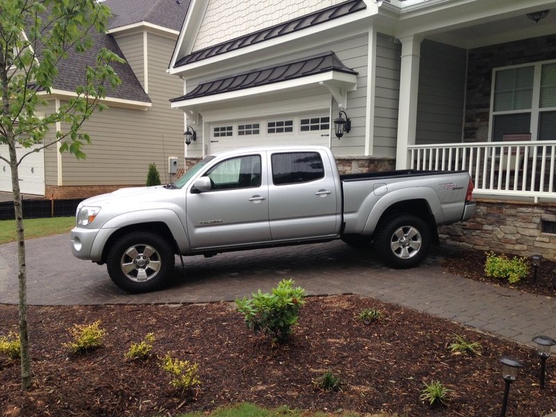

    First - I will preface this with the fact that I am a new Taco owner and member of Tacoma World. I bought a '06 4x4 Crew Cab Long Bed TRD SR5 with 110k miles at the end of April. I have attached a picture. I am taking her tomorrow to have the front windows tinted, 4 inch nerf bars added, and in-channel window visors installed. It is currently sitting on 265/70R17 tires. If the tire size calculator I used is correct they are roughly 32 inch. They are still fairly fresh so I don't anticipate changing them for a bit but when I do I want to clear a bigger tire. My question for this thread (and believe me I have googled this fountain dry) is what are my least expensive but best options? I do not want to go too big, I was thinking <3 inch. I have been reading that I can do a leveling kit to bring the front end level with the back end but leveling kits aren't that great. I have also read (and am probably most interested in this) about Bilstein 5100 shock absorbers that are adjustable to bring the truck level. My follow up to this route would be - how easy is install for just the front shocks for someone who is good at oil changes but that's about it? - how much of a visual difference do these make on the truck? - I have read that setting them to 1.75 would level the truck, how much bigger of a tire can I clear with such a setting? - Would anyone happen to have a similar set up that could shoot me a pic so I can see? Again, I have googled the mess out of it but I can't really tell if I am looking at a truck truly sitting on what I am talking about or if it has a full lift or some other kind of suspension mods.taco.jpg

    Here's what I did for about 2" all around:
    Front: Bilstein 5100s set at 0" w/ OME 884 coils. I had Wheeler's assemble these so I didn't have to deal with a spring compressor.
    Rear: Bilstein 5100s w/ General HD Leaf Packs
    I don't like AALs unless you're adding them to brand new leaf packs. You could also go with Wheeler's HD packs to get a similar lift in the rear.
    It looks like this--though the photo is a few months old and I think the rear has settled a touch more so it looks closer to level now:
    I'd have to add it up again, but it's in the $1000 ballpark to do that.
    It rides great! Handles a load much better too.

    so....
    What you are saying (and from reading that other thread) is that it is not as simple as just adding the Billies in the front to get an extra couple of inch tire clearance?

    I'm of the opinion that if you're going to do it, you should do it right the first time and not take shortcuts.
    5100s are good shocks, but I wouldn't preload them with factory coils--I'd use them with coils that will do the lifting on their own and leave them set at 0. It'll ride better that way.
    In the back, I wouldn't do an AAL on leaf springs that are pushing 10 years old (or even 3-4 years old like mine were). Replace the entire things. Then swap the rear shocks too because they're cheap, easy, and everything is new.
    Regarding tire size, I'm not sure what you could fit with a lift similar to what I have. I'm still running 265/65 R17s until I burn through the tires that came on my truck. Next year, I was just going to do 265/70.
