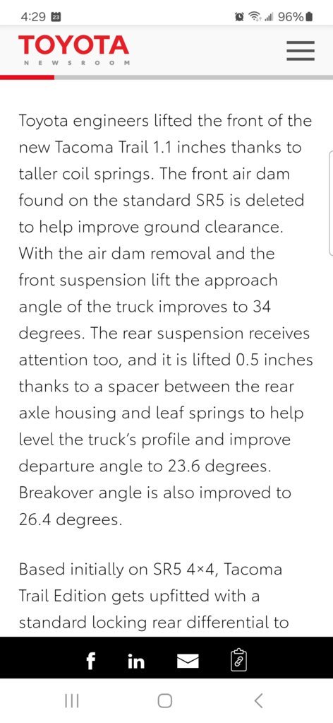

    From Toyota press release back in 2021 for 2022- longer front coil springs and rear 1/2" block under the leafs.

    Interesting.... Longer springs, but same size shocks???? That's a weird one.
    If that's the case, I would do 5100's set @ 2" up front and replace that 1/2 rear block with a 1" block.
    If, that's the case.......

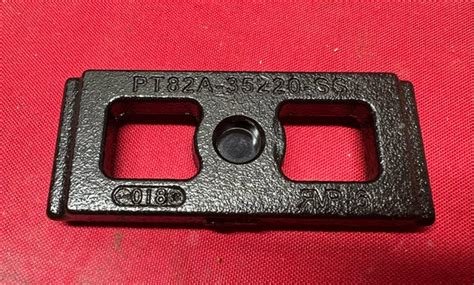

    Easier than that if he only wants to raise the rear, just replace the drop in block with taller one. I have the 1/2" Toyota block #PT82A-35220-SS. I bet it is the same.

    That is indeed the Trail Edition block; just put a pair in my '12.

    Taller lift block or add a leaf are the options to lift the rear without replacing the entire spring pack.
