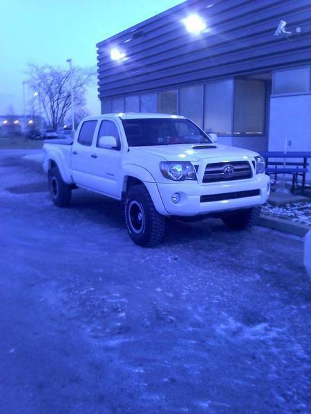

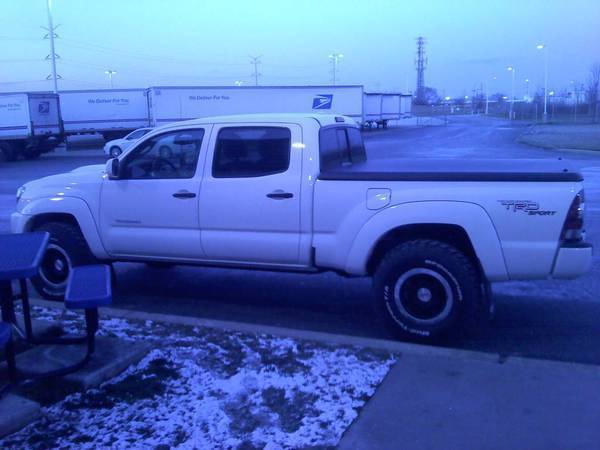

    Ok just got mine done. 1.75 and rear tsb and seems perfectly level to me. However I can tell the drivers side does sit the 1/4" lower, I think now I should have got the 1/4 spacer. May try to get one and install it later. :notsure: I just didn't think it would be noticeable.
