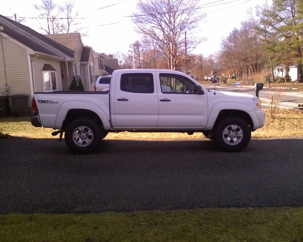

    I have eibach springs (1.6 inches of lift) on my stock billys and my truck has a slight rack. I have the tsb springs in the back also.
