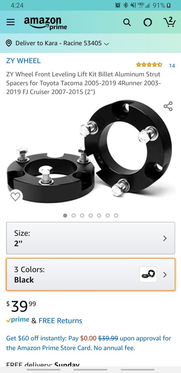

    What are your thoughts on these. They are cheap and all i want them to do is level out the truck. Im not interested in a full suspension lift. Just wanna level it. Screenshot_20200515-162456_Amazon Shopping.jpg

    you will not be interested in what we have to say. spacers and blocks are not recommended.

    They’d prob suit your needs just fine if u don’t do any serious off roading but the on road ride will be more harsh.

    If those spacers are 2" thick they will lift your truck closer to 4". But they look like they might be 1" which should net you roughly 2". That will make your nose high instead of leveling out.

    Over on Wheelers OffRoad they have 1/4, 3/8, and 1/2” spacers. You’ll want driver-side to be an eighth or quarter inch thicker to compensate for the Taco lean. These smaller spacers will slide right in without having to get longer bolts.

    what he said- you get about twice the height of the spacer in lift- 1" spacer gives you two inches. see my link below for the spacer lift I did. Its fine for leveling but I would say if your mileage is over 50K I would just move onto the 5100 series shocks and lift that way because you are about due for shock replacement anyway

    I have a spacer in the front of my truck right now. There coming out next week and I’m going to put in some 5100’s to bring the front up. I can’t stand the terrible ride any more.
