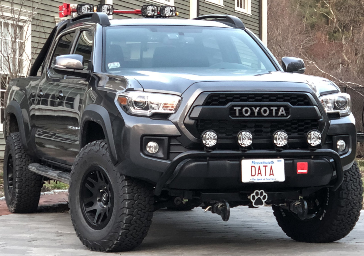

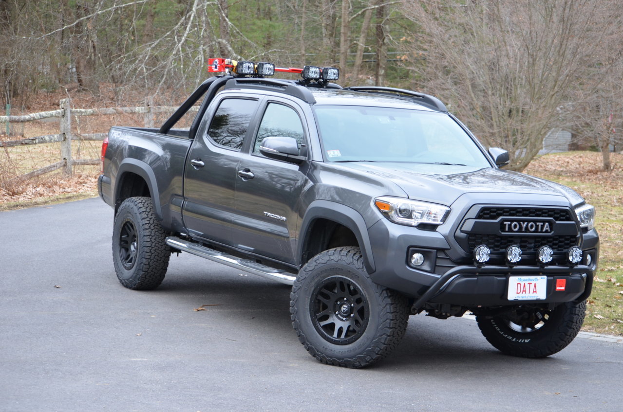

    Cudgel
    Cudgel “Tonka”
    Mar 28, 2017
    #214640
    4,296
    Live in: An Ocean of Plastic Trash
    2017 OR DCLB
    ICON8 Lift -285s. upTOPoverland rack.
    Lifted:
    Level:
    Matmo215, Dank24 and JayRolla like this.

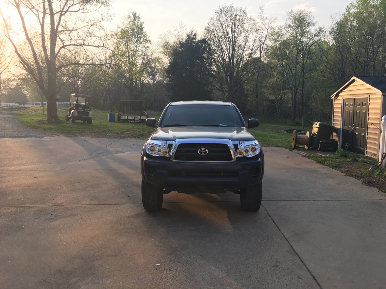

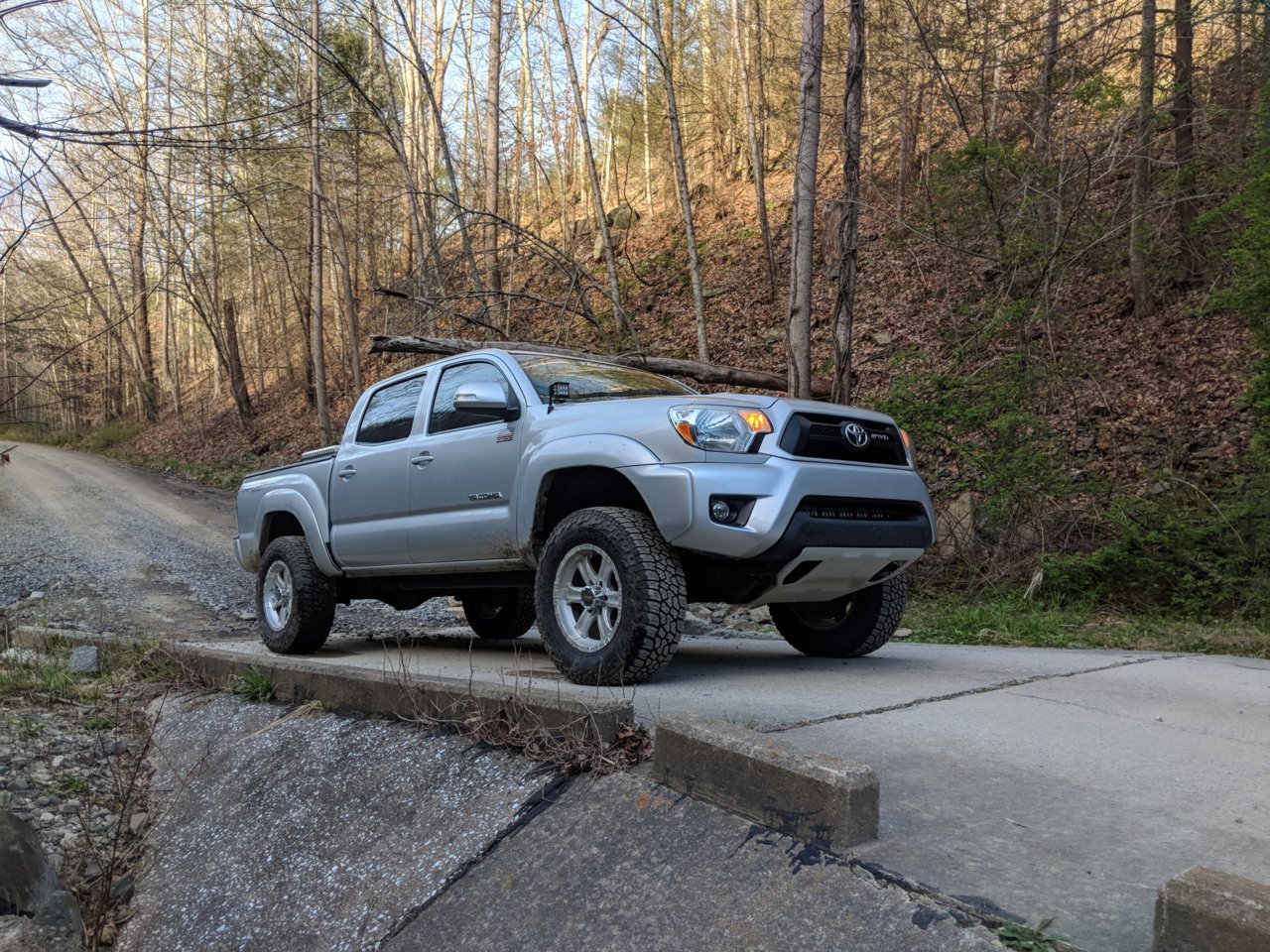

    Okay so here's my story:
    I wanted my truck to have a more aggressive look; however, im 16 and on a budget so I went with a leveling kit. 3in. in the front 2in. in the rear. Hate the look of it right now because I only have the front installed, but I'm hoping it will look better after I install the back.
    Two main issues:
    - the tires are extremely close to the UCA's (I can barely stick my finger between there)
    - and the alignment is horrible (I will get the truck aligned after full installation plus new tires)
    A bad picture that doesn't show what im trying to explain, but my wheels are curved inward under the truck. The top of the tire is out to the side of the truck further than the bottom.
    Here is from the side:
    So really I'm just looking for tips that anyone can give me.
    And also with the tire so close to the UCA's if they straighten/align my wheels vertically (sorry don't know the correct terminology) is it going to touch?
    Any tips are appreciated!

    That will happen when you lift the truck. The alignment will be messed up. Kind of hard to explain but if you look at suspension diagrams you may understand why that happens. Go get if aligned, you may or may not need UCA. A lot of people swear by it but also a lot of people get away without using UCA. I sugges throw on the rear and go get it aligned asap

    Yeah I threw the rear on the next day went and get it aligned and everything is in pretty good alignment (way better than it was). My new tires are still close to the UCA's but ive did a little offroading that is about as serious that I will ever get and the tire never rubbed the UCA's no matter how I flexed the truck so I think its pretty good. Thanks for the reply
