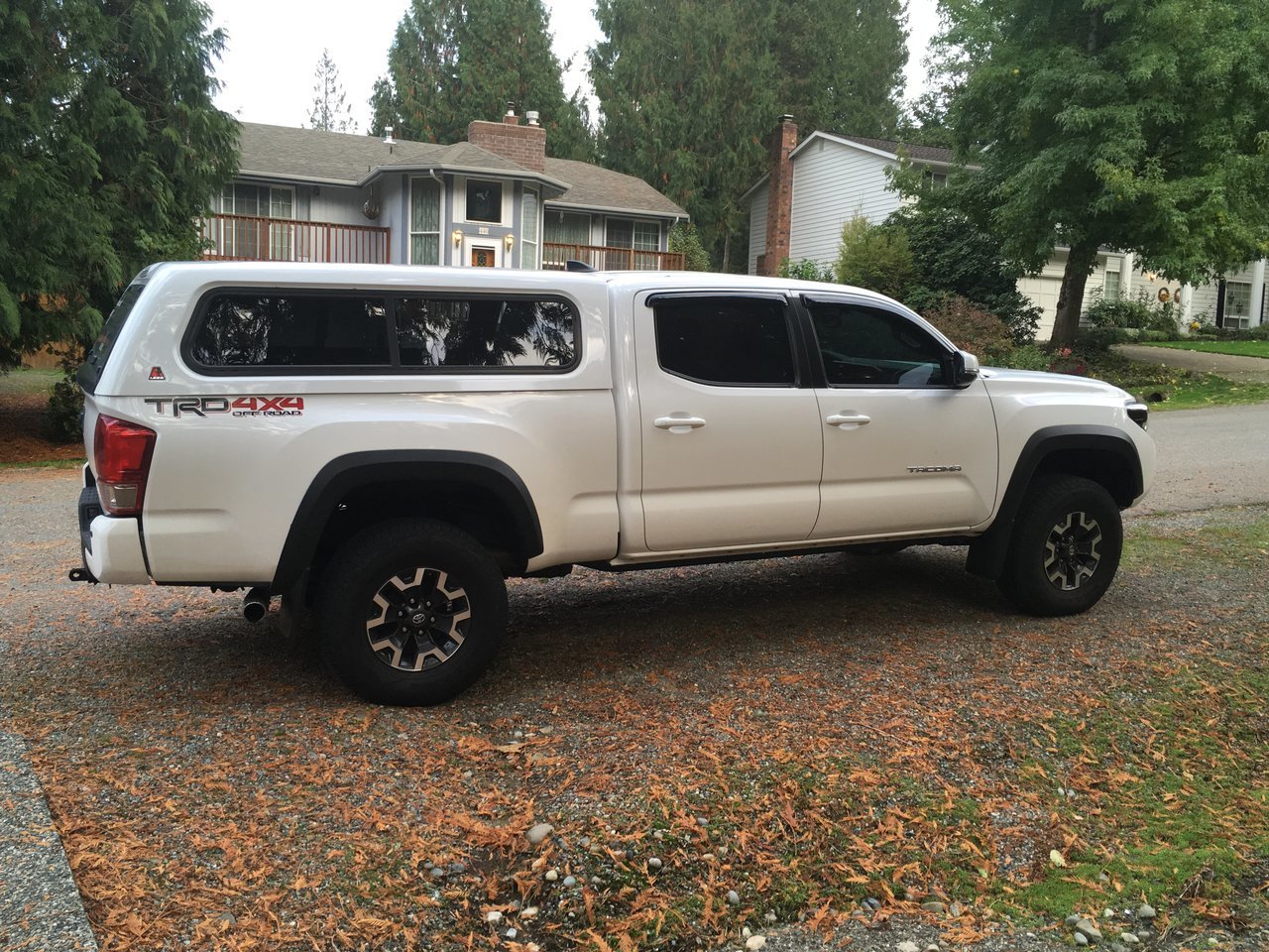

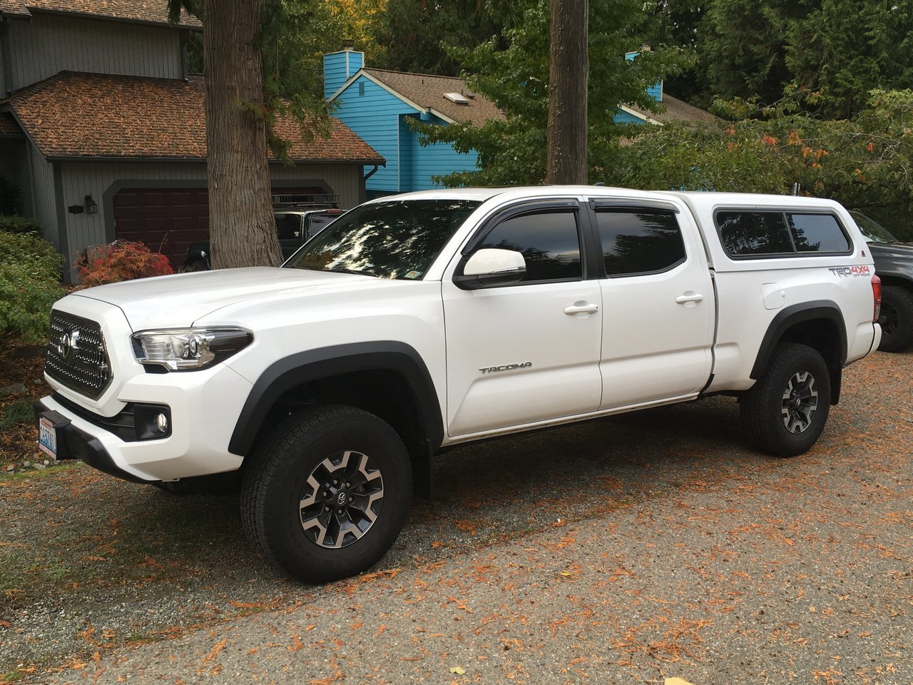

    I just did mine last week.. 5100 in the front is at the 2nd notch from the top on the 3rd gen 5100.
    Rear is 5100 w/ toytec rear block 1.5”.
    Hope this helps

    Setup works flawless, my dad owns the truck now but I am in it quite a bit. I did end up adding the carrier bearing spacer soon after due to a vibe when I’d brake.
    It rides noticeably softer than my OME medium kit on my dclb 2nd gen sport.
