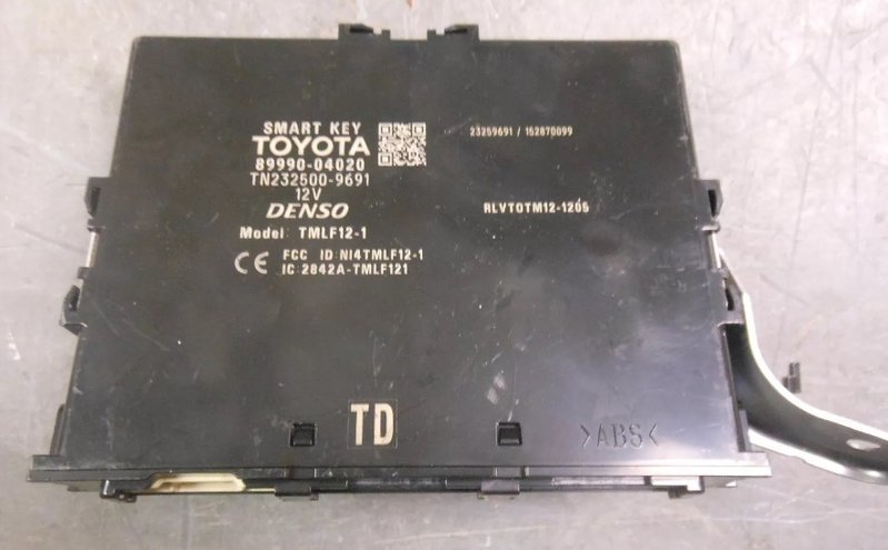

    I then decided to look at the part numbers for the Smart Key ECU. Of course they are all different depending on the vehicle model. When I dug deeper I realized the part number reflects the entire package of the ECU with the brackets. If I could find the part number of the ECU itself I could try to find a Lexus that uses the same ECU. With the help of eBay I searched for the smart Key ECUs, and after looking at countless models I wrote down the Lexus models with matching ECU part numbers (remember the brains of the ECU, not the official part number with the brackets installed that a dealer would tell you). What I found was that it is the same as the 2014-2015 Lexus IS250 and IS350. A few other models use the same ECU code, but can differ even during the same model year, including the RC, the NX and sirprisingly the IS-F.
    The icing on the cake was when I found the 2015 Toyota Highlander used the same ECU code.

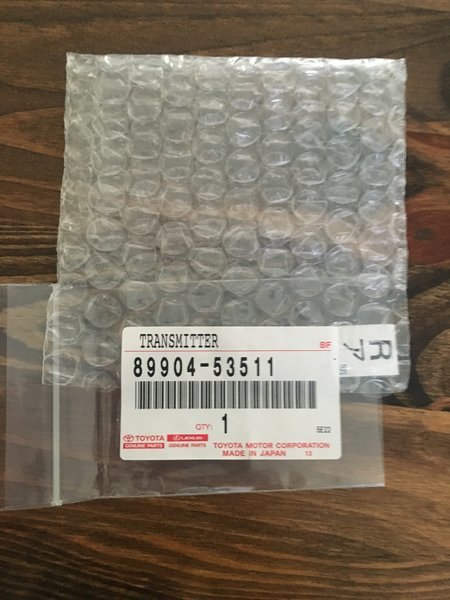

    So I found the part number for the Lexus Key for the IS250- 89904-53511, and looked for a good deal. There were several for sale on eBay for $250, and a used one much cheaper. The used ones may not be able to be easily reprogrammed though so I stayed away from that one. I found partznet.com had the best price. I paid $185 shipped after a coupon code for 10% off on Wednesdays (HUMP10, even though I purchased on a Tuesday, if that doesn't work, just call and ask for a discount, they are always good for 10% off).

    I will next order the emergency key that fits inside this key and have that cut. While at the locksmith I had a tailgate key cut, if you want the factory tailgate key, the part number for Tailgate Only key is 90999-00185
    EDIT: As time goes on Toyota may update parts or code, and these part numbers may no longer be valid on future years. Some Lexus models changed year to year, though it seems maybe to accommodate this Card Key. It is possible that this may work for every 3rd Gen Tacoma ever made, or it may only work for the first few years, so far up to the 2019s. I am including these pictures to help you know whether it should still work on your truck. image.jpg Notice the part number on the circuit board: 281451-2110 also the "AG" on the right hand side is important. Some other Toyota models have only a "G" even with similar part numbers it seems you need to match the letters as well.image.jpg
    The above photo shows the codes and part numbers written on the back of the wallet card.
    On the ECU or "control module" the most important numbers are "TMLF12-1" this is the model number for the ECU. The other part number you see is the Tacoma part number which includes the bracket, that may change, but as long as the TMLF12-1 stays the same (which is shared with Lexus and a few other Toyotas) you should be able to get this solution to work for you.
