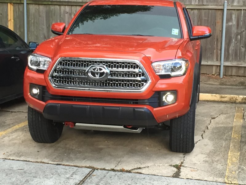

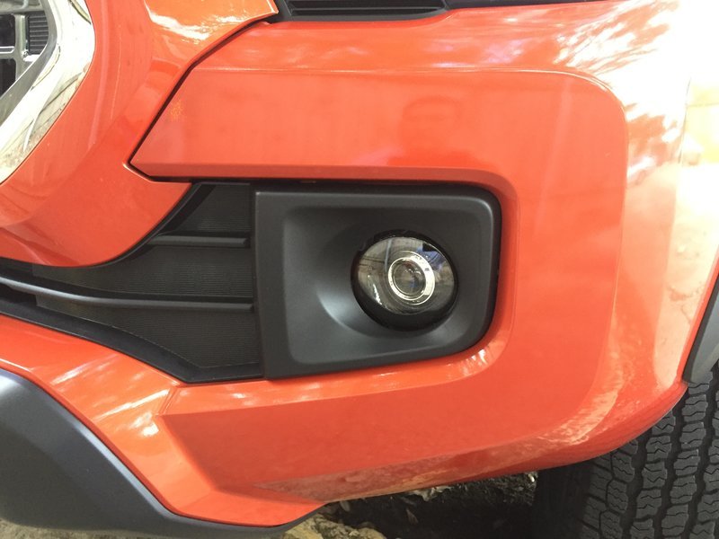

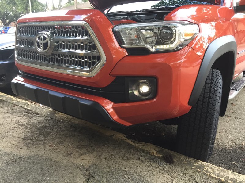

    I took a chance and bought some 2013 Lexus LEDs fog lights , they fit second and third generation Tacomas perfectly , is plug and play. I figure if they are good enough for a lexus , they should be great for my Tacoma.

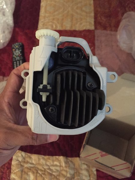

    81220-30380, 81210-30430 These are the parts numbers. They are about $150 a piece , it took me 10 minutes per light to install, very simple .

    TRD OFF ROAD inferno color .
    OEM fit and quality is why I took this route.

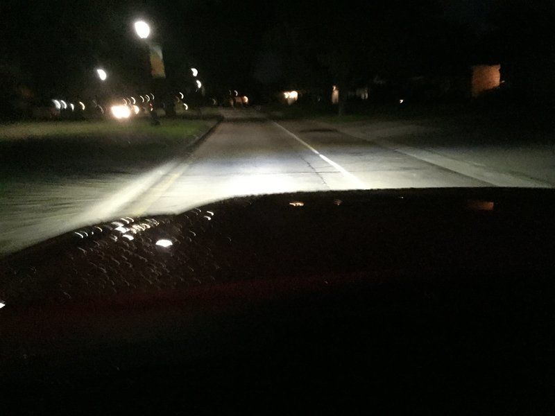

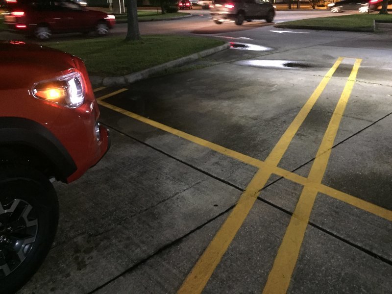

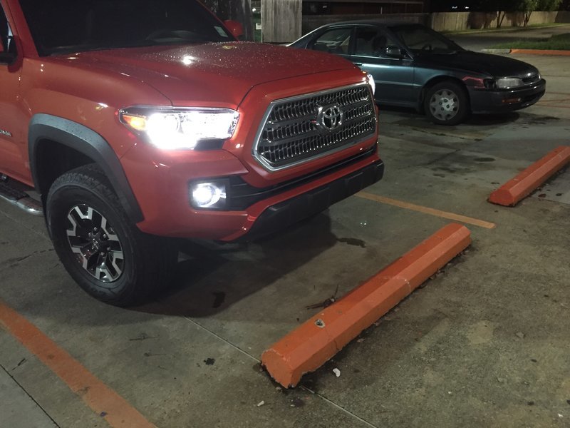

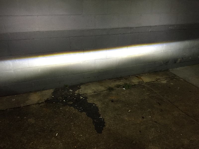

    The first picture is driving with just the fog lights , second picture you can see the sharp cut off line with a fine yellow to blue and third , they are very bright but control accurate beam.
