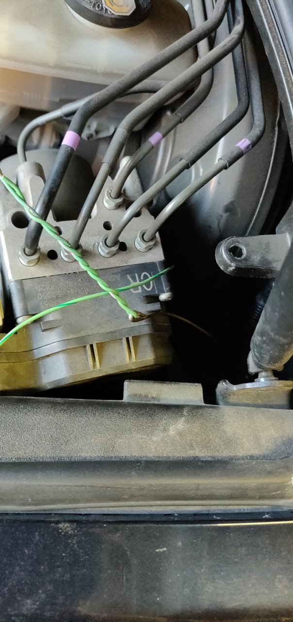

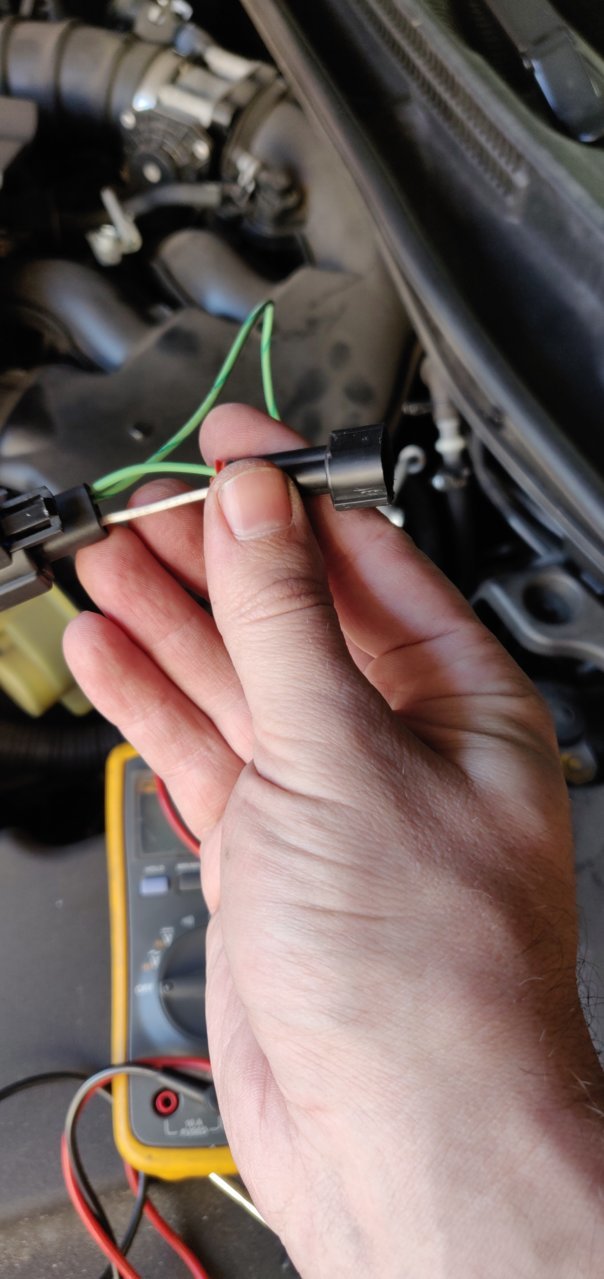

    So one day googling around I find that the is250 has a 7th cold start injector due to direct injection cold start drama I guess- funny how old stuff comes back around. My excitement was that ''ah ha!" I can hijack that injector to inject when cruising on the freeway, the OEM ECU will learn around it and lean back to stoich and I will be cruising with "port injection" supplementing the direct injection simuliar to the is350 (hense it does not have the issue and tsb). Furthermore after looking at the injector I'm thinking its more a "7th fuel injection valve" as some old cars would put it- its not built to duty cycle but just on/off.
    Finally got some parts in to test this on DISCLAIMER- if u have a lot of build up and do this you could break off chunks or carbon and get into the combustion, maybe even score the cylinder!!!

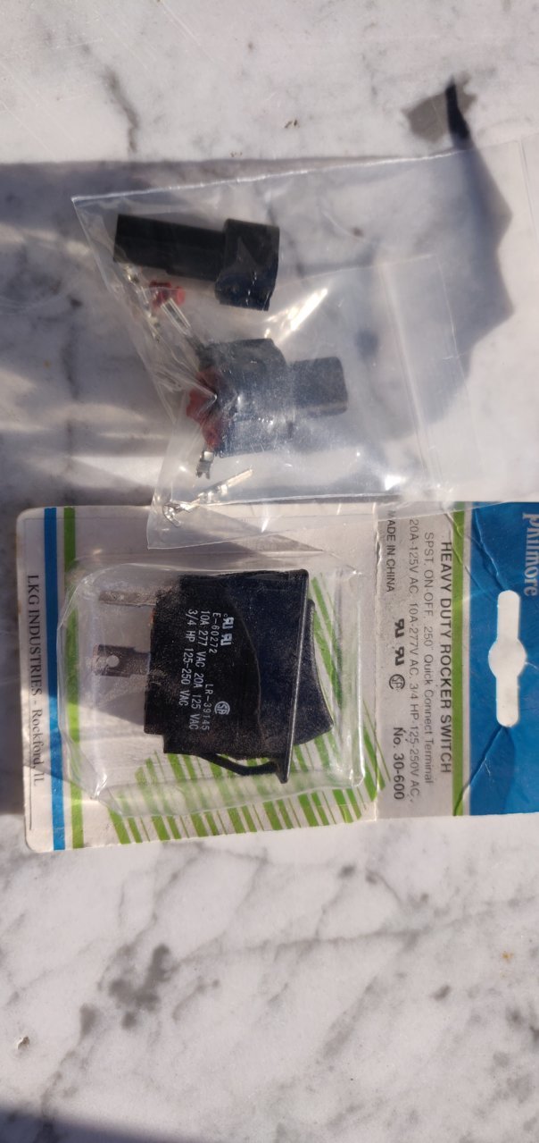

    Whipped up a harness and switch and promptly stalled the motor at idle- so for sure this thing puts out more fuel than I initially suspected (had thought this just supplements the direct injectors during cold start).

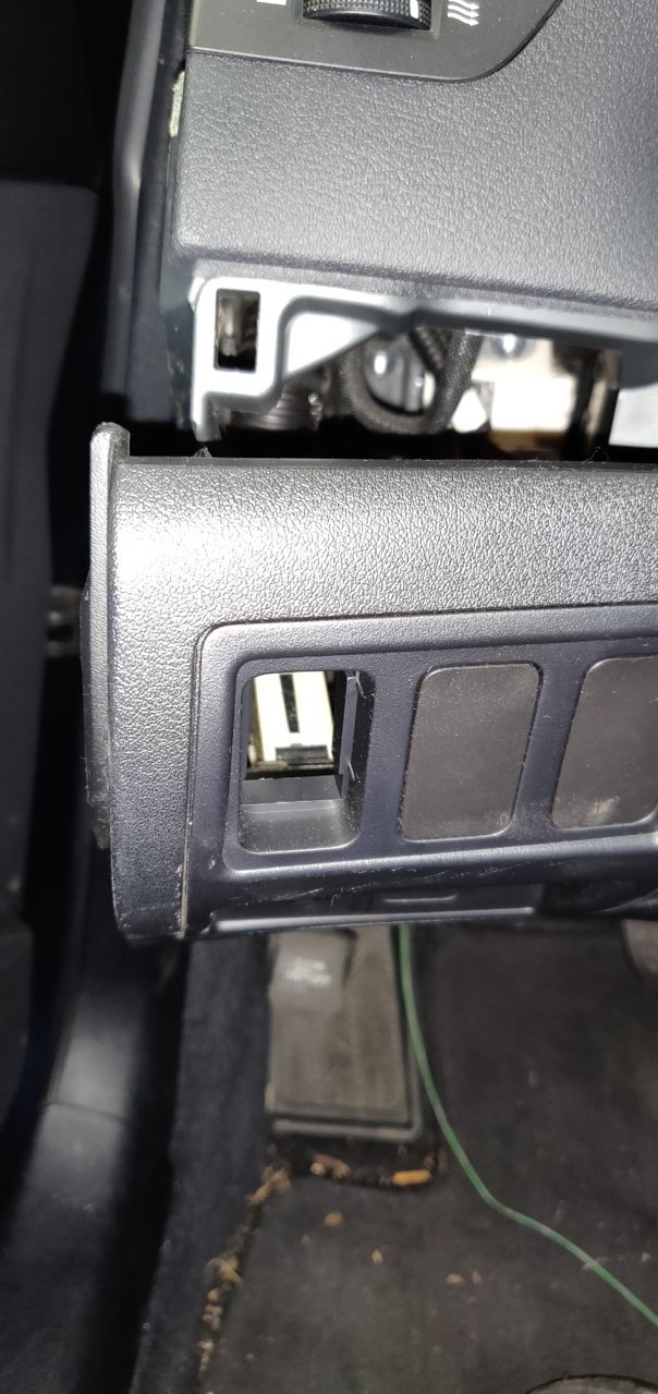

    'y'ed the ground side of the injector extension harness I made so I could run it to a switch in the cab, that was wired to a bolt behind the dash for ground.
    Some driving at speed and yep, it dumps the fuel and you get that nasty cat smell u often get after doing WOT runs on newer cars.
