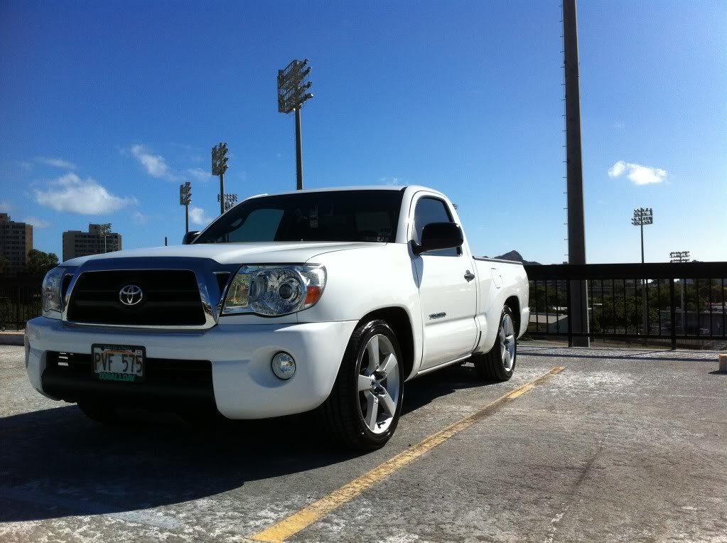

    Most Toyota/Lexus car wheels have a smaller centerbore than the 5-lug Taco (60 mm vs 67 mm), but the bolt pattern is the same.
    - Most Mazda wheels (including RX-8 wheels) have a 67 mm centerbore and are a direct fit. Kelson's truck:
    Lexus GX wheels will fit 6-lug Tacos, though those wheels are nothing special.

    So I should just look for some nissan 350z rims? That nissan cap wont look good on my truck

    Nissan wheels have a 66 mm centerbore, so you'd need to get them reamed out to 67 mm at a shop or use lugcentric spacers (not recommended - too easy to get vibrations).

    found a set of 2004 RX-8 rims,if i choose to use these I want to get rid of the mazda center cap,is there a toyota cap I can put in its place?

    i think it's camry too it's a standard size but i ordered corolla alloy rim 16" center cap.
