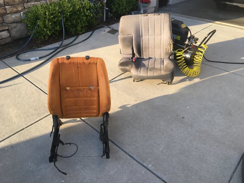

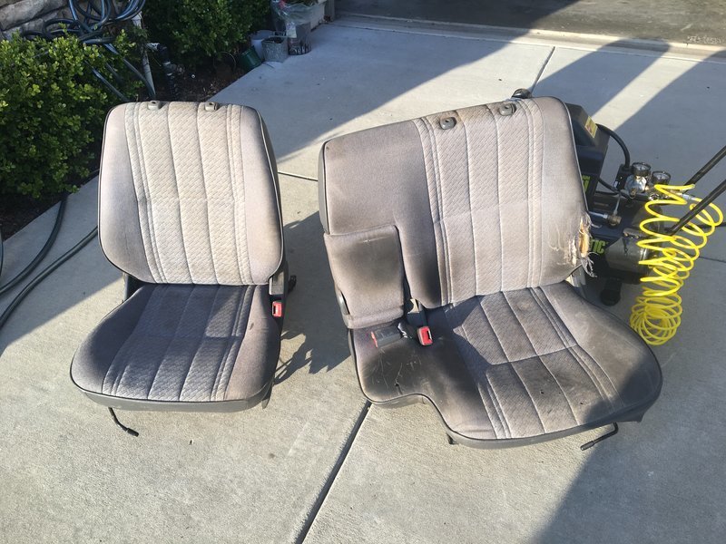

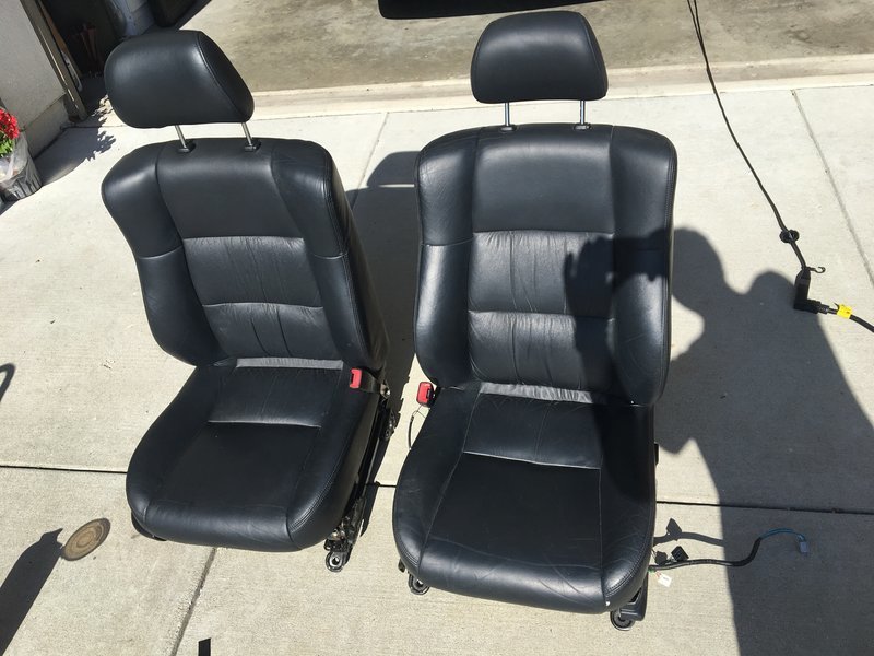

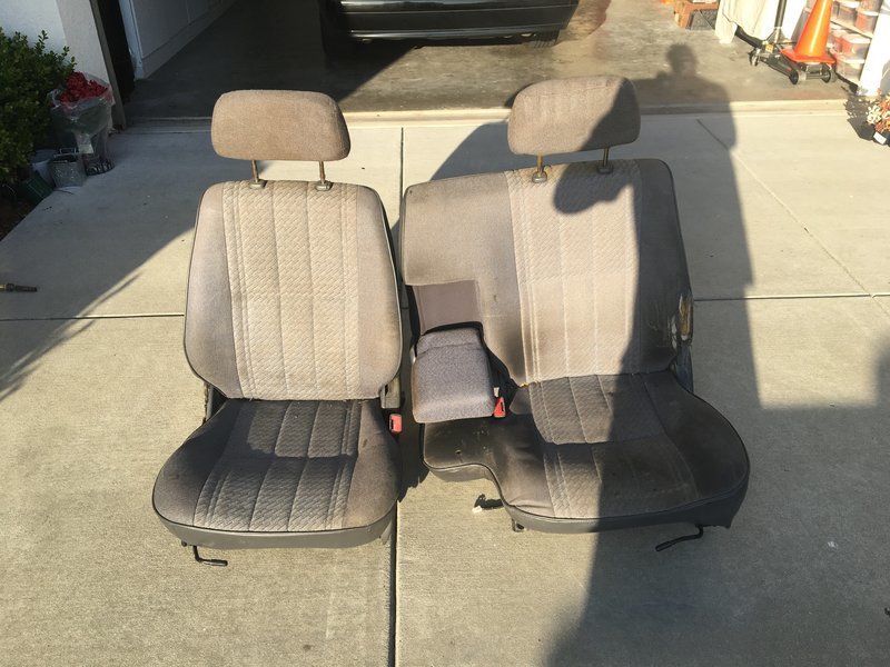

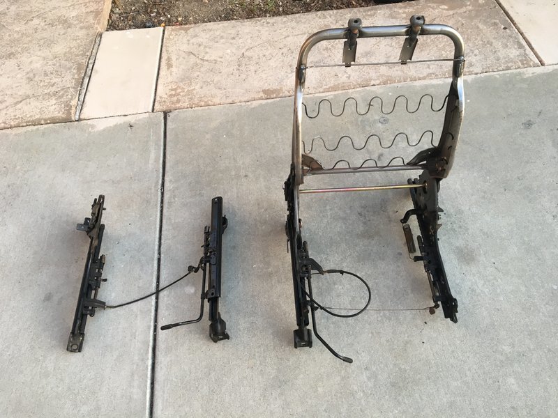

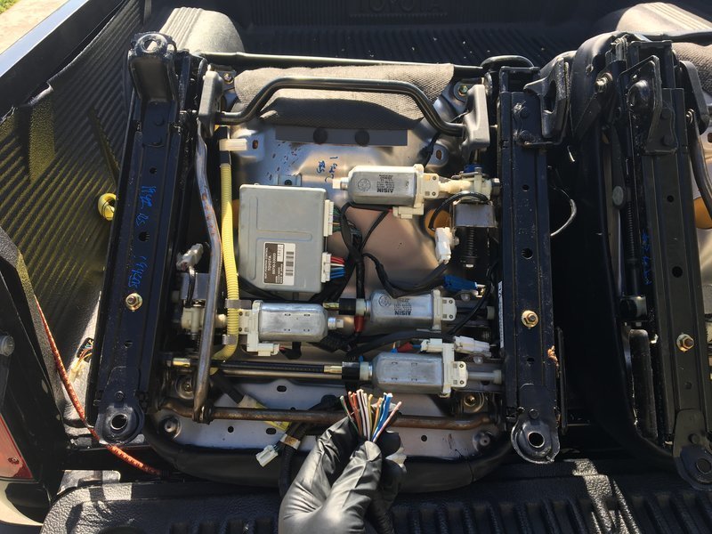

    Ha wow I just so happen to be putting 2001 Lexus ES300 seats in my Tacoma. They're black leather seats with heat, motorized controls, position memory, and memory foam. Don't know if they're any different from the IS300.
    I found the FSM with all the schematics and diagrams through a friend and identified all the wires. Four of them will be for the side airbags. Wish I was ambitious as you just connected 12v to wires and seeing what works but I was afraid of deploying the airbags. My driver's chair has about 20 wires coming out of it, and most of it is either 12vdc or ground.
    You have any pics of how you mounted it and your brackets? I bought some scrap 60/40 seats and saved the bracket and sliding mechanism so it'll be easier for passengers to get into the rear of my ext. cab. My plan is to drill off the Lexus mounting feet, and weld the Lexus rails to the Tacoma rails.
