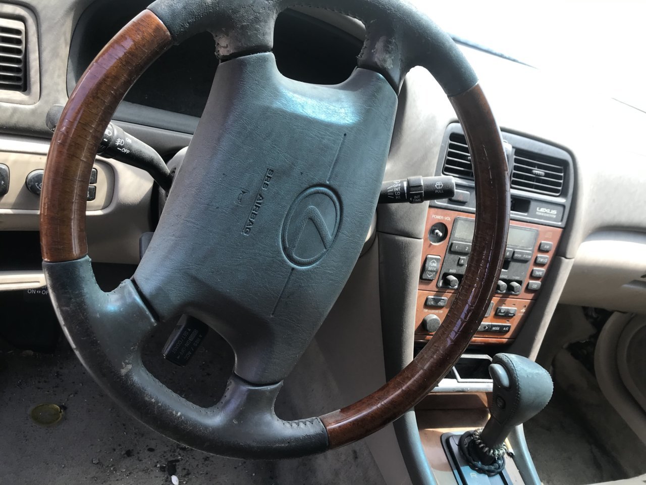

    99-00 Lexus ES 300’s with the Bird's Eye MapleWood Trim
    I’ll be re finishing and installing in a 3rd gen 4runner. This should work for 1st gens as well
