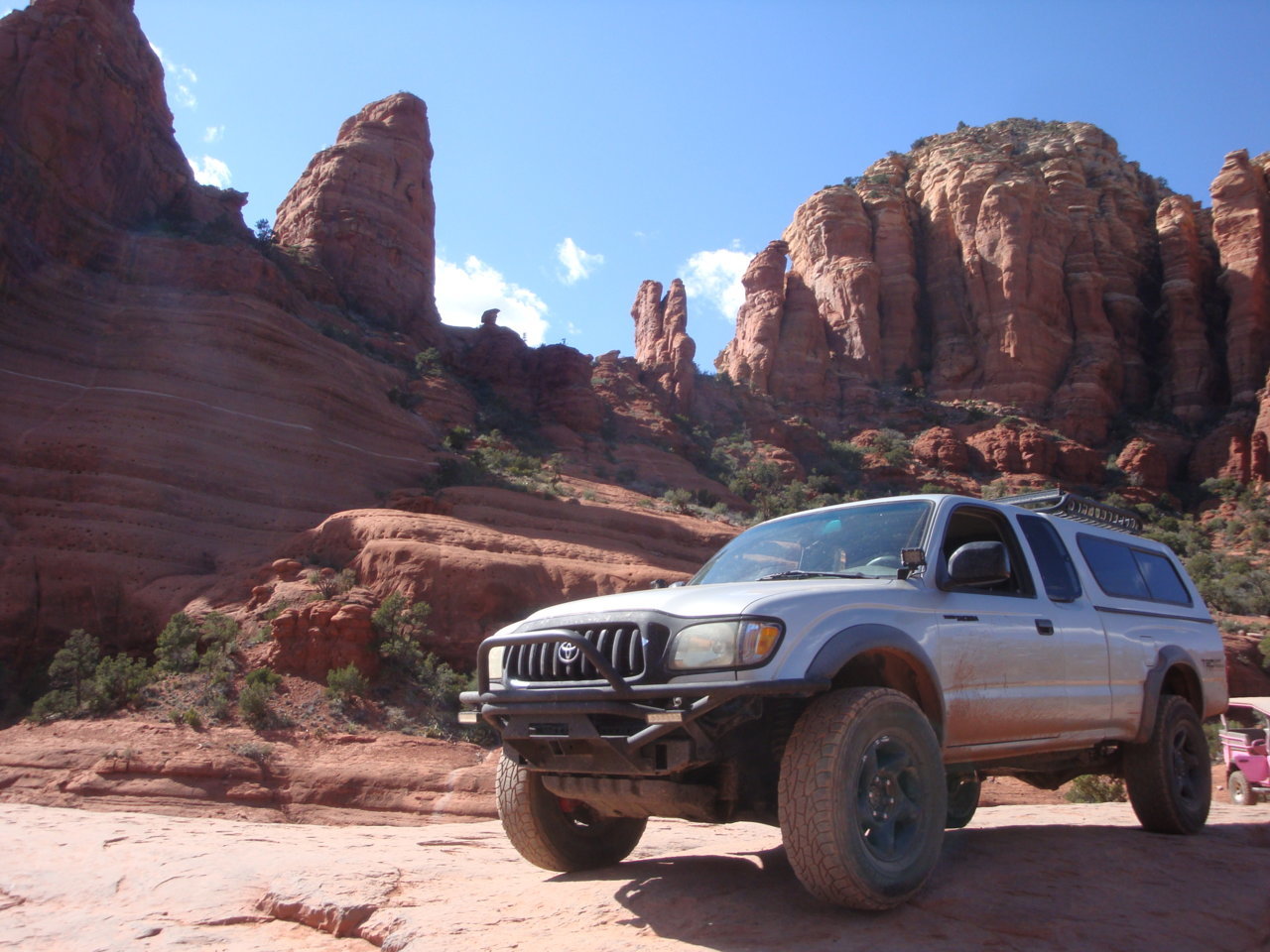

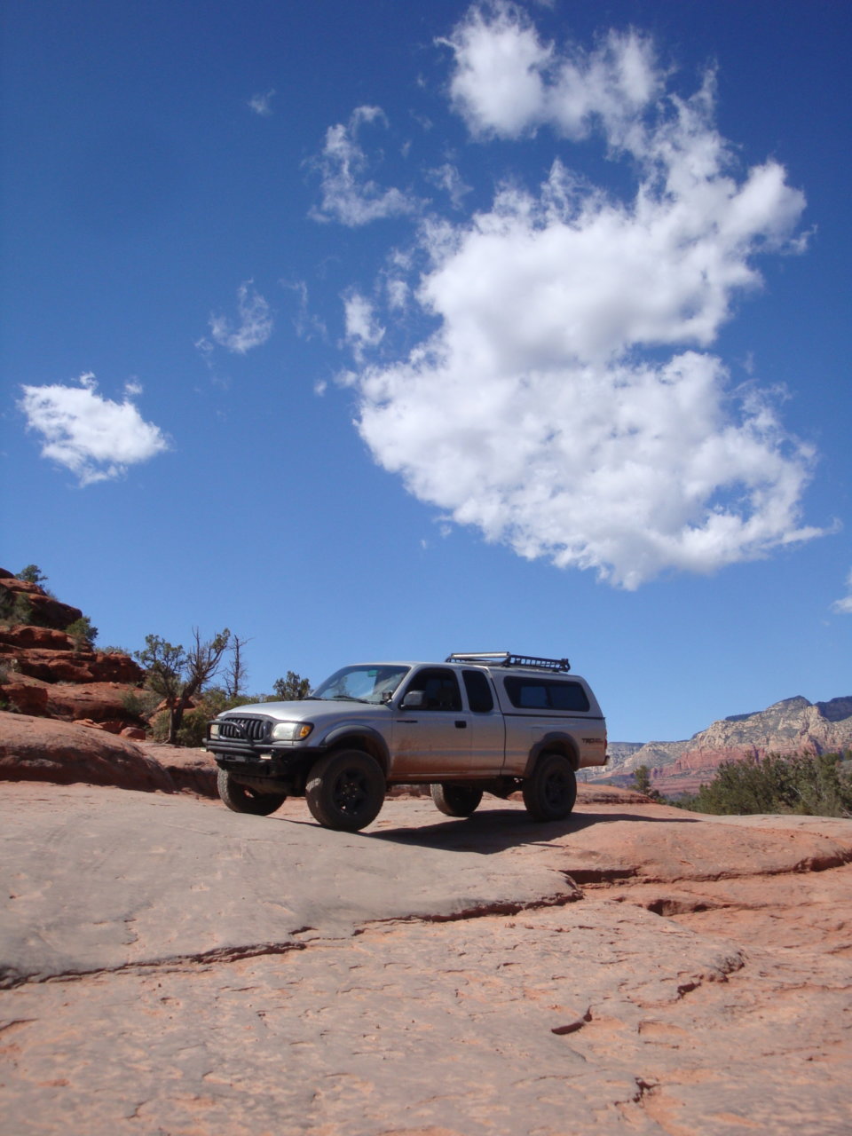

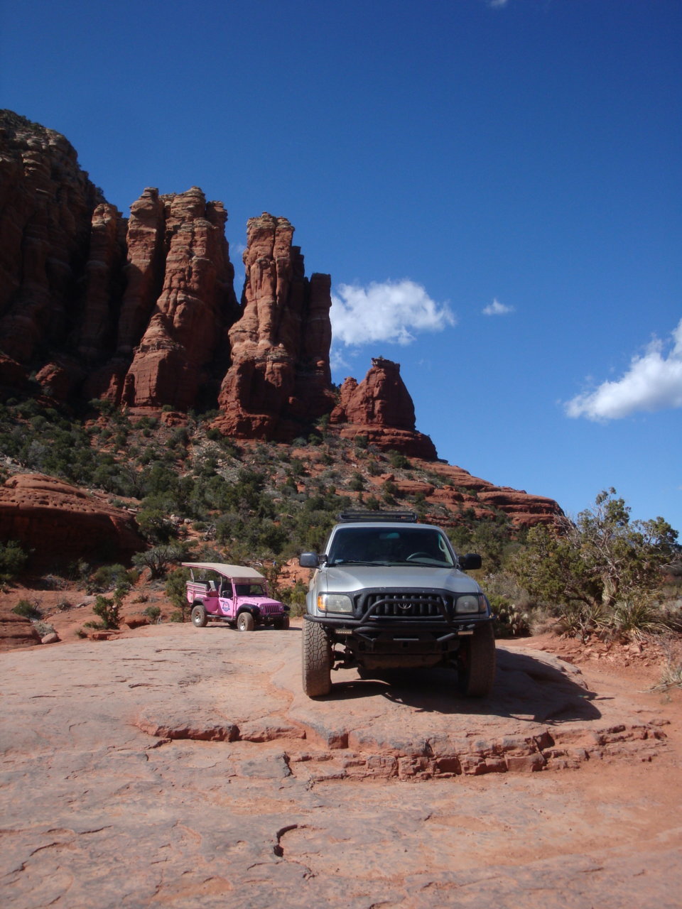

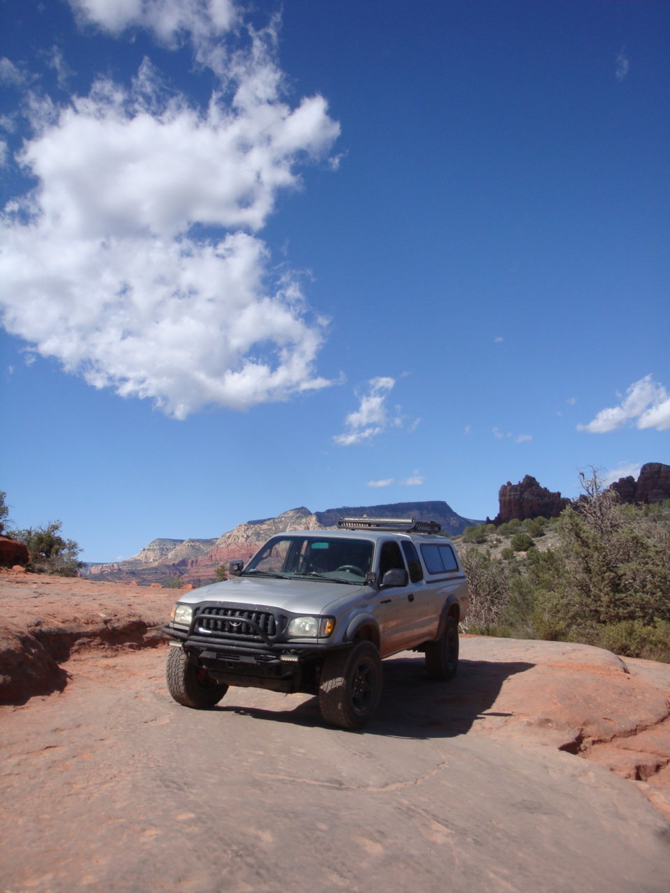

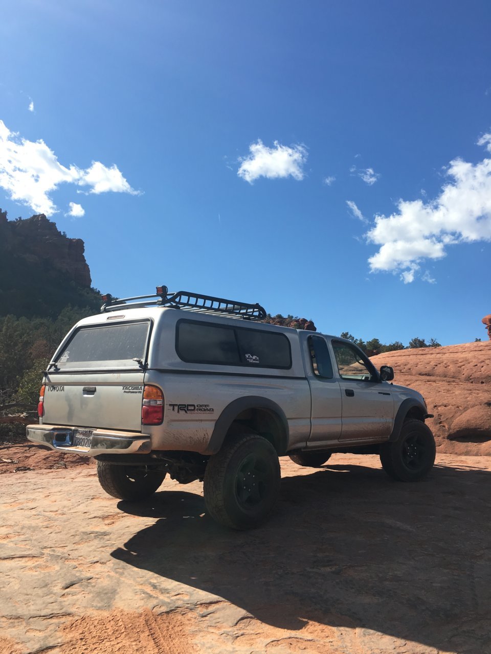

    Took a trip to Sedona today to try Broken Arrow Trail. Was a blast! Was a good excuse to see how low range feels offroad, and got a good shake-down and stress test for all my new drive components
    DSC03210.jpg DSC03211.jpg DSC03214.jpg DSC03219.jpg DSC03218.jpg DSC03222.jpg

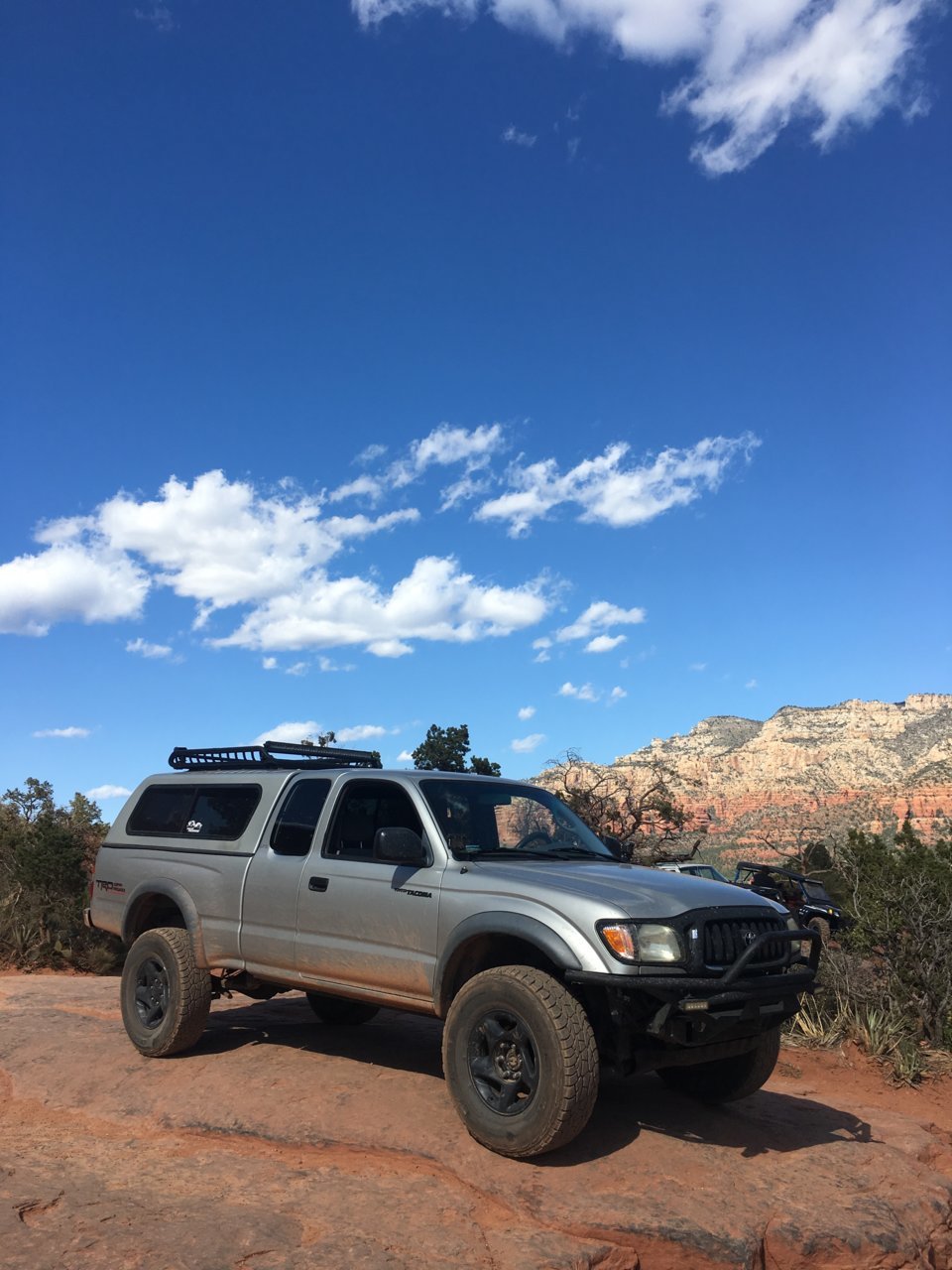

    More pictures from my phone
    19A165EC-64D5-4EF2-8DF8-0800F3165A7A.jpg7C917A6B-180F-4302-8E27-A367FF67747B.jpgE0C9465A-D81D-4896-BD53-E882A485E884.jpgFB83A7AF-B5FB-43E4-A411-6CA4C3012435.jpgFDE494F0-932F-4FE6-B977-3DECD77014C0.jpg94A894FF-9851-47A4-A1E6-8D21CBAD87D0.jpg

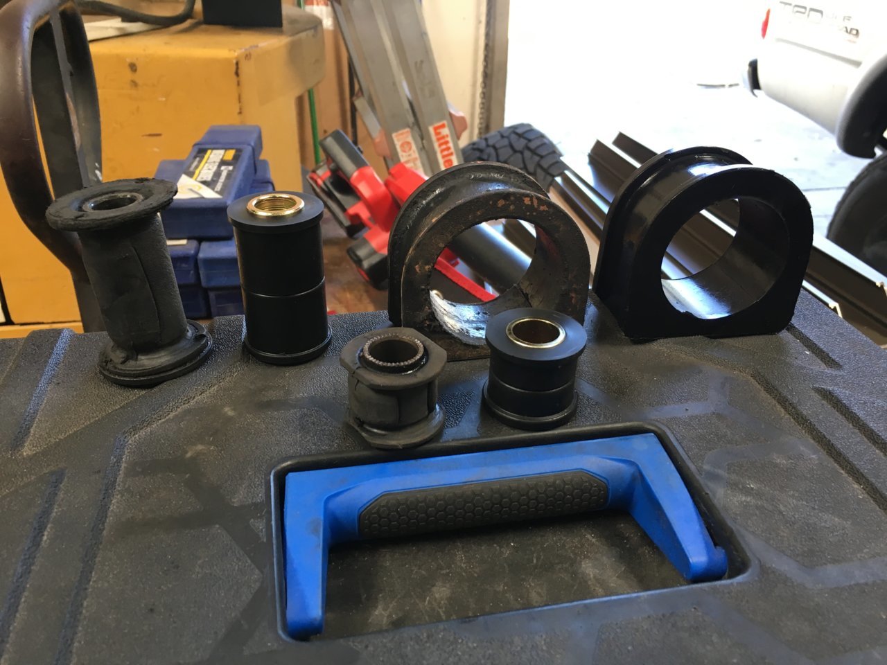

    Did my steering rack bushings today. Was kind of a bitch but certainly doable without removing the rack from the truck or using a press. Just needed a big C-clamp and a bunch of cussing.
    Really glad with the turnout, the old bushings were so shot and now I got some kickass Energy Suspension poly in there. Next come LCA bushings!

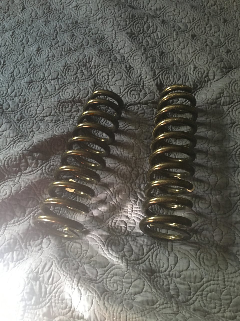

    Impulse-bought some OME springs after talking with some friends about trucks. Figure I’ll wanna do them anyways, so I might as well do it now since I’ll be tearing apart my front end to do the bushings.
    Still need to find time to get the bushings done, too. Been ultra busy with work and can’t find any shop days. Hopefully July has some more opportunities open for me

    Springs came in and I got shop time on Monday, so I should have my front end finally dialed in next week
