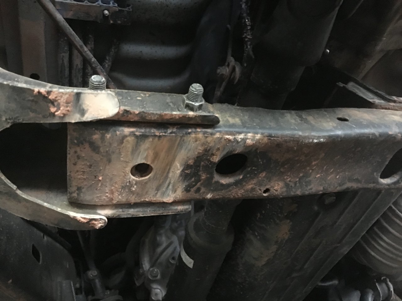

    I’ve done like 4 offroad trips with my 4wd conversion finished and I’ve already scraped up my crossmember and tcase skid
    Good news is they’re doing their job though, so I’m happy :thumbsup: definitely wanna do some full skidplates sometime soon, though. After sliders, I reckon.

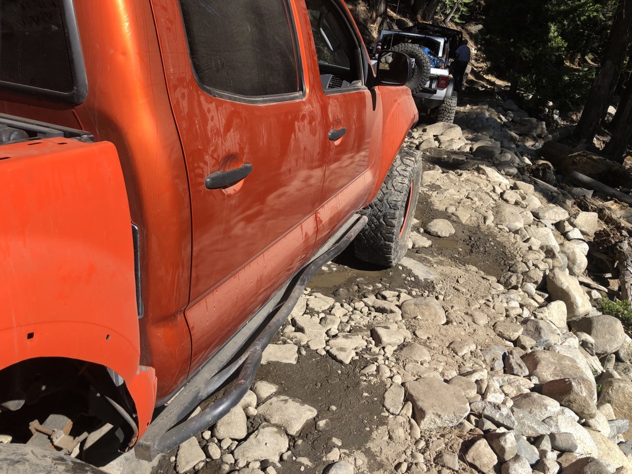

    And skids need to get used. I just ran the rubicon in Tahoe a few weeks ago and dented/ bent every skid I have lol. And they are reinforced 3/16”. Hell even dented my fully fabbed lca. But it was worth it. Looking forward to you coming back and doing some wheeling.
    Edit: sliders for reference. Used to be straight and rear doors don’t open anymore. Time to chop off and rebuild with much thicker material.

    No, but DOM of the same specs would have done the same thing. DOM is a waste on something like this. My roll cage on the other hand is DOM. Problem was 0.120” wall and not enough supports. But heck for the first thing I ever fabricated like 6yrs ago they lasted longer than they probably should have. New set will be 0.25” wall all around and extra beefy

    Exactly. This was from getting stuck between 2 rocks and a hard place (tree). Was debating on redoing them anyways, nature just gave me the go ahead lol

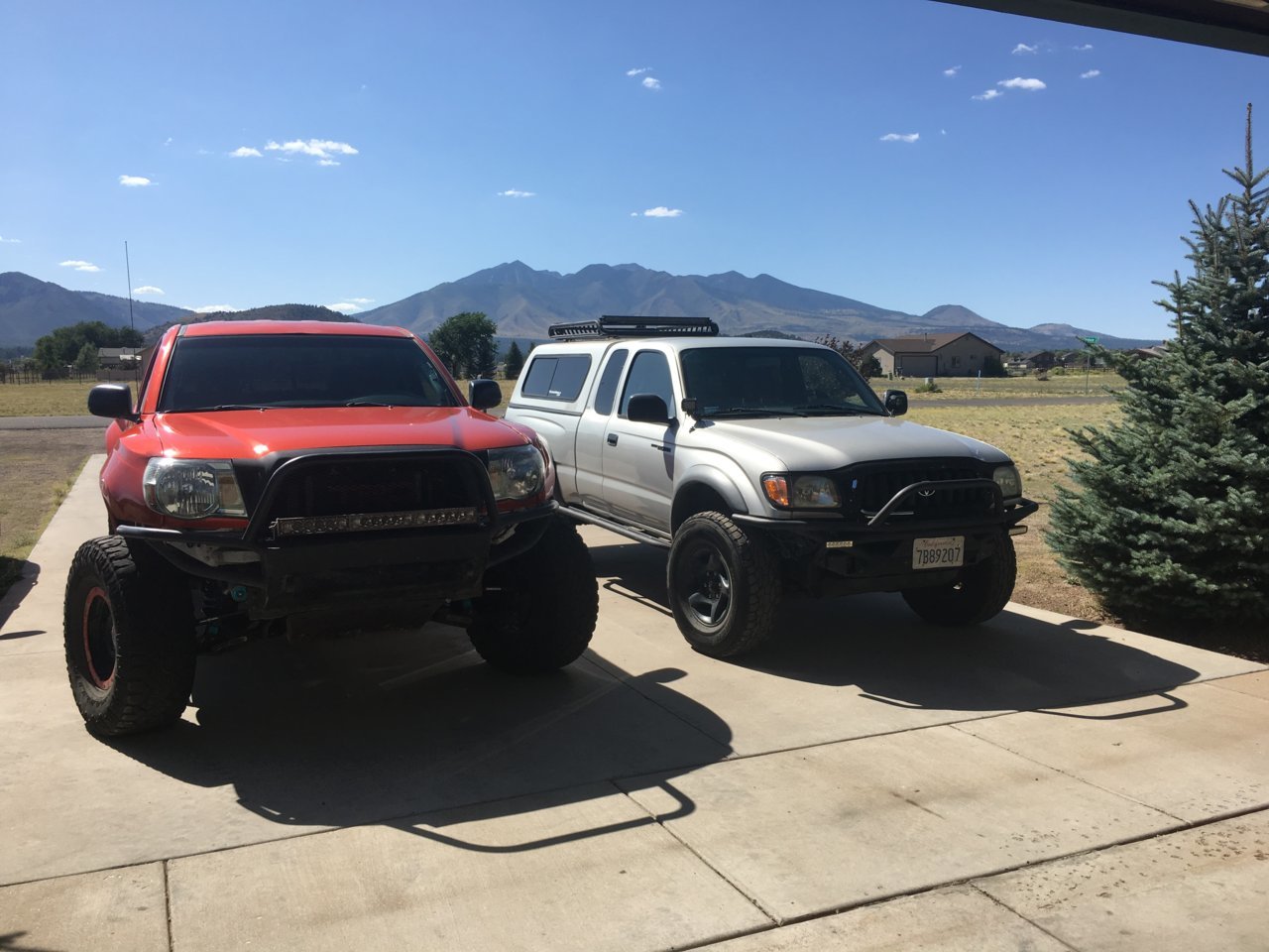

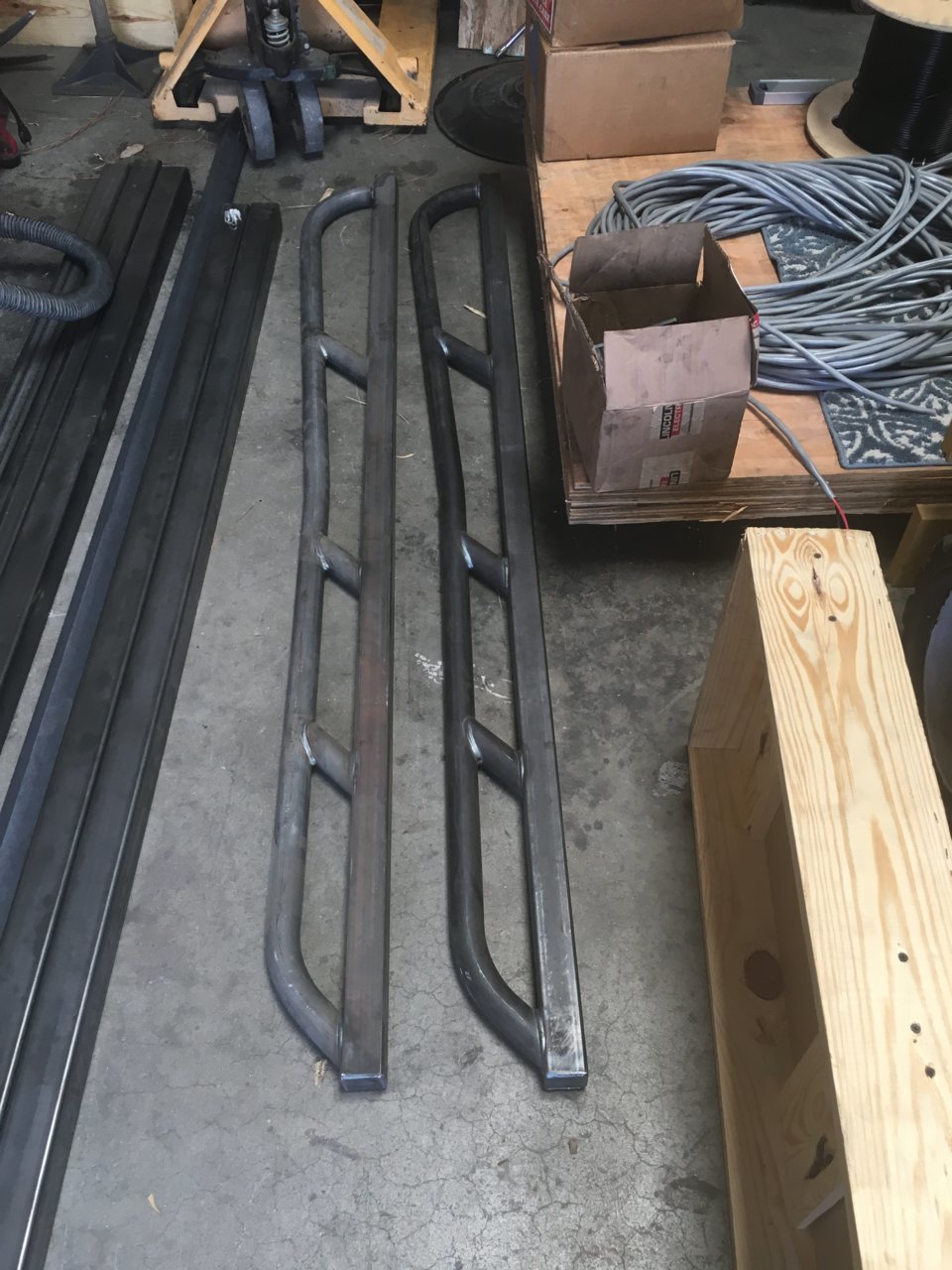

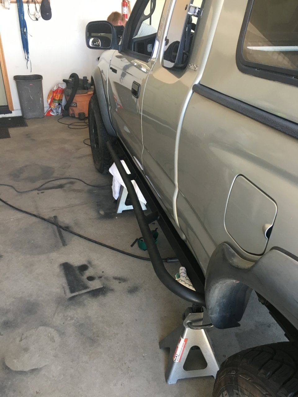

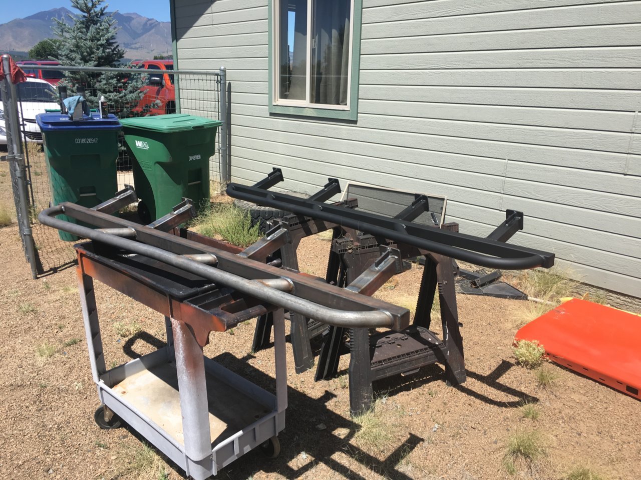

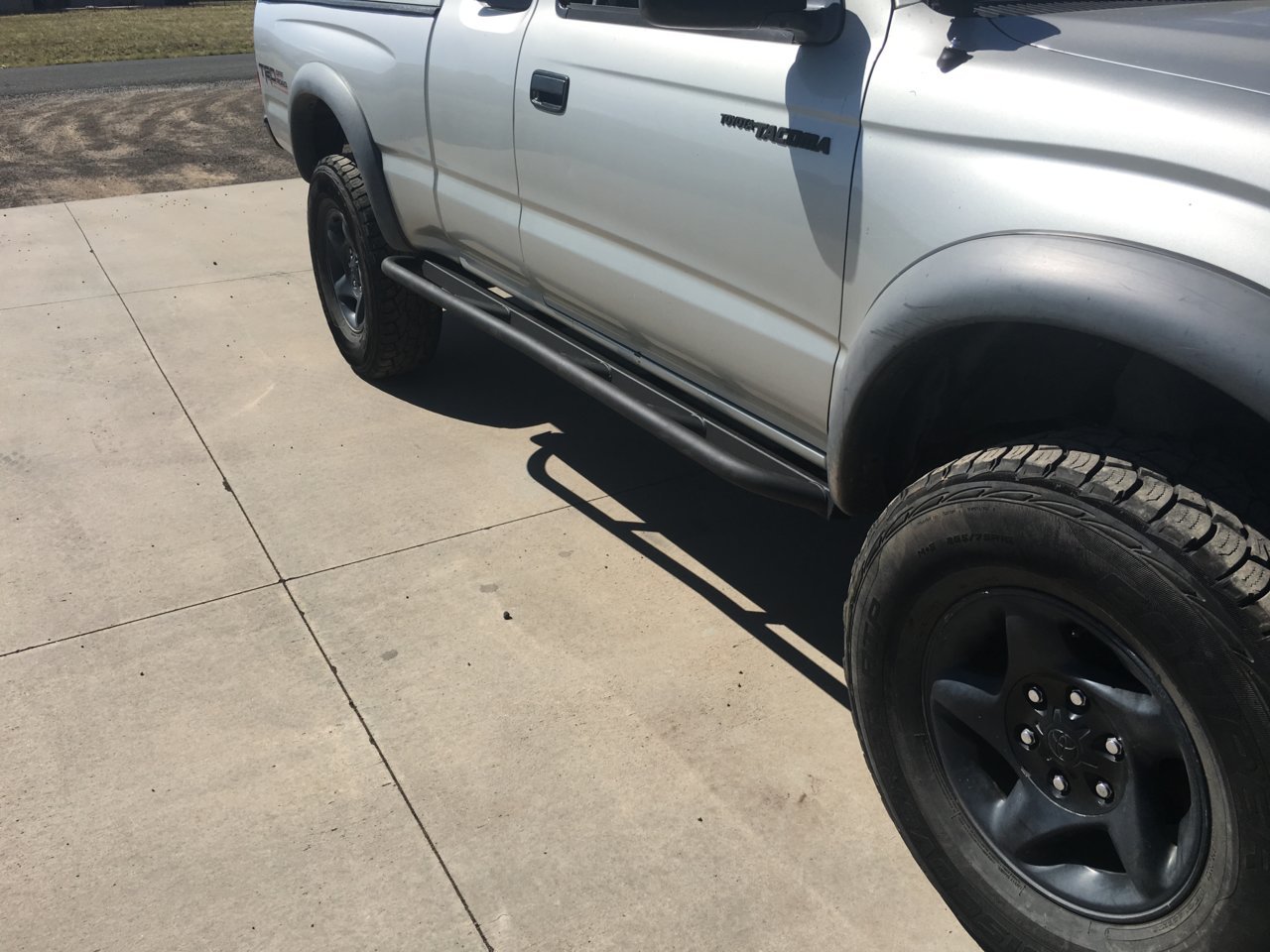

    Picked up some sliders today thanks to my boy @YumaTRD, can’t wait to get these welded on!

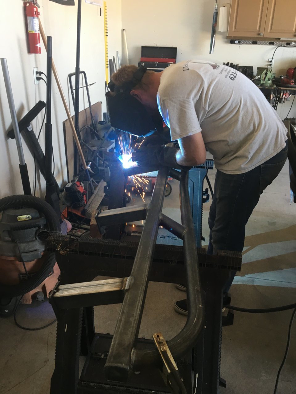

  12. Aug 25, 2019 at 4:21 PM
    #252
    Lfaub03
    Lfaub03 [OP] 4wd wannabe
    Feb 15, 2015
    #148762
    1,138
    Logan
    Flagstaff, AZ
    2003 Prerunner TRD
    4wd conversion

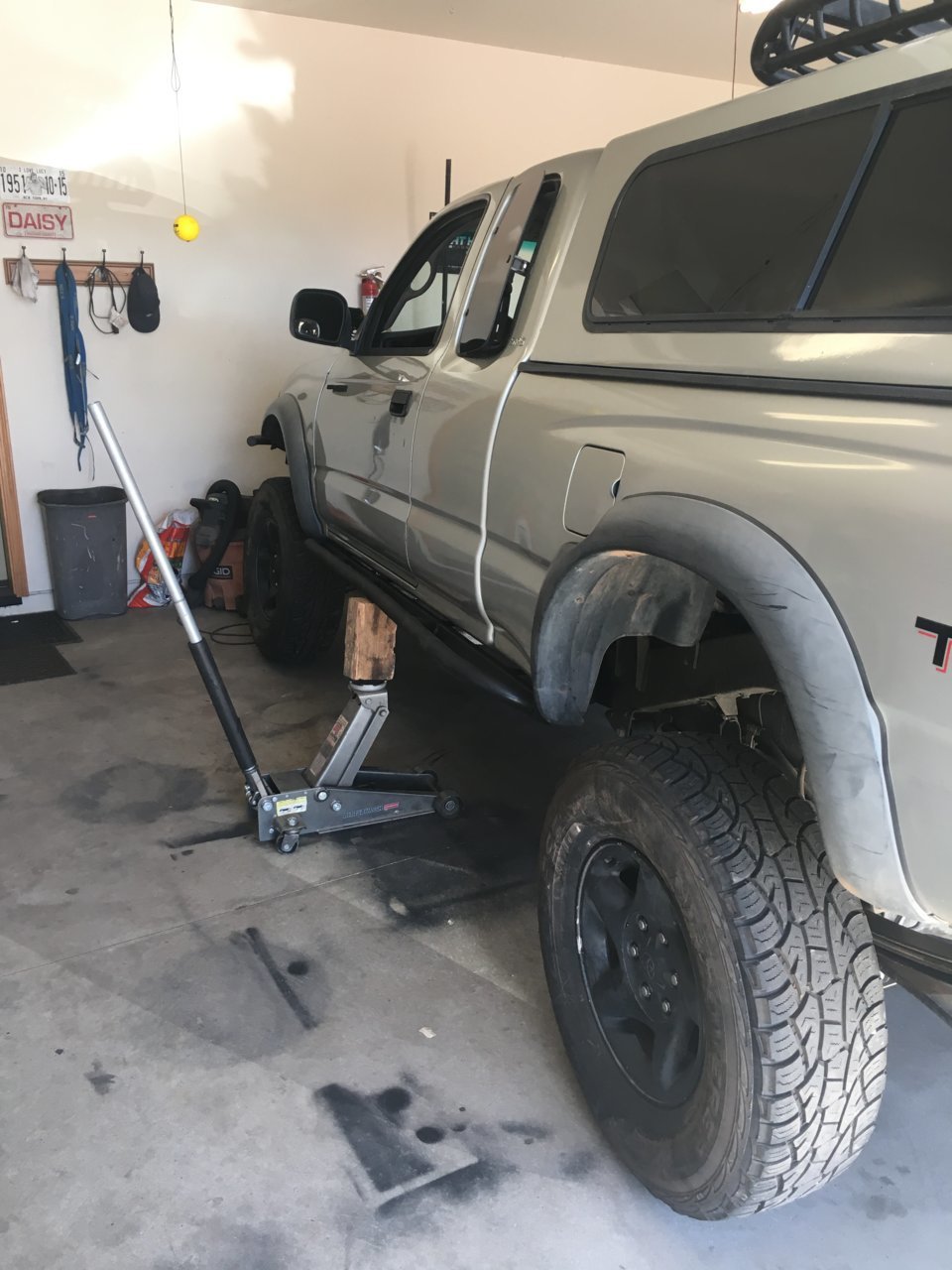

    Got them dang ol sliders put on with the help of @snowsk8air2, they look amazing and are sturdy af. Big thanks to him and YumaTRD for hooking me up and finally getting some armor on this truck!

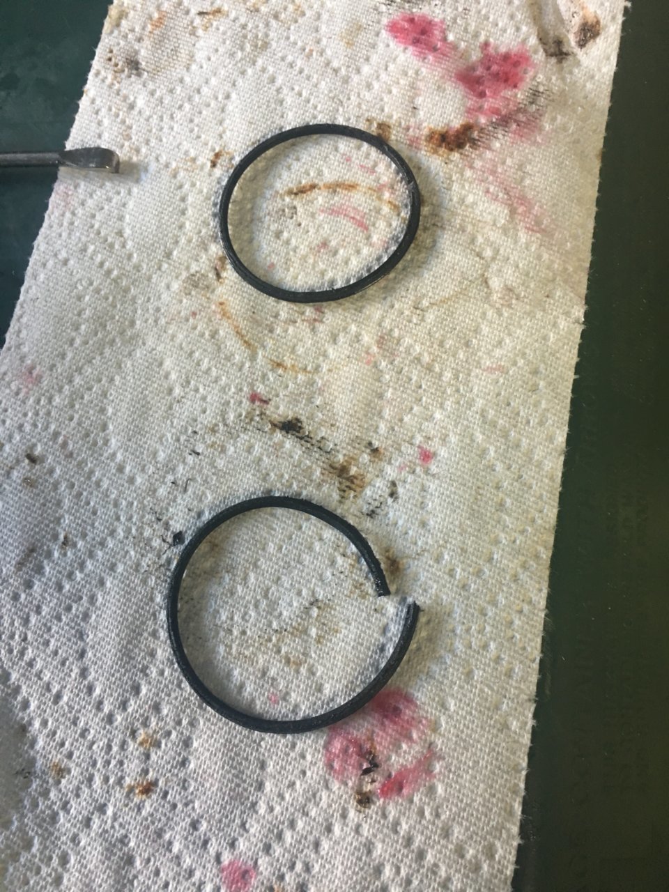

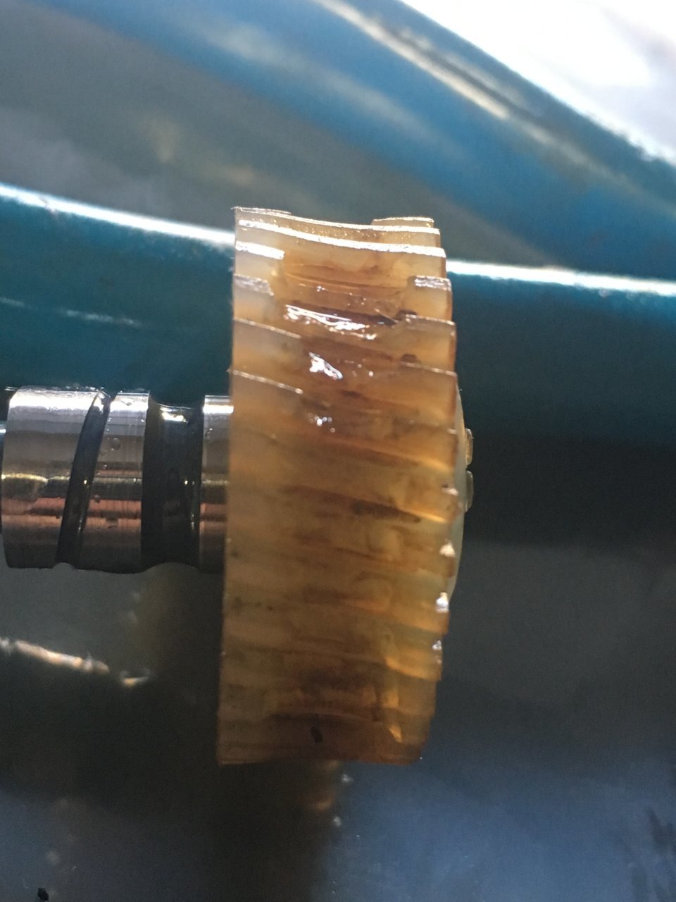

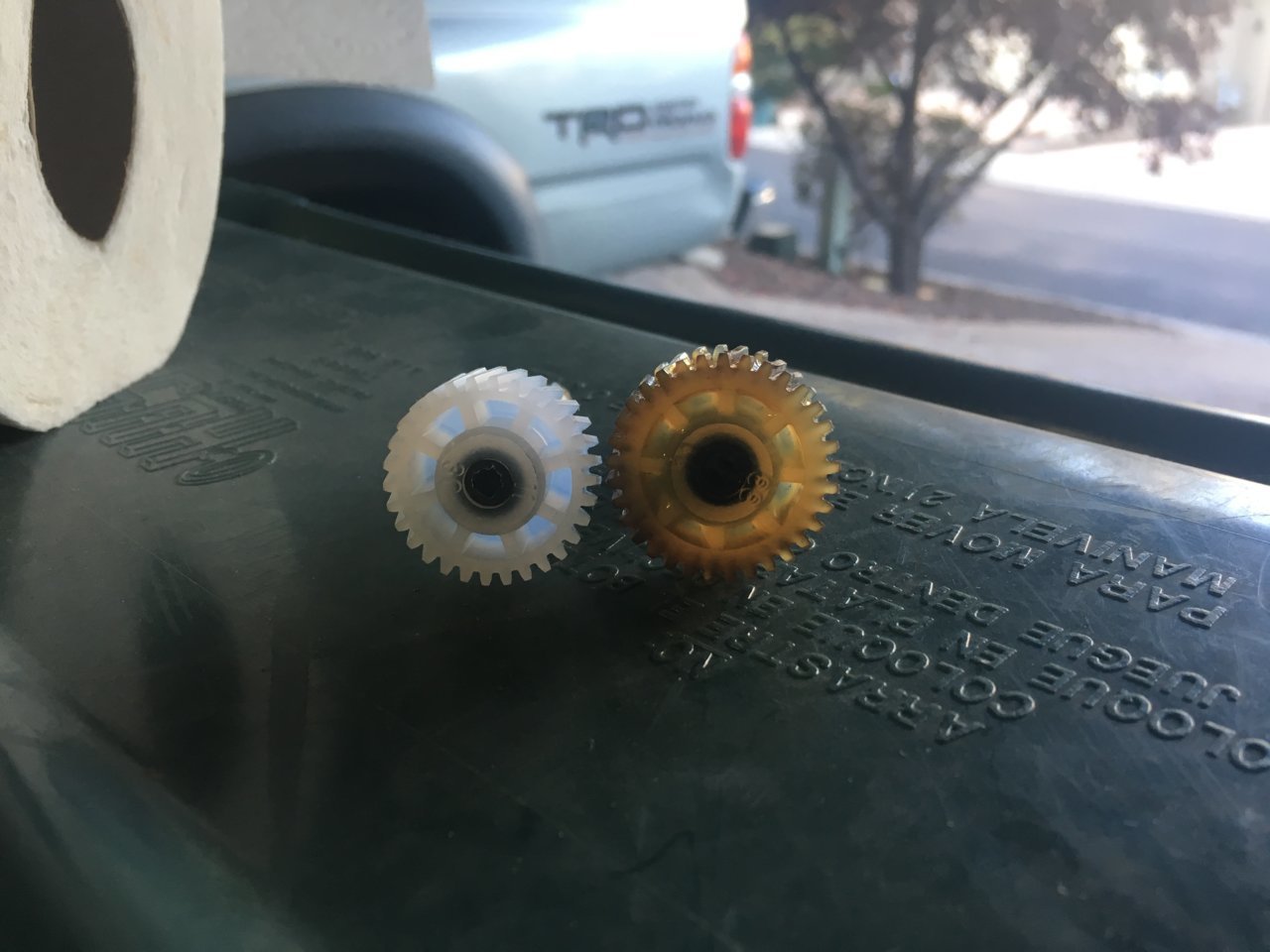

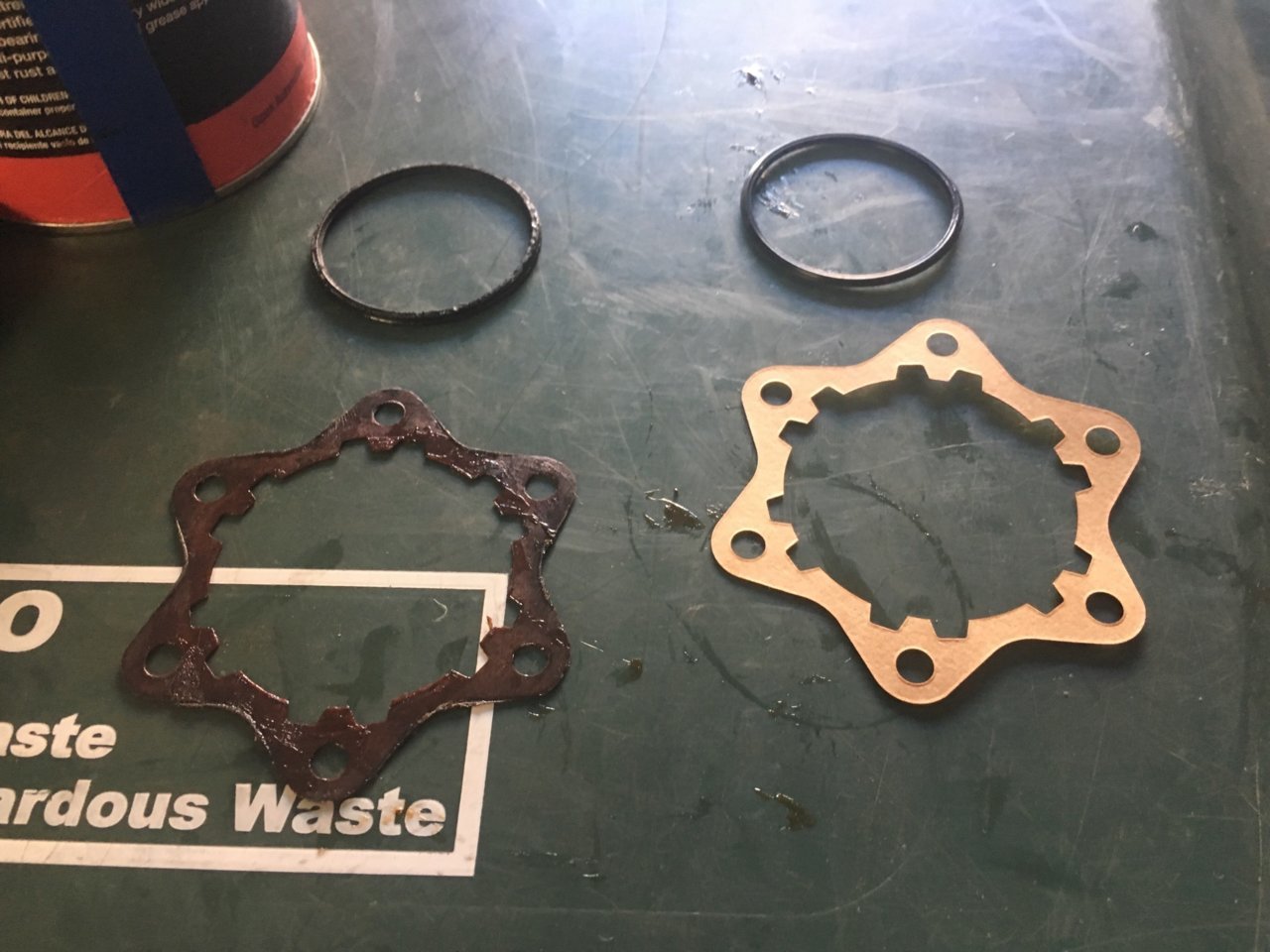

  20. Oct 4, 2019 at 8:31 PM
    #260
    Lfaub03
    Feb 15, 2015
    #148762
    1,138
    Logan
    Flagstaff, AZ
    2003 Prerunner TRD
    4wd conversion
    Did some small stuff today. Replaced my hub gaskets since they’ve been pretty shot. Glad I did because the passenger side o-ring snapped just pulling it off the hub switch.
    Also swapped out my speed sensor gear, and I’m glad I did because it was not in very good shape. I knew the old one was giving me the wrong speed reading but damn it was gnarly
