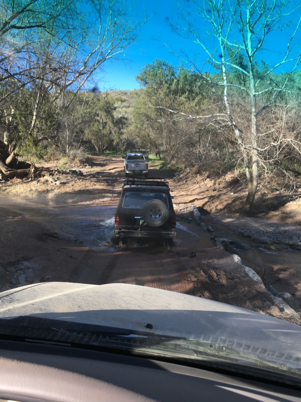

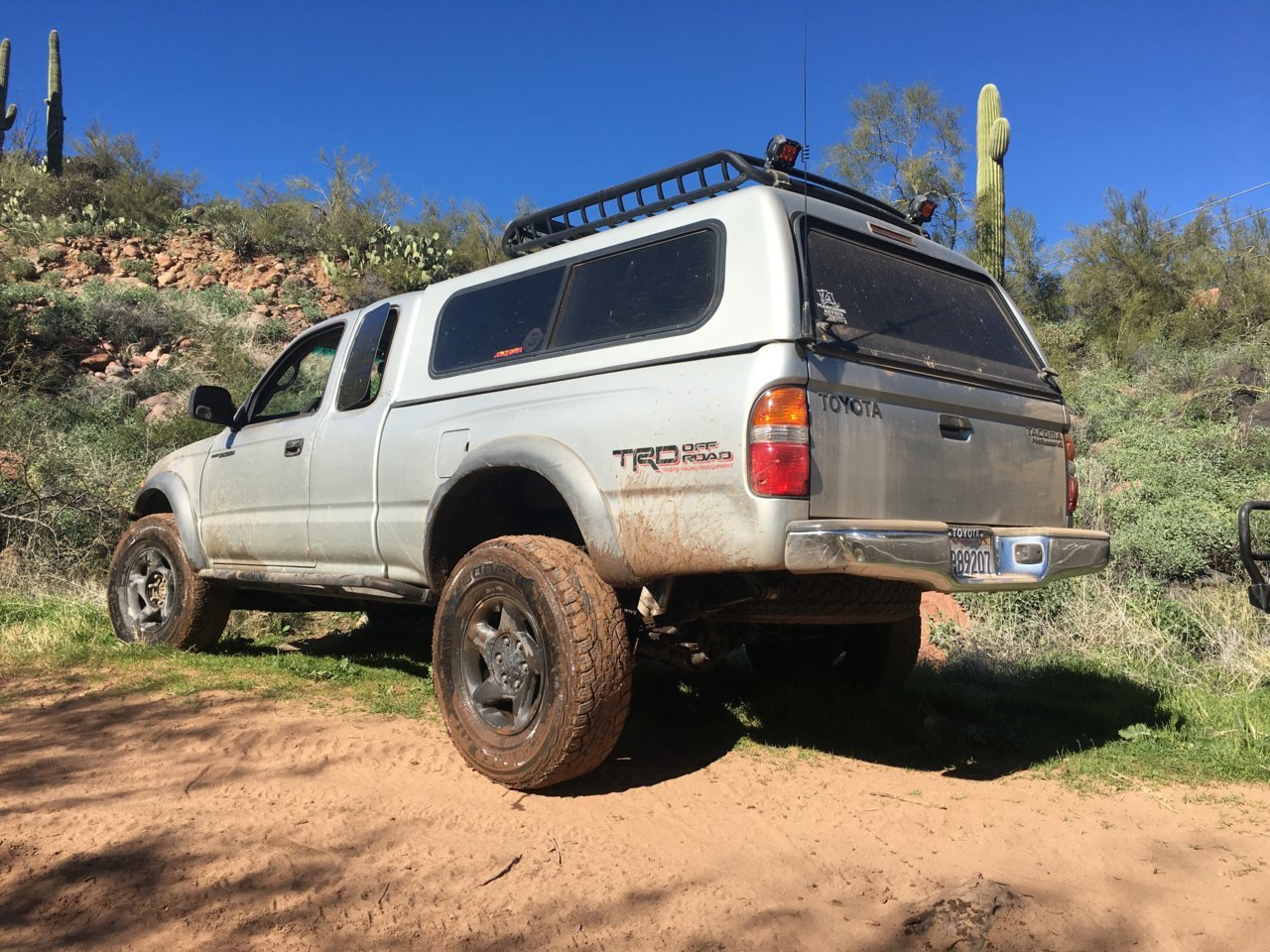

    Went camping over Friday night and did some exploring all day Saturday. Over 70 miles on rough, rocky trails. Made about 8 water crossings and saw a cool bridge. Now I gotta break out the shop vac because goddamn I got dust all over the cab

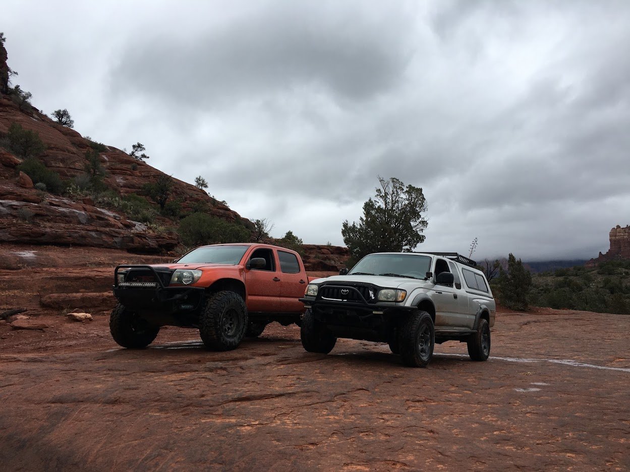

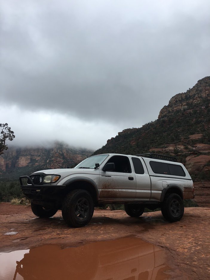

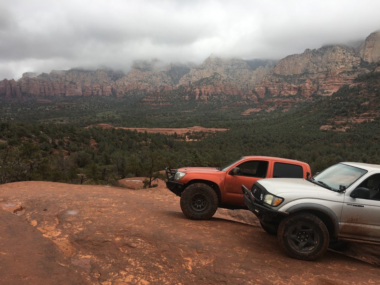

    Some pics from my trip up Broken Arrow today with @snowsk8air2. Any time I can put my 4wd conversion to work is a good day, had a blast in Sedona!

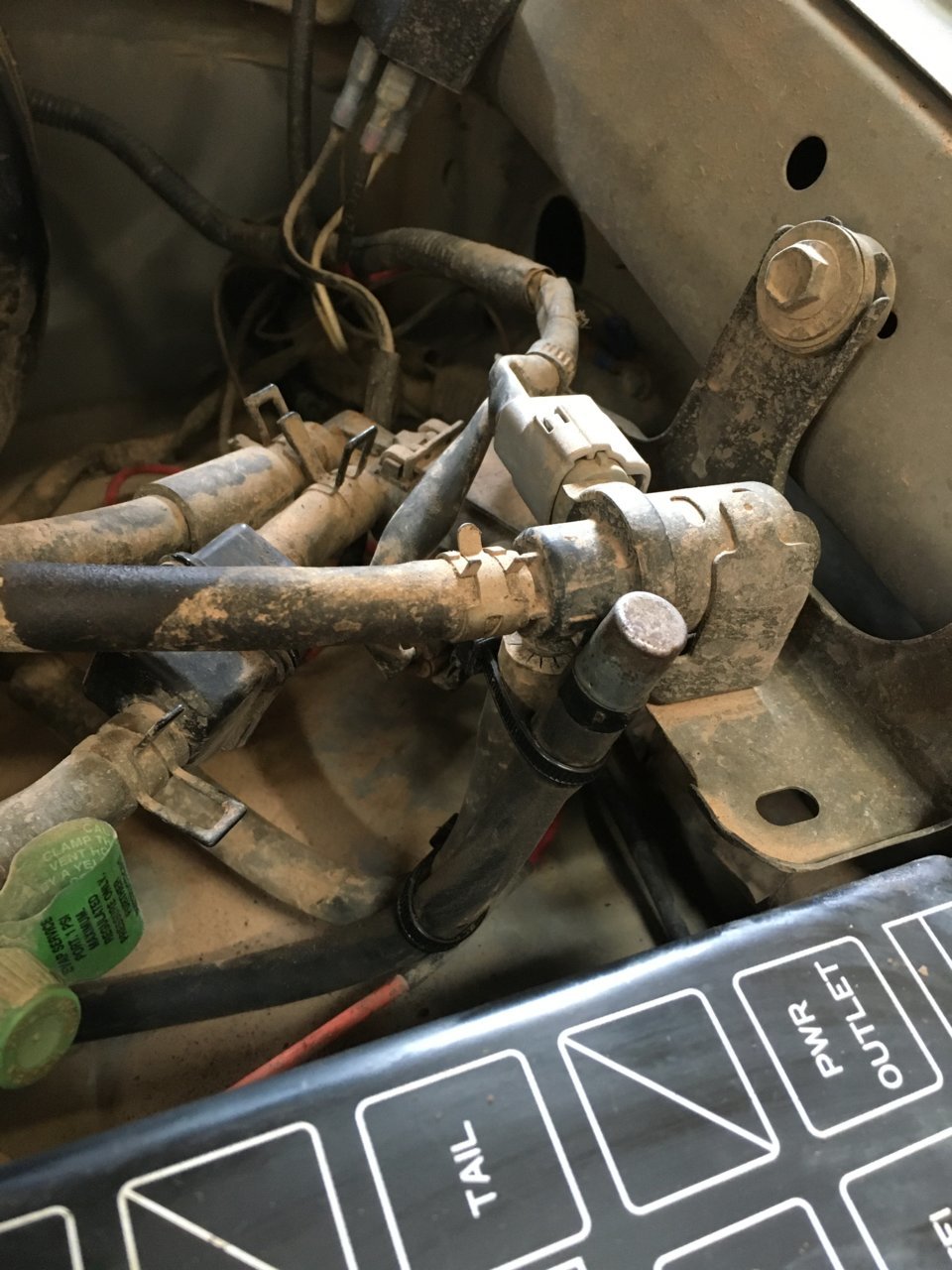

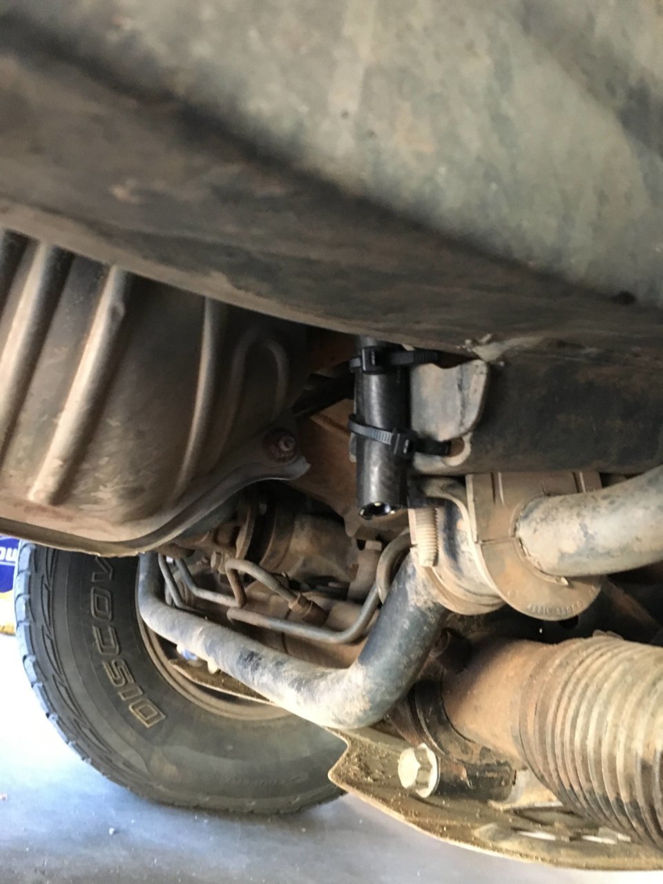

    Did some maintenance the other day. While I was at it, I extended the front diff breather way up to the top of the engine bay. Definitely got some water in there on my last camping trip

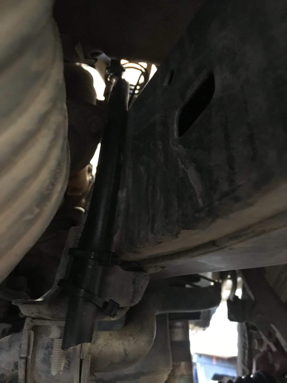

    Been doing a lot of sitting on my ass this summer, but here's some little shit that I did lately.

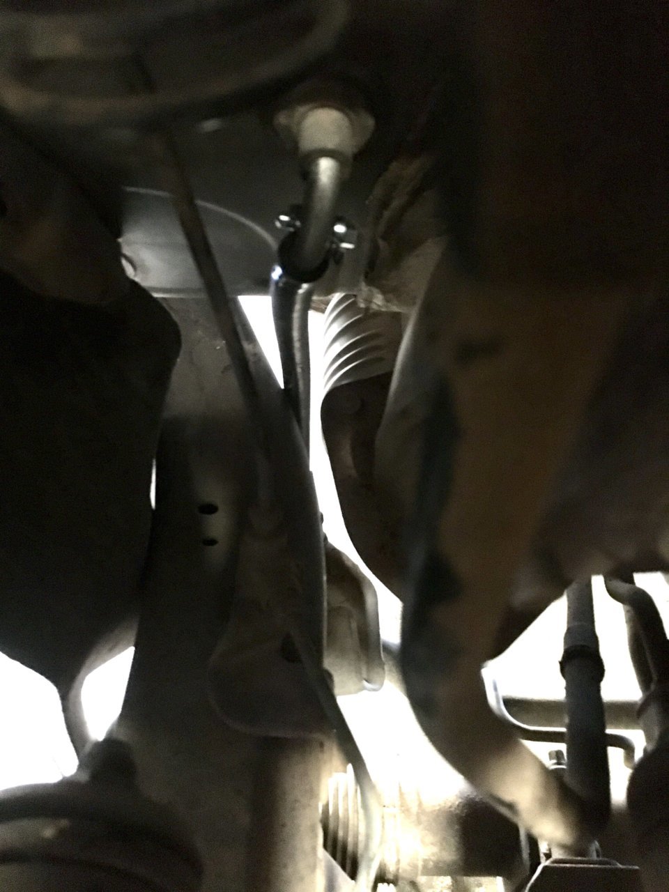

    Noticed that my AC condensation tube drips straight onto my frame and exhaust manifold, so I decided to extend the tube down past both. I wouldn't even call this a "mod" but it feels good having this on just for my own sanity.

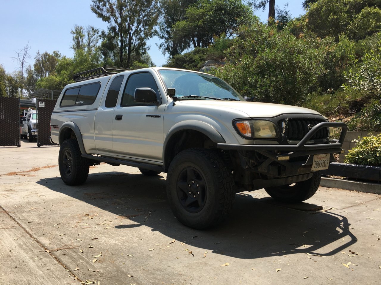

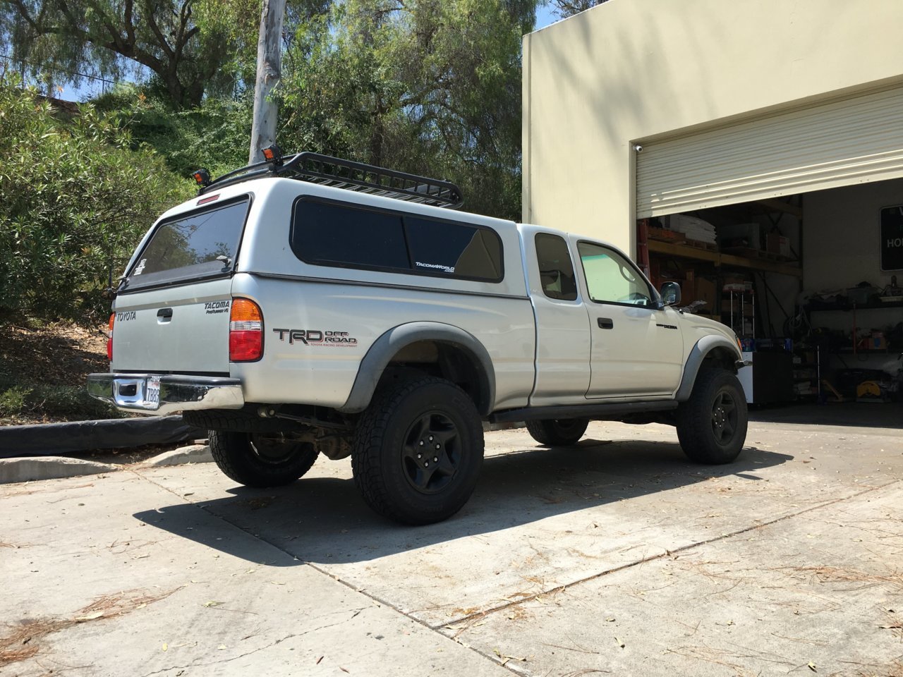

    Did some suspension work over the weekend. Now that my 881s have settled all the way, I moved the seat clip on my front shocks up a notch to level out the ride height. No more crazy stinkbug stance for the Taco! It's worth noting that the back end is still slightly higher, and that's intentional since it'll sag a bit when I'm loaded up with gear and supplies.
    Also replaced my outer tie rods since those were pretty worn out. Upper balljoints are getting replaced soon as well, since I don't really need UCAs and the balljoints that came on my manual hub spindles are starting to go.

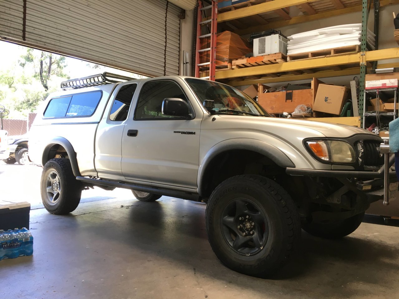

    Been busy as hell this summer but here's a quick rundown of some shit that happened this past month:

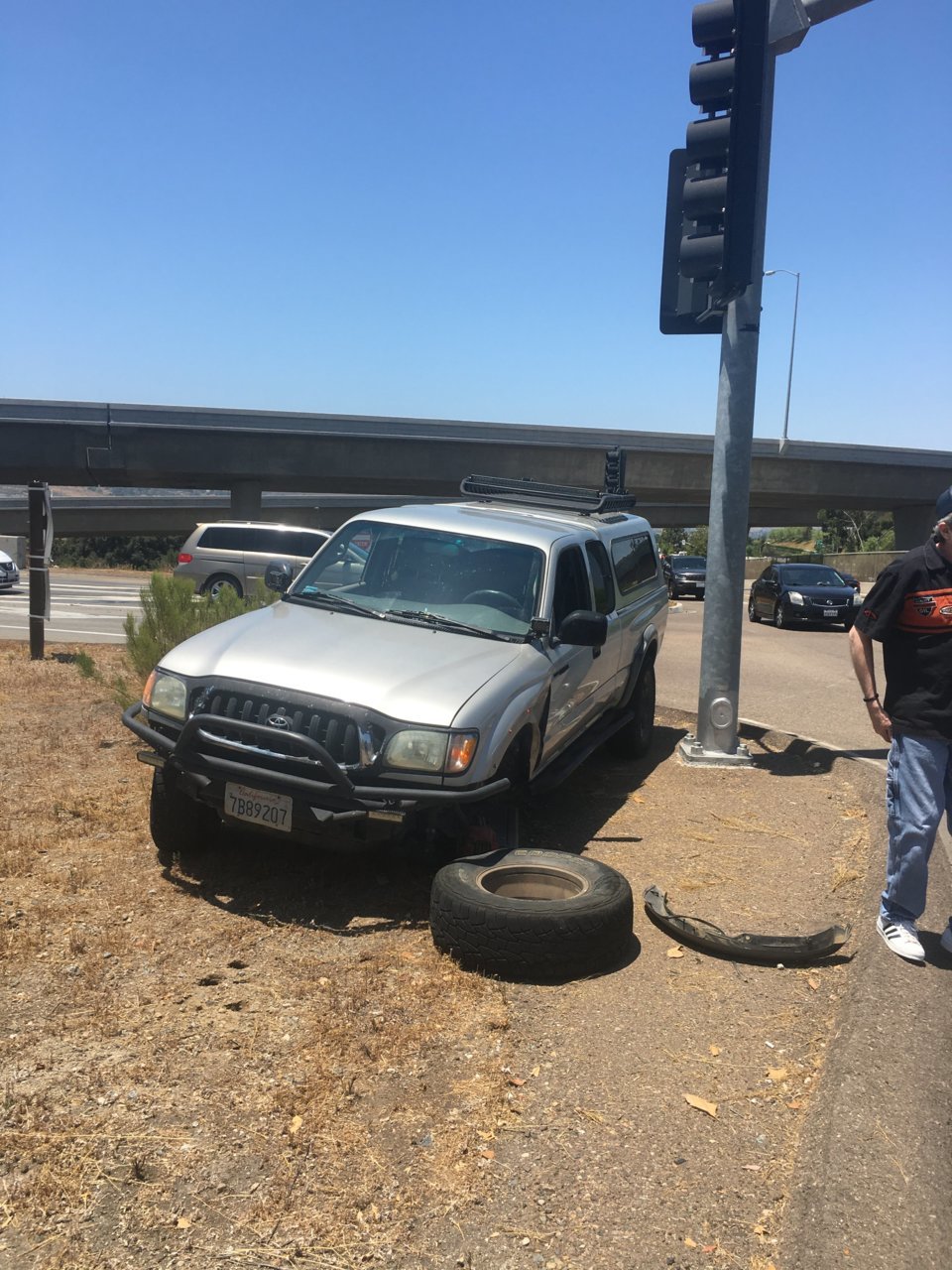

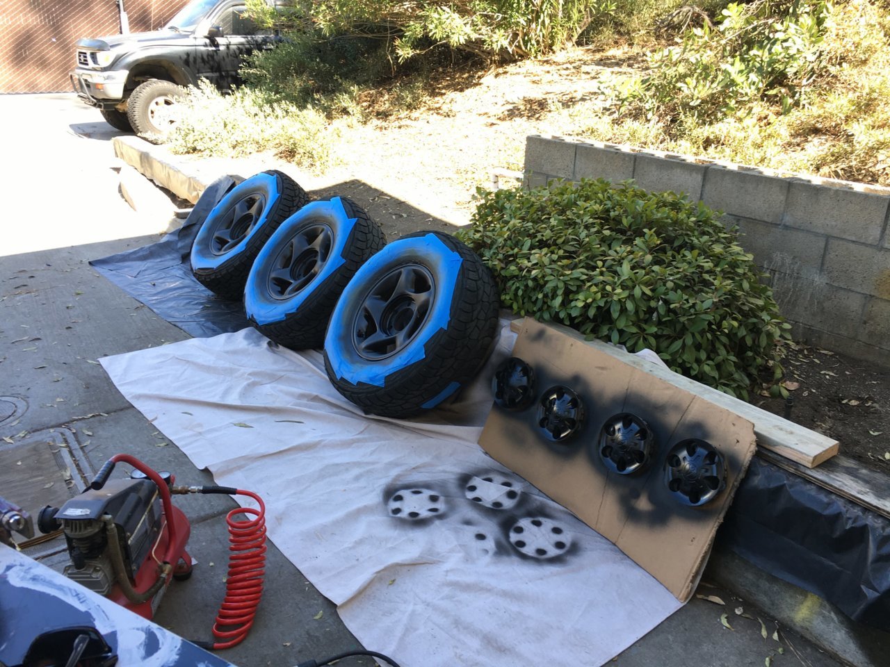

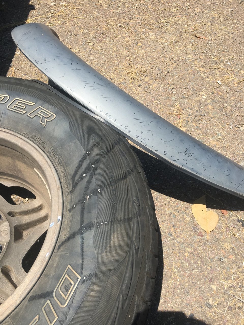

    Wheel fell off because I'm a dumbass and didn't tighten my lug nuts after leveling my suspension. All my balljoints and control arms are okay so I just needed a new wheel, tire, and fender, no biggie.
    Scored a wheel from @BrownMike, can't thank the guy enough for hooking me up.
    Got a set of two new tires, moved the good front tire onto the spare so now I have a matching spare.

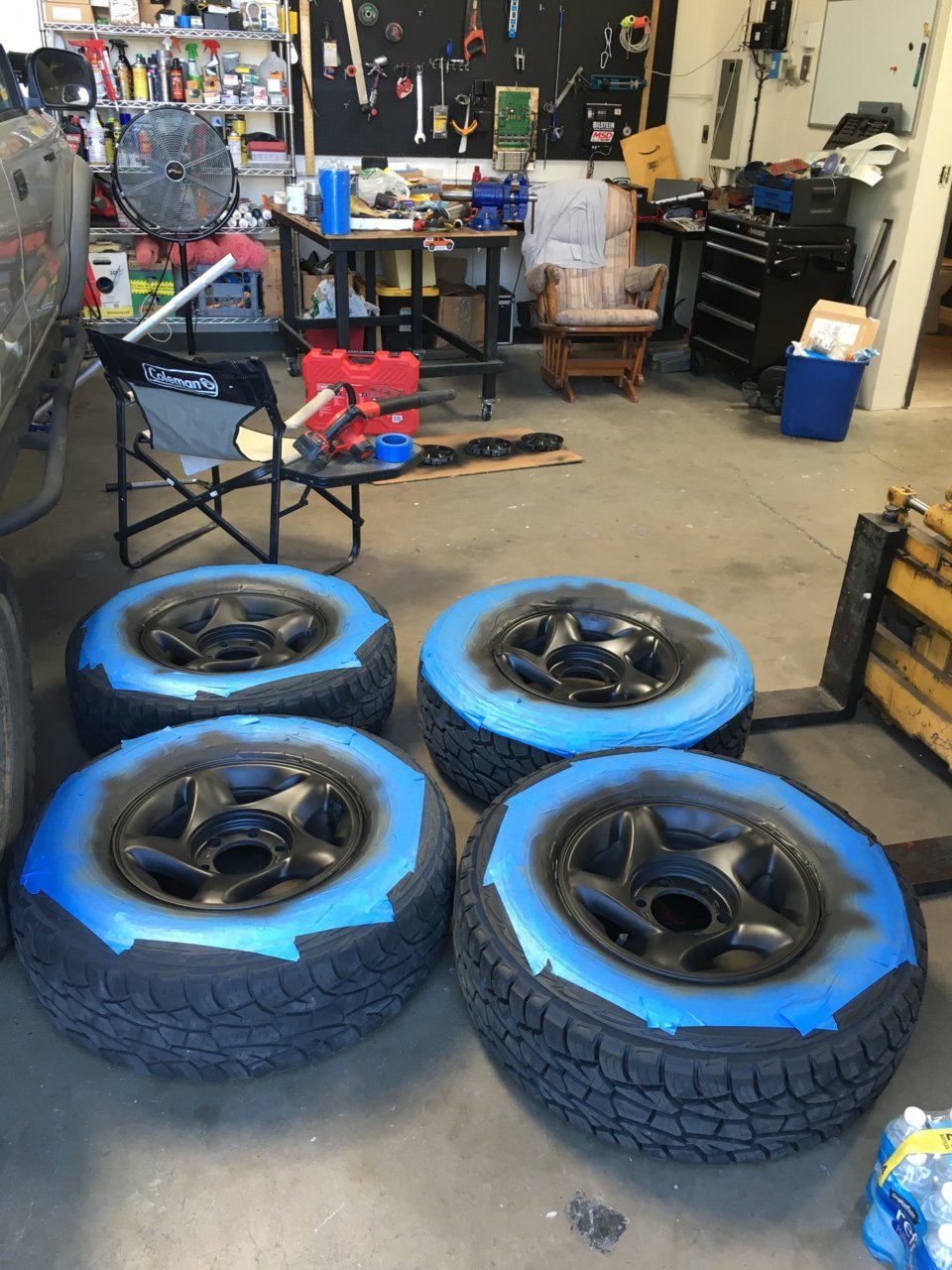

    Repainted all my wheels so things are looking pretty clean. Still needs a new driver-side fender, but i'm gonna see if I can't find one on my way through Phoenix next week.
