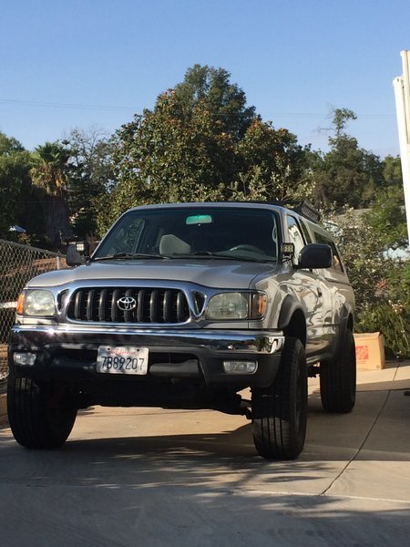

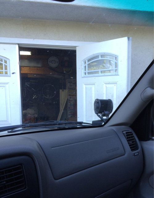

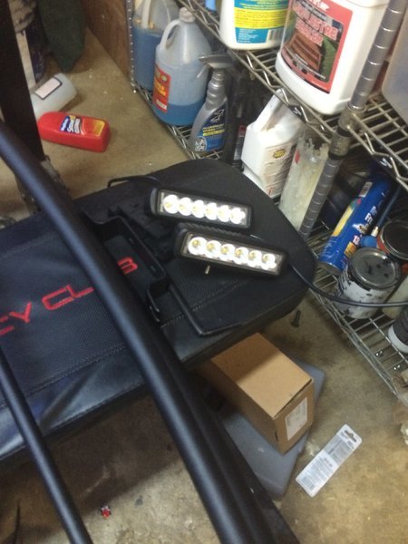

    Got those ditch lights mounted
    Digging the fit, the mounting points were a bitch to get to, but once they're on, they're flipping solid!

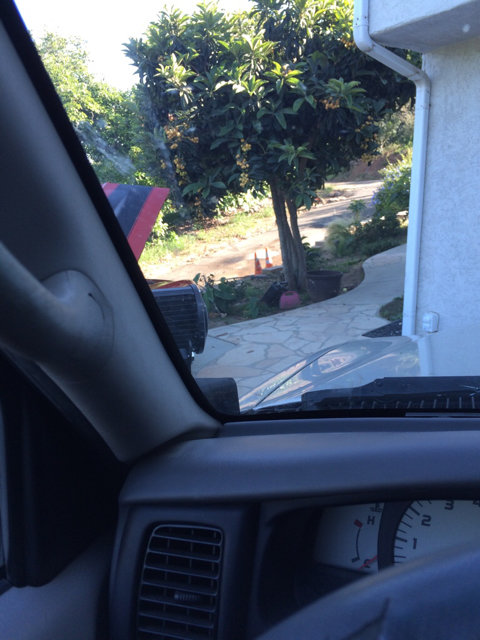

    Here's some views from the cab. The driver's side doesn't obscure anything, really. It's tucked pretty well behind the A-pillar.
    Passenger side sticks out quite a bit, but not much more obscuring than a snorkel would be.
    Now all I gotta do is wire 'em up!

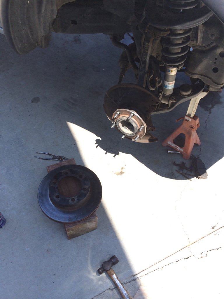

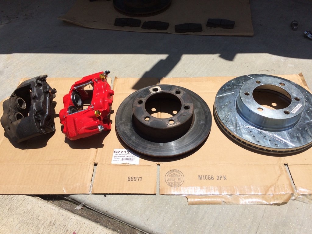

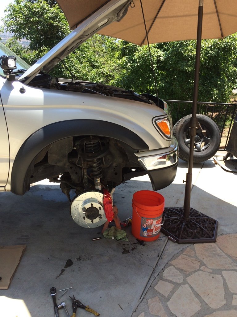

    Old vs New:
    New rotor and caliper test fit:
    eccracer104 and YotaGurlIAm like this.

    Damn, these things look friggin beefy! I love it!

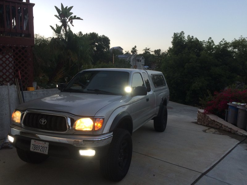

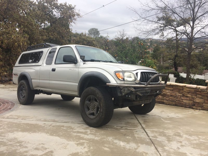

    image.jpg image.jpg Brakes and lights are all done! (Finally)

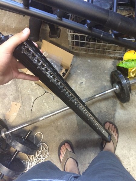

    Finger slipped
    Whoops

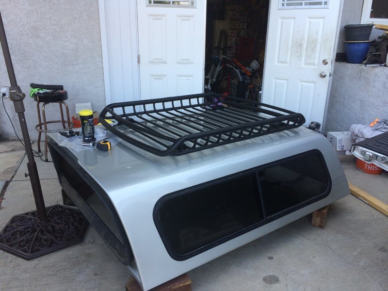

    If only I had a sort of rack or roof basket to mount these to...

    Got the rack on, still waiting on some mounting hardware for the lights though so I'll do that soon

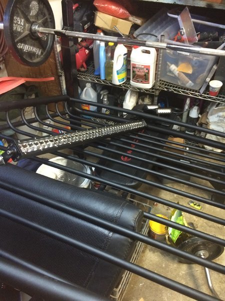

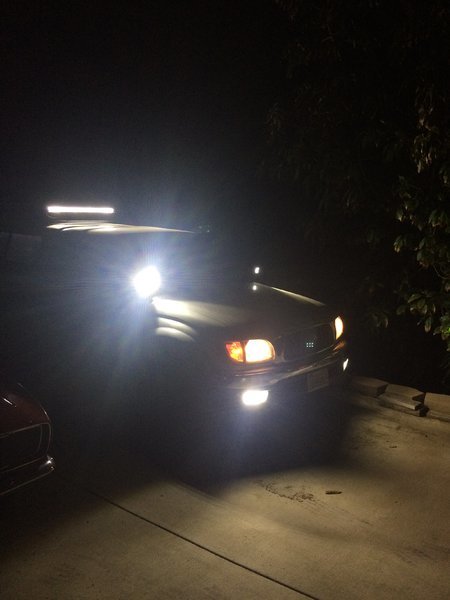

    Alright, so it's been a little bit since my last update with school being in full swing, but I've found some time to wire up all of my lights. So far, I have my front-facing 30" bar hooked up.
    It actually got wet on the inside after a car wash so I had to pull it open, dry it out, and rebuild it with silicone and glass sealant around the bezels and end caps.
    Next step is......more lights! I have some side-mounted floods that I want to put on (still thinking of how to mount them), and I also want to get a rear-facing amber pod and a rear-facing floodlight.

    How'd you mount the rack?
    How much weight can it handle?

    The basket is bolted through the shell using the existing brackets that it came with. I just used longer bolts and nuts instead of the hardware they gave me. Don't have a good picture but you can see some aluminum plates that hold the bottom of the hardware so they don't slip through their holes.
    On the roof I have the basket brackets sitting on some medium-density foam so it doesn't scratch. That also helps distribute the weight so the shell doesn't crack.

    The basket leaks a little bit, so I need to pull some of the bolts and go to town with the silicone sealant, but otherwise I like having it. I'd probably only trust to put 50lbs or so, though. I'll end up putting Jerry cans up there for fuel and water at some point

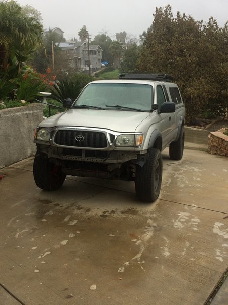

    Got the bumper pulled. I'll probably have it sitting for a bit though until the rain stops in a couple days

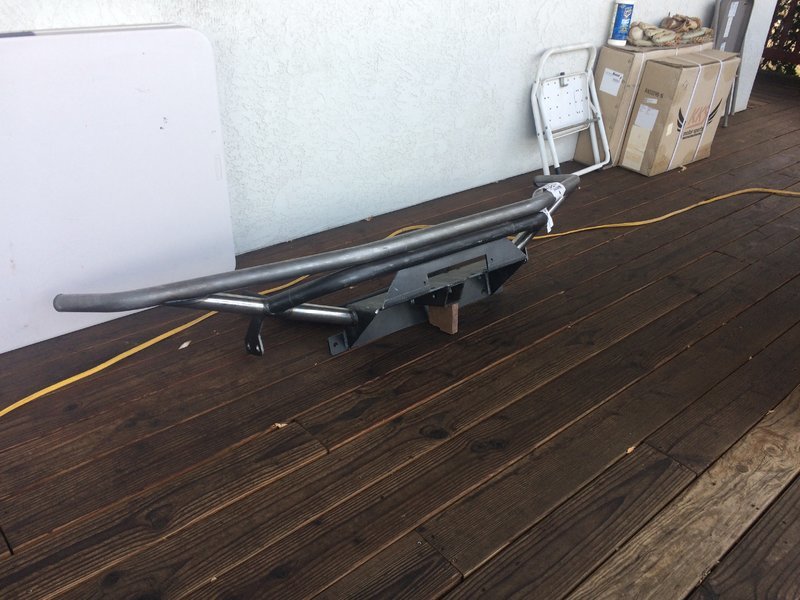

    Did some test-fitting today. Tacked the nerf bar on and made sure everything lined up and fit right.
    Tomorrow I'll be finishing up my welding with some tabs to mount some lights to, and then I'll bring it to a buddy's shop to have it welded proper. After that it's just a matter of painting it and mounting it for real!

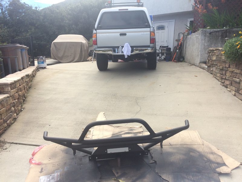

    Got the bumper painted up with dupli-color spray-on bedliner
