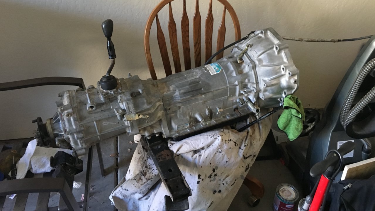

    I don't believe they exclusively used the push button shifters after 2000 but I could be wrong.
    Either way this transmission that I have isn't the correct one as it has a mechanical throttle valve cable instead of electronic (they made that change in '03) so I'll need to do some part swapping between the two transmissions.
    If your concern is the transfer case mounting up, the one I have is already mated to the transmission if that answers your question.

    My new transmission does not have the electronic throttle system so I'll be swapping either the throttle solenoid or the output shaft (the former hasn't been done before but I'll be taking a look at that since just swapping the cable is a lot less invasive)
    I figure I'll end up doing the tail housing and output shaft, though. Either way I'm confident in my skills as a mechanic to do it since I've taken apart my Camaro's turbo 300 transmission three too many times

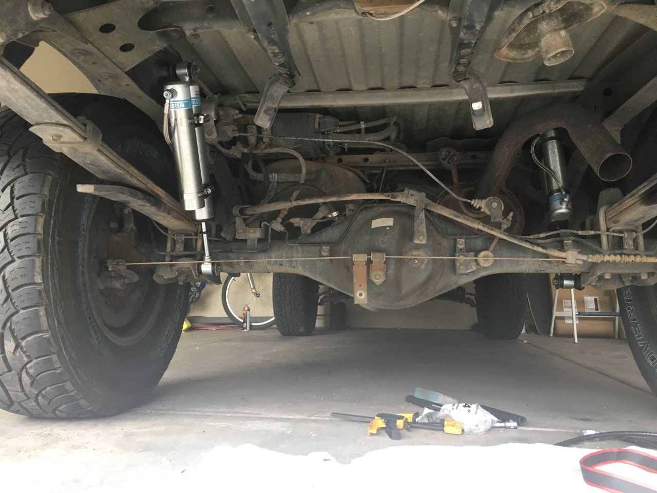

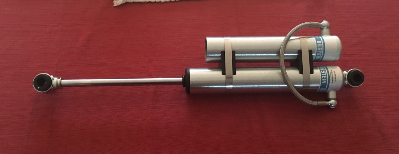

    New shocks are in
    Assembled
    And they're on!

    Took them for a drive on a pretty washboard-y road to break them in and see how they do. Felt great and my rear doesn't hop all over the place like it used to!

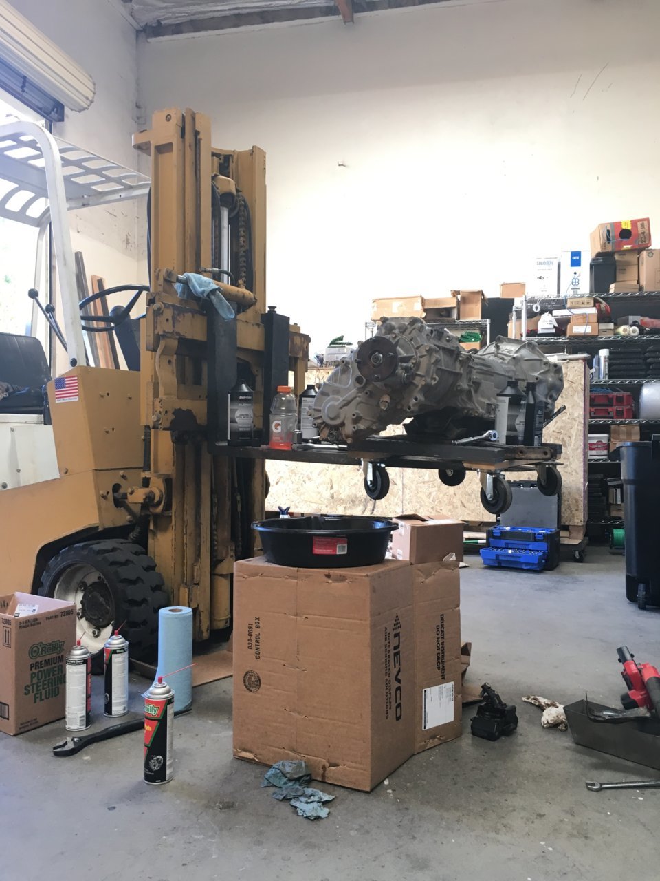

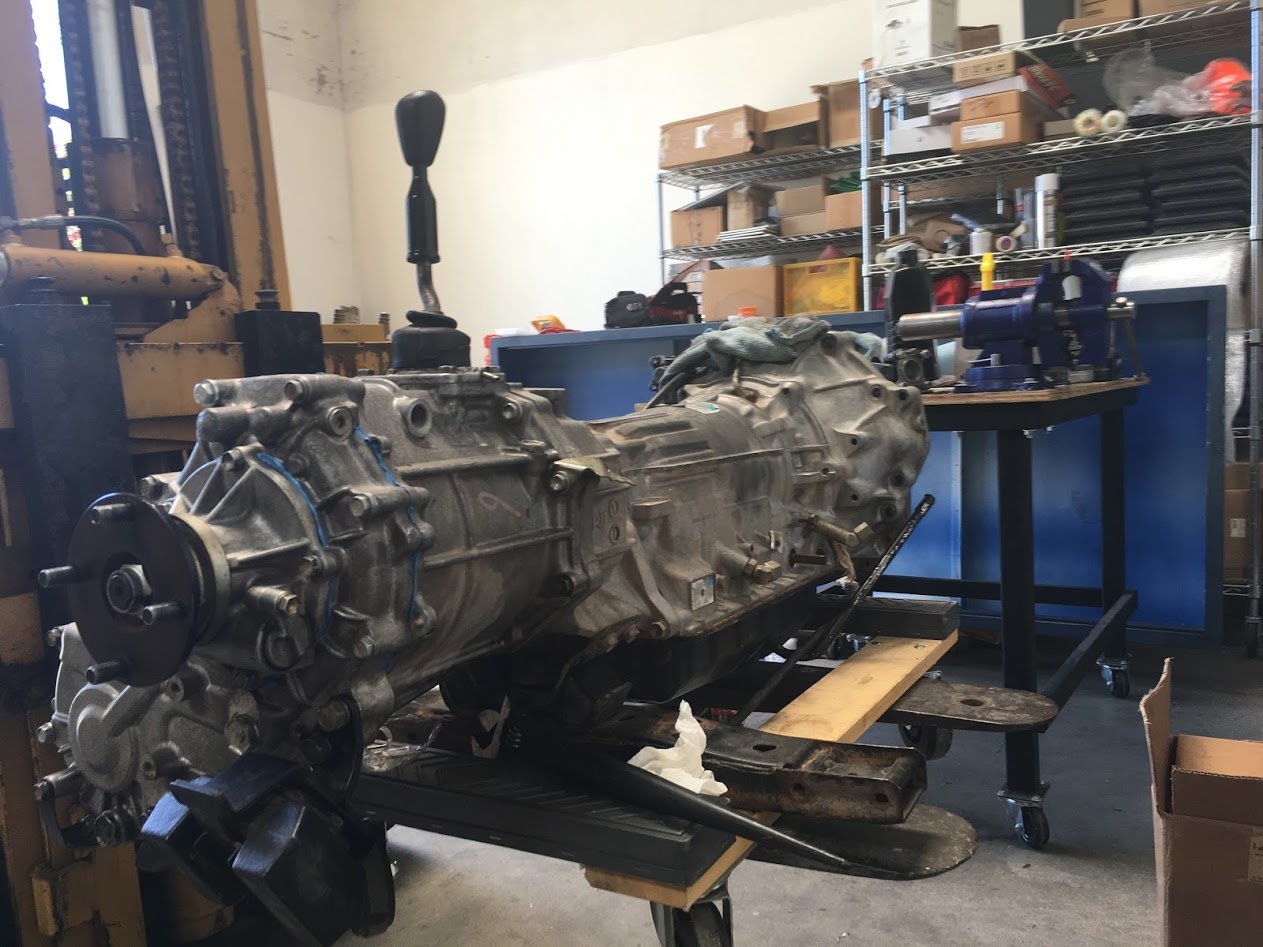

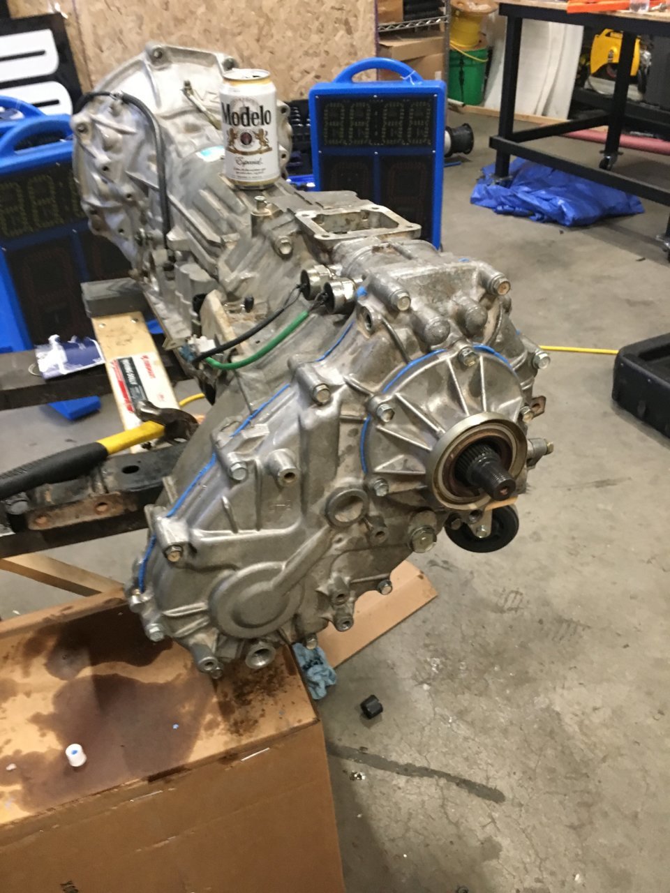

    Update on the conversion:

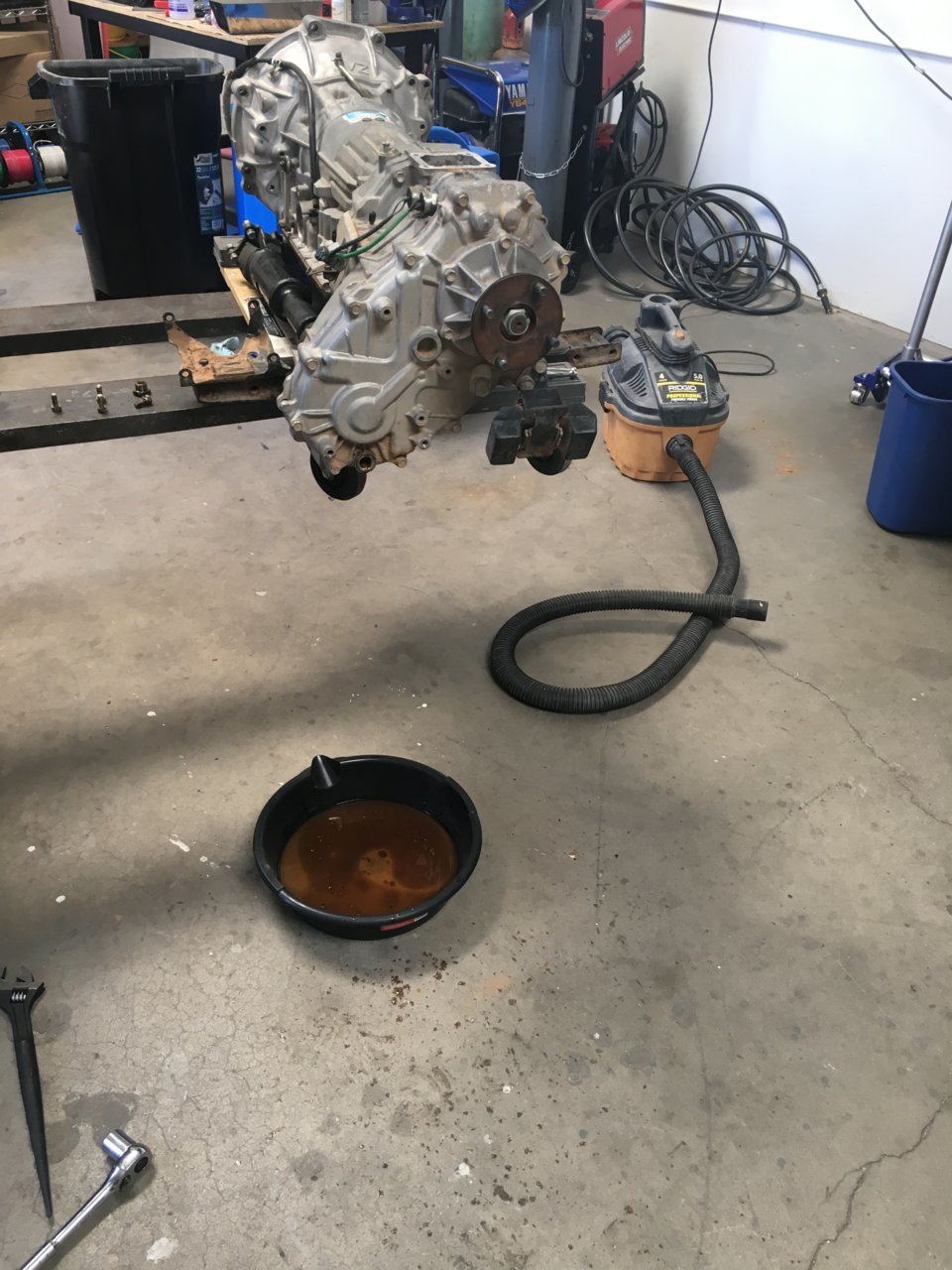

    I figured I'd change the fluid in the transfer case because it's always kind of a crap shoot buying used like this. Lo and behold, the thing was filled with about a half pint of water plus a bit of residual gear oil.
    Tried flushing it a couple times until it ran clear. No dice; it was rusted to hell and I kept getting more and more no matter how much cleaning fluid I was pouring through it.
    The next day I let it soak with some low-weight motor oil to get everything loose and try to flush it a couple more times. Still no good.

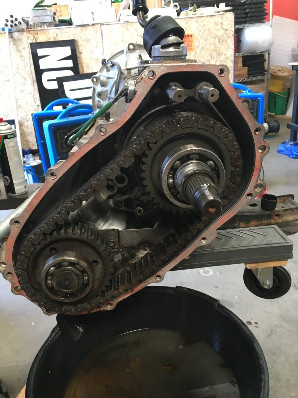

    So I just decided to open it up and take a look at the damage.
    Ended the day with some pretty good progress. Wish I got a picture from after I cleaned the internals, but 4 cans of brake cleaner and countless blue shop towels did the trick and it was shining like a pearl when I was done! The rear bearing on the front output shaft was also so gritty it wouldn't even turn, so I'm very happy I cracked it open!
    Anyways it's sitting in the shop with some RTV curing up overnight, and I'm gonna button it back up tomorrow after work

    ffhSwgP8m_KeJ7wteMrGhFrxY39ODLS6jU0mY4-n_d4aae29963b87bee2ce1a6f47f30dc8654152bf4.jpg
    Little update: transfer case is all buttoned up and ready to go. Snapped a bolt so I had to look around town for a replacement and now she's all ready to go into the truck. Just gotta see if I can't borrow a transmission jack from someone named @erice :spy:
