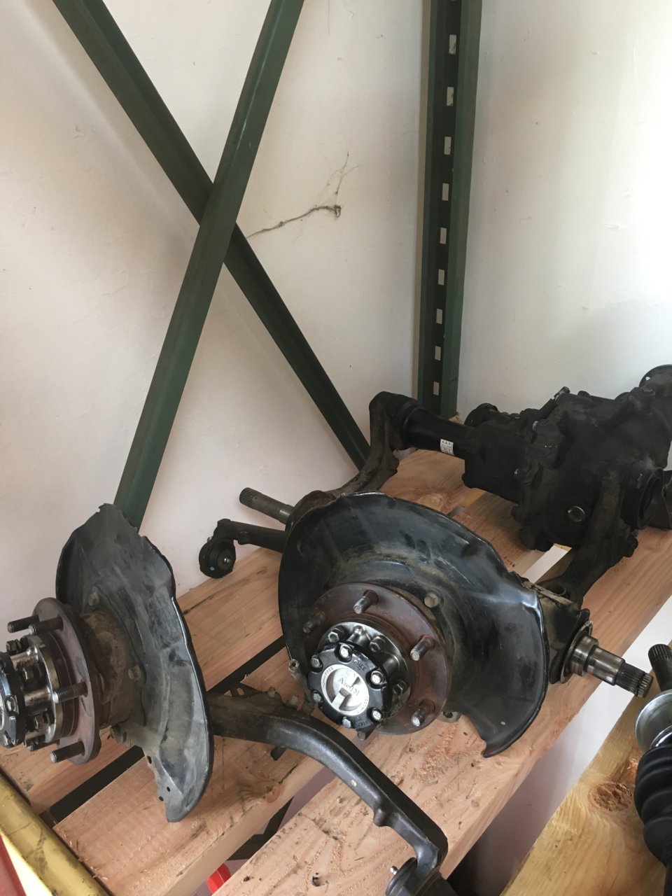

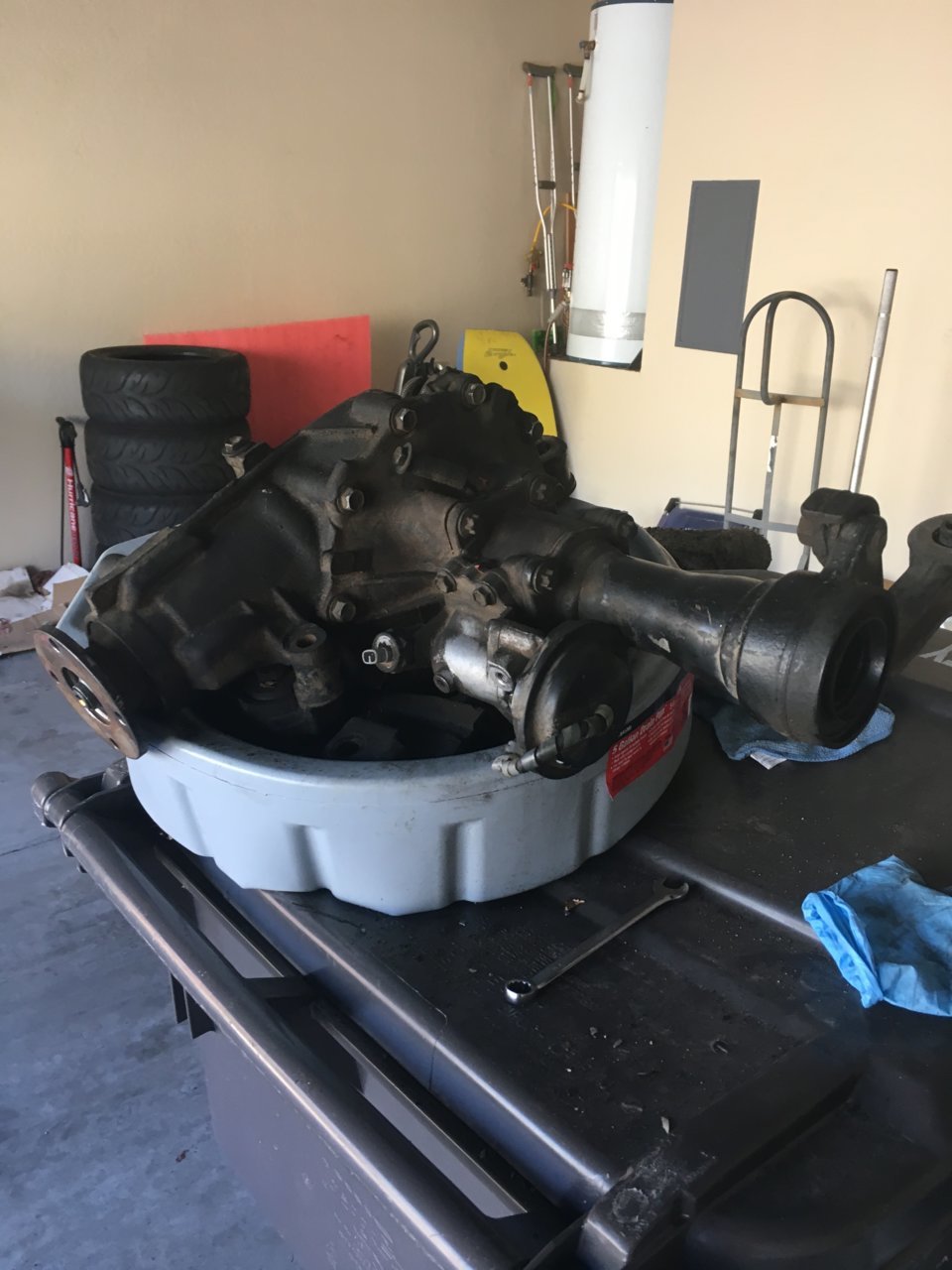

    Picked up a front diff for the conversion as well as the speed sensor that I was missing.
    Only issue is that this is an ADD diff, whereas I plan to go to manual hubs. Luckily I know of a couple tricks to keep it locked, or I can swap the locking mechanism with one from a manual hub differential. Either way, once I'm back in San Diego for winter break I'll be getting in some more progress.

    How do you plan on locking your actuator? I decided I'm probably not spending $140 on a non ADD tube.

    I was going to look for a non ADD tube, but if I can't find one then I'll probably tear it open to see what I can do. I'll probably end up breaking out the welder, but we'll see how things go
    Should've worded it as "I'll find some trick to keep it locked" lol

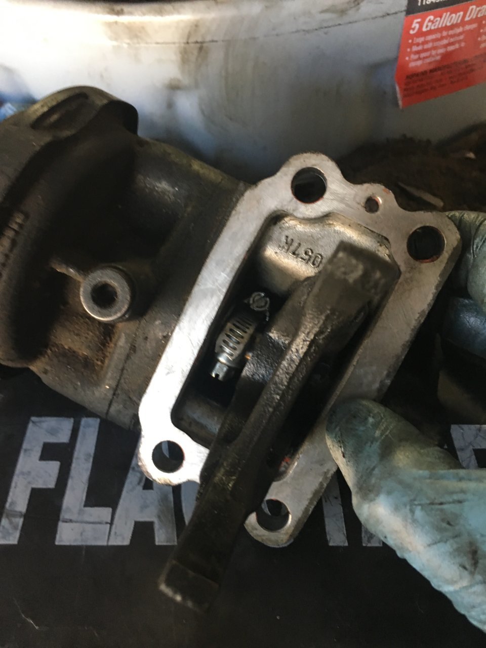

    Did a bit of snooping around and stumbled across this write-up that fixes the issue by blocking the engagement fork with a hose clamp. Pretty straightforward solution, we'll see how it goes.

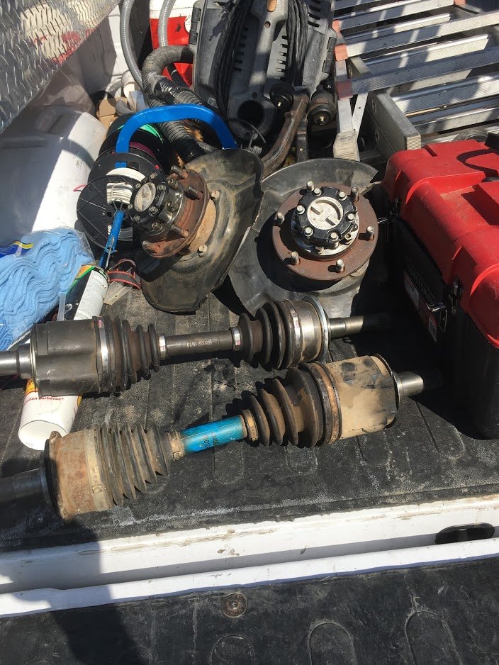

    Big day today! Got the last of the parts for the swap. Manual hubs/spindles and manual hub-fitting CV axles. The only bad news here is that I won't be able to install them for another two months until I get back to my truck when I go back to San Diego in mid-December. The plan then is to do the hose clamp trick on my new diff, press the hubs into my old spindles (that way I keep my ABS and don't get an annoying ABS light), and mount everything into place. The last parts I really need are the diff carrier bolts, but I'm thinking of just shelling out for them at Toyota. I'm really excited to have all the parts and I can't wait to get home so I can finish my conversion!

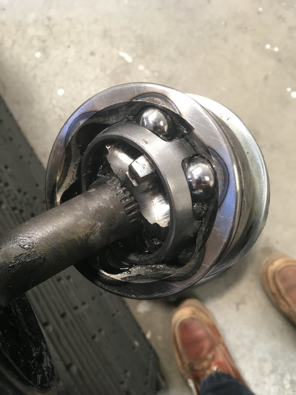

    So the newer-looking axle has some issues. I could barely move the joints around when I got home with them, and they look like they’ve been run without grease for a while, and seized.
    So the plan now is to buy two new axles — probably some O'Reilly’s specials, nothing fancy — and use the good axle as a spare to keep in my growing “emergency parts” bin to take wheeling just in case.

    I ate the cost and sent my two damaged ADD axles to CVJ in Denver as core for some manual hub cvs. Of course nothing beats O’Reillys price and you’ll have an OEM spare like you said.

    yeah I thought of having them rebuilt, but I figure between the time and money I'd be fine getting some cheapo axles
    Luckily they're only spinning with the hubs engaged unlike ADD where they're always spinning, so they'll have a relatively long life either way

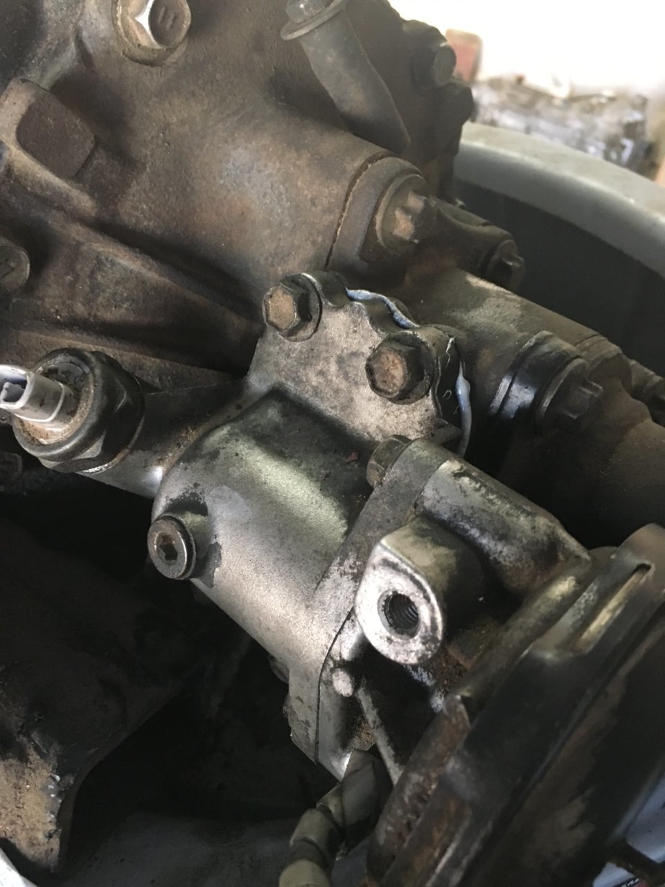

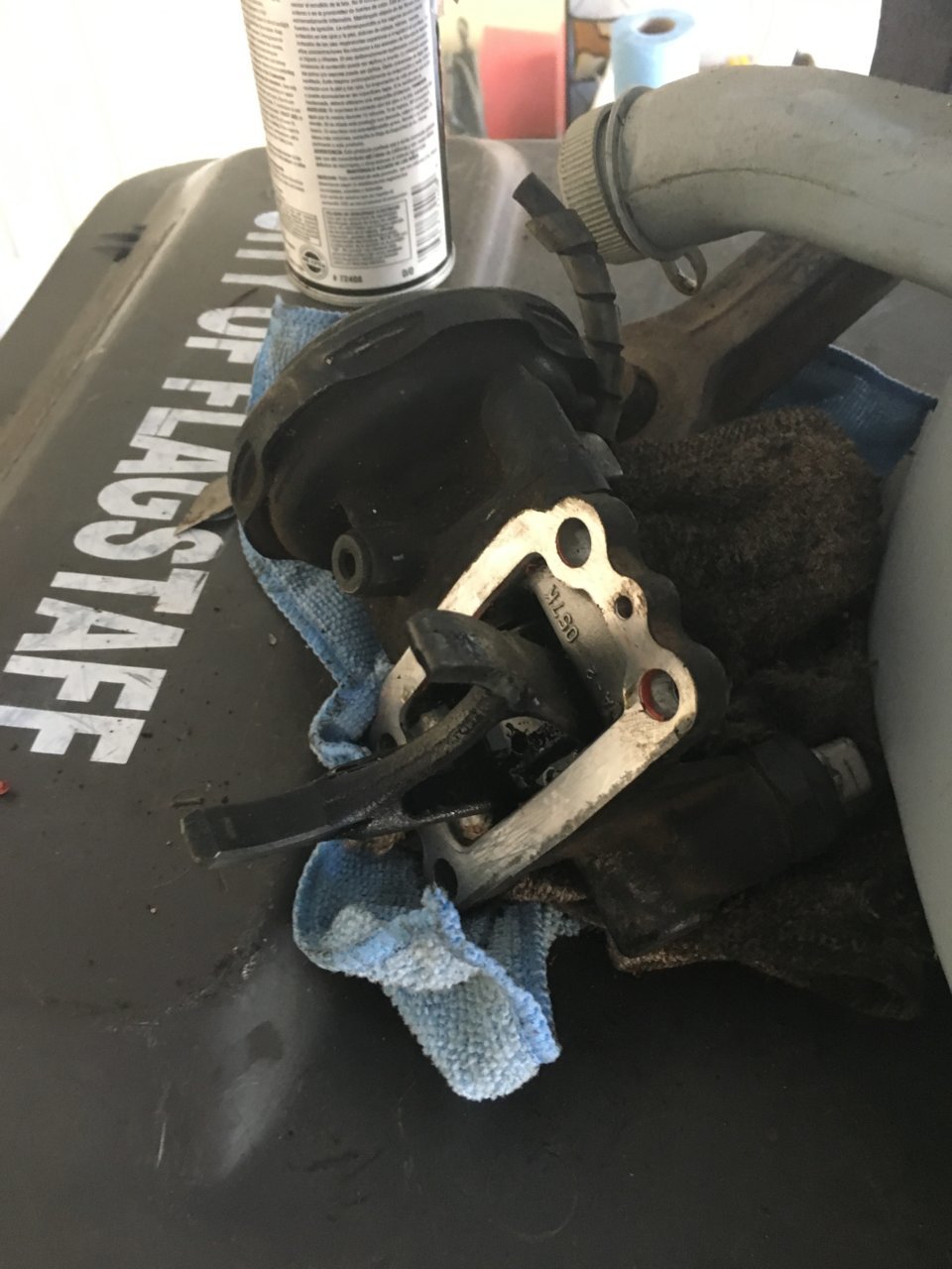

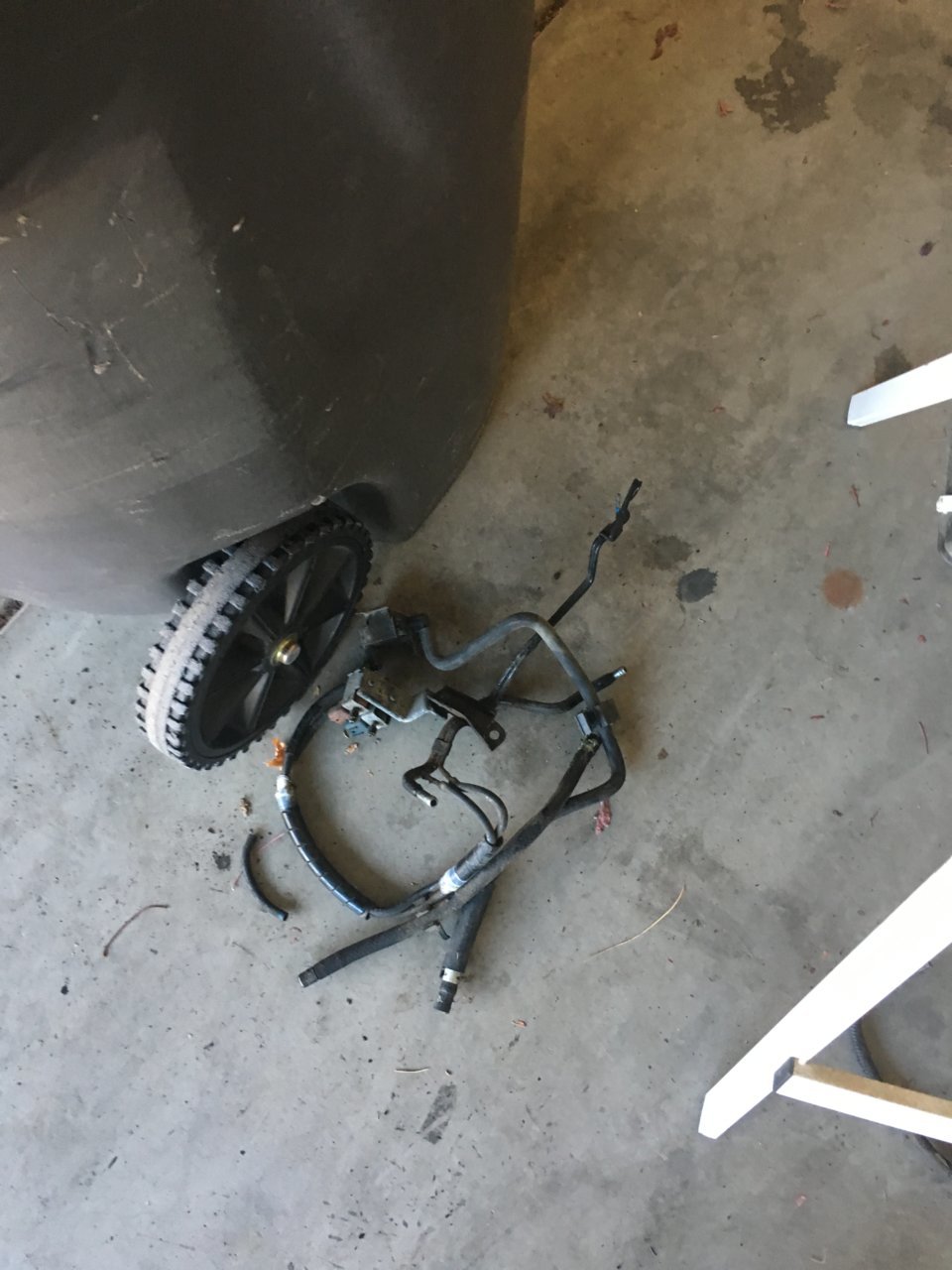

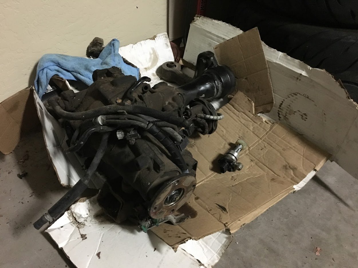

    Got bored today, and since I’m still 400 miles away from the Tacoma, I decided to prep my diff so it’s all ready for when I come home from school.
    Cleaned some of the grime off (not all of it, but a good bit), removed the wiring and vacuum lines, and locked my actuator so that i can use it with my manual hubs
    A3FD38C6-A35E-4B45-9F16-194306467ED6.jpg 46E22753-8584-428D-A4E4-FA783A697D45.jpg 794F7FF3-6CA0-44A0-A54B-28A7F2BA3364.jpg 14C78B90-7F33-45F9-977A-D2934CA14825.jpg
    Made sure to test the diff with the locked actuator before I buttoned everything back up, and it’s good to go!
