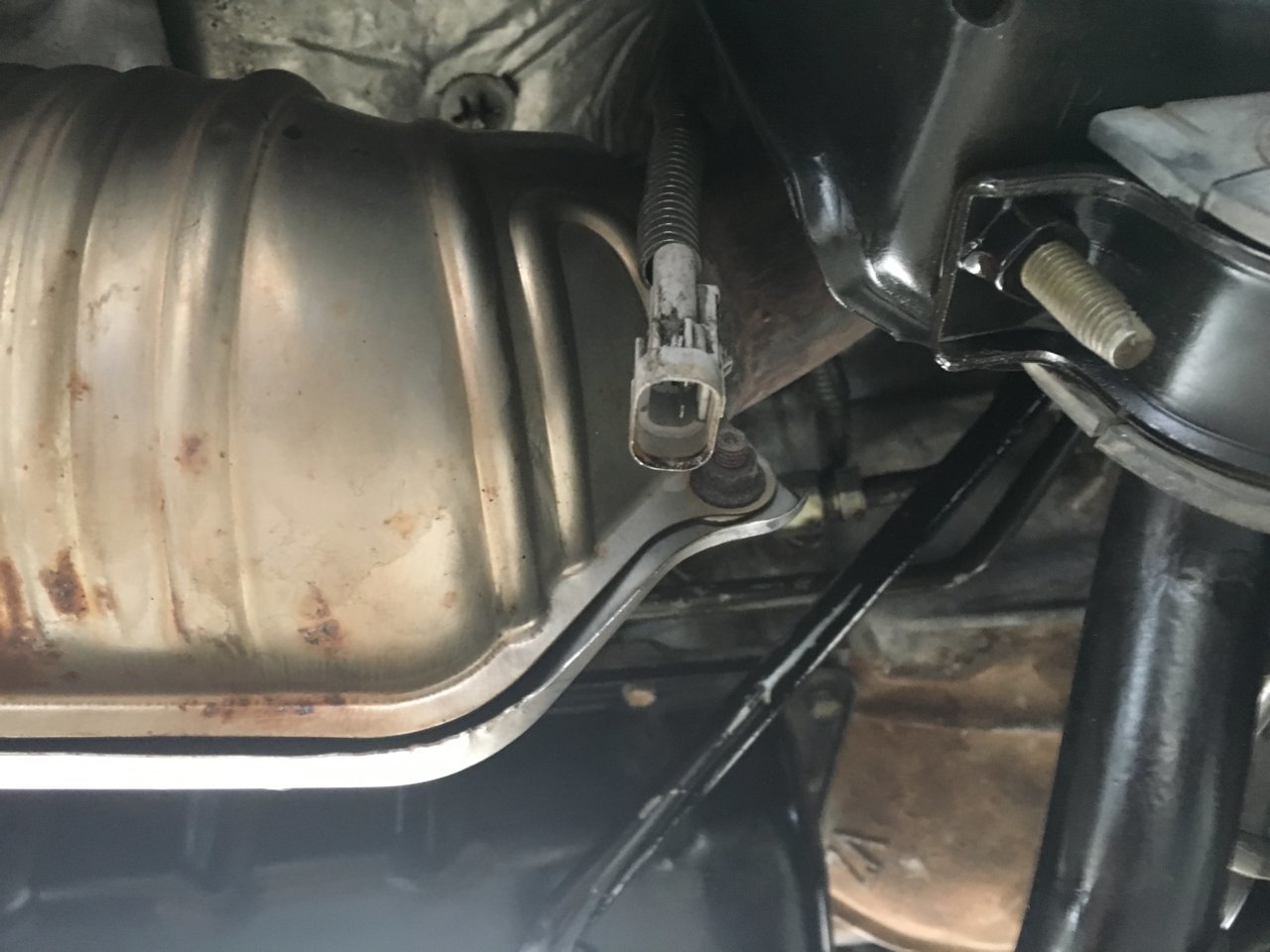

    Damn okay so I think I found my problem

    Is that the trans temp plug?

    Yep lmao

    Guess you're good to go then. Glad it wasn't something serious.

    Yep! I got the sensor connected and I've been driving around all day with no trouble codes and no transmission issues. That's pretty exciting because this proves that 03-04 owners can swap in a 96-02 transmission and it will still work so long as they swap the valve bodies and keep their original torque converters. Pretty cool stuff!

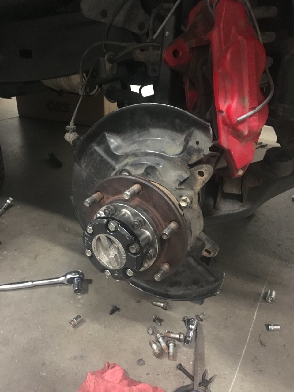

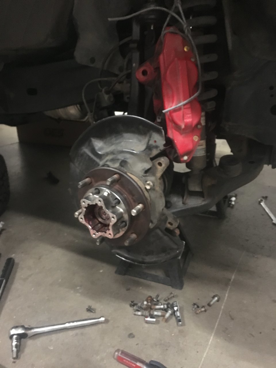

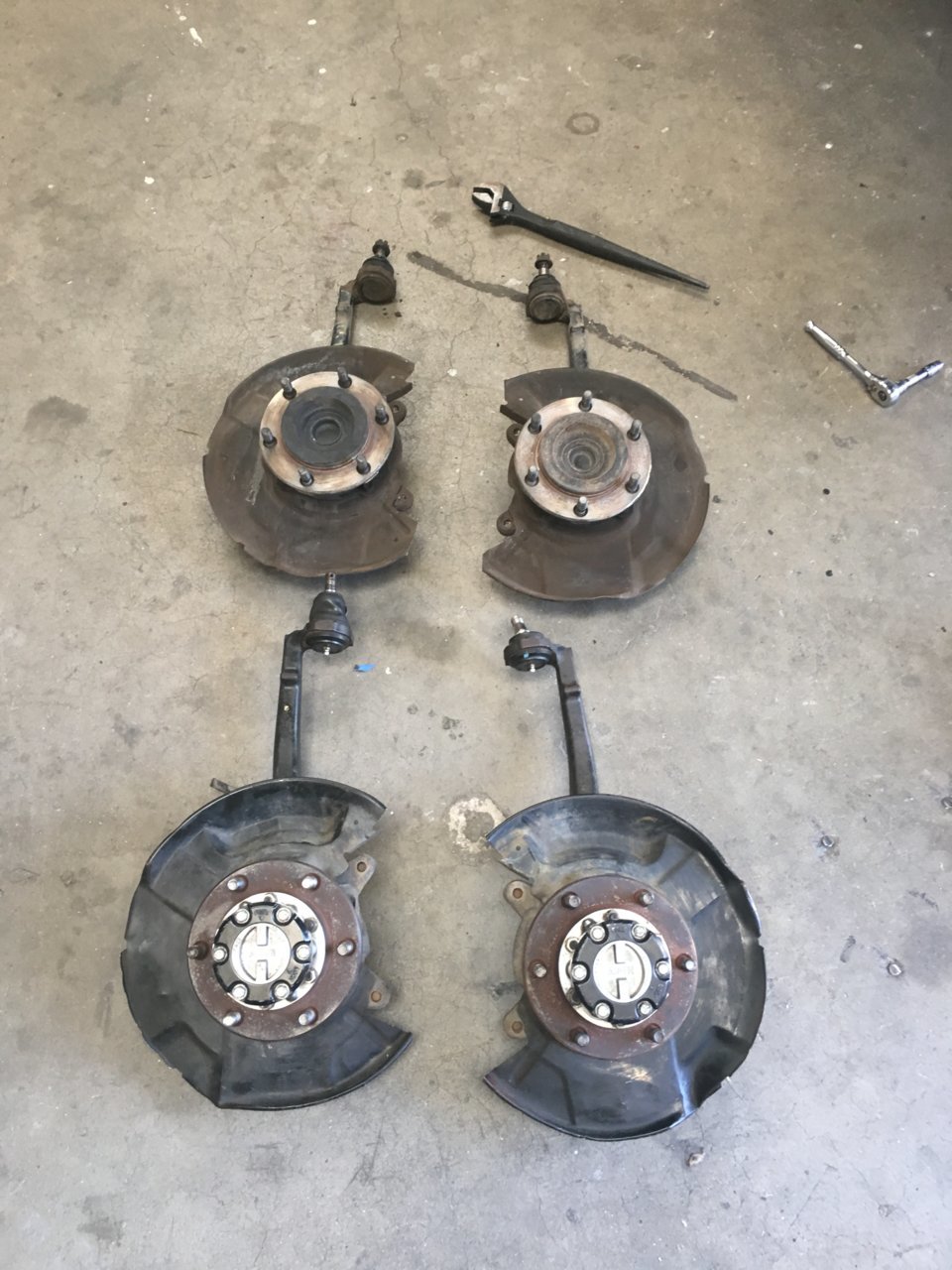

  13. Dec 28, 2018 at 6:48 PM
    #173
    Lfaub03
    Lfaub03 [OP] 4wd wannabe
    Feb 15, 2015
    #148762
    1,138
    Logan
    Flagstaff, AZ
    2003 Prerunner TRD
    4wd conversion

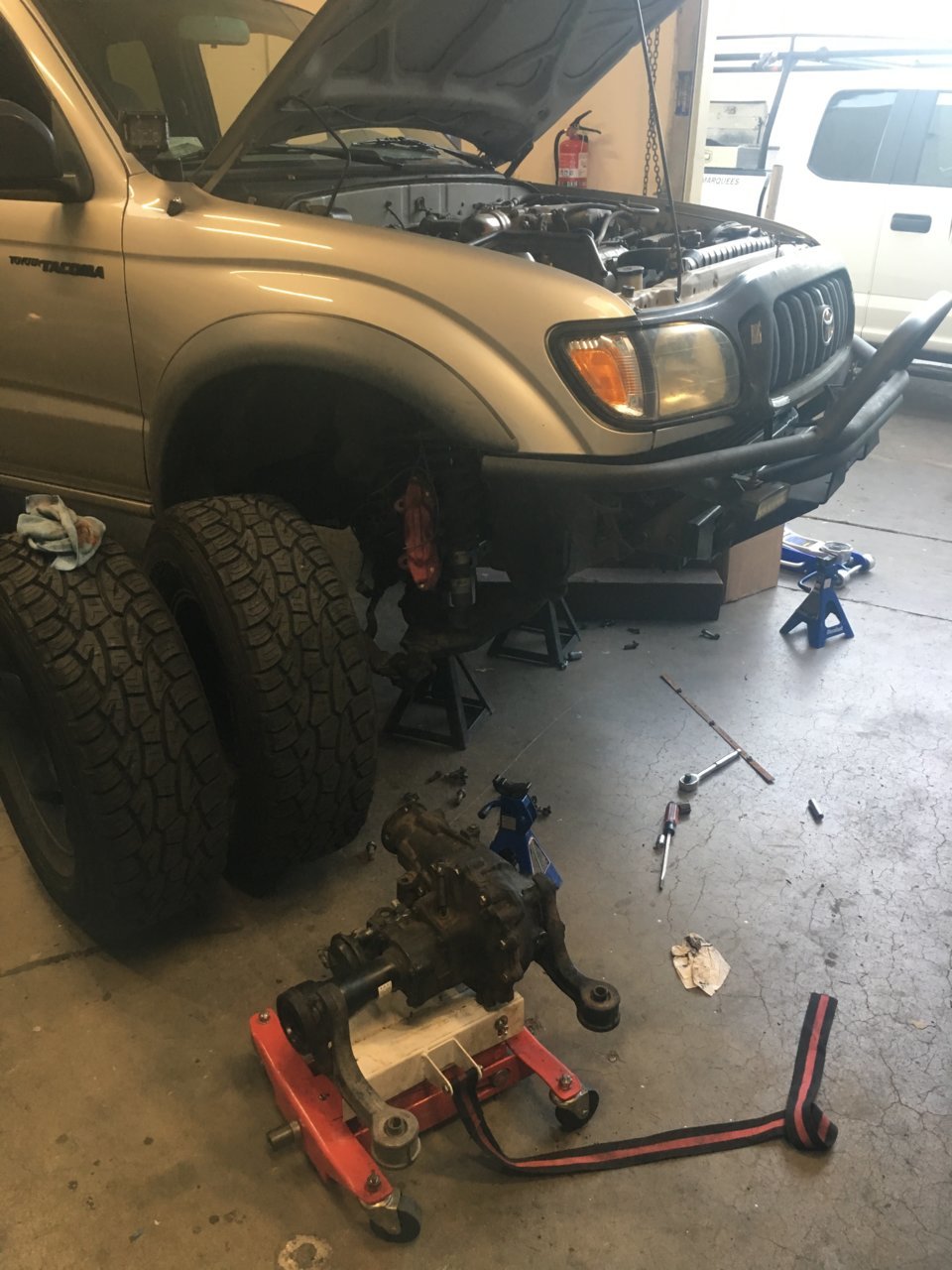

    Bit of a status update from yesterday since I forgot I took some pictures:
    Got the 2wd spindles removed
    Here’s the 2wd spindles and 4wd knuckles next to each other, I’ll have to trim the dust shields on the new knuckles since they won’t clear my larger brakes as-is
    So the truck’s still sitting, and all I’m doing is waiting on parts still, although if the FedEx tracker is correct I’ll have my new axles by the end of tomorrow. Gotta get the diff hardware in before I can install anything, though
    04Pre_Runner likes this.

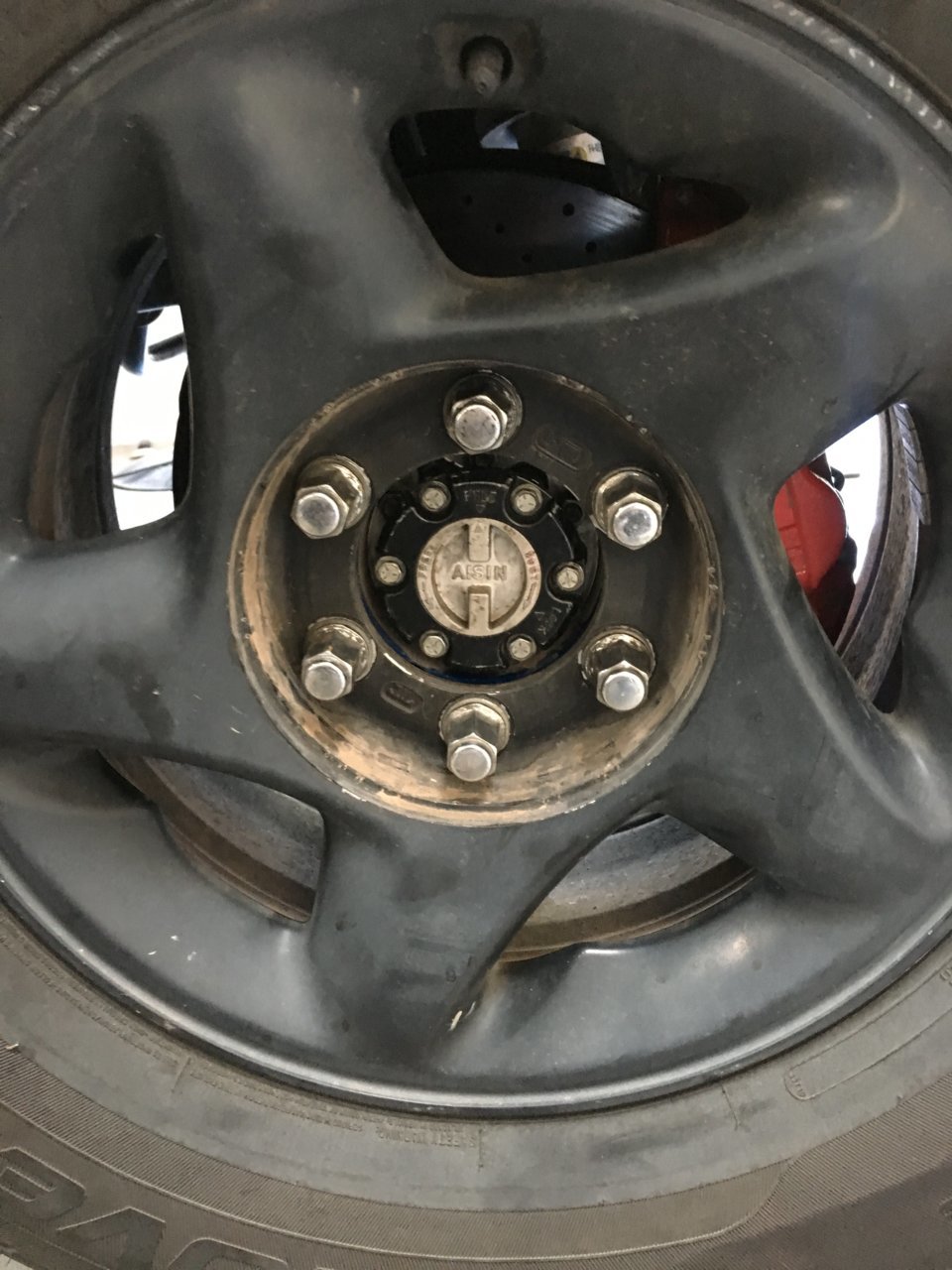

    Progress today: all my hardware came in! Which means shit got done finally
    Don’t have any pictures, but I got the diff hung, and that was a bitch. Couldn’t get it over the crossmember without binding on the transmission bell housing, so I had to take off the rear diff mount and re-attach it in place which sucked.
    Once the diff was in I got the axles stabbed without (completely) breaking anything in the process. After that I was only able to get one knuckle on after several trips back and forth to the hardware store.
    Was also able to grease up the hub lockers and now they engage super easy compared to before.

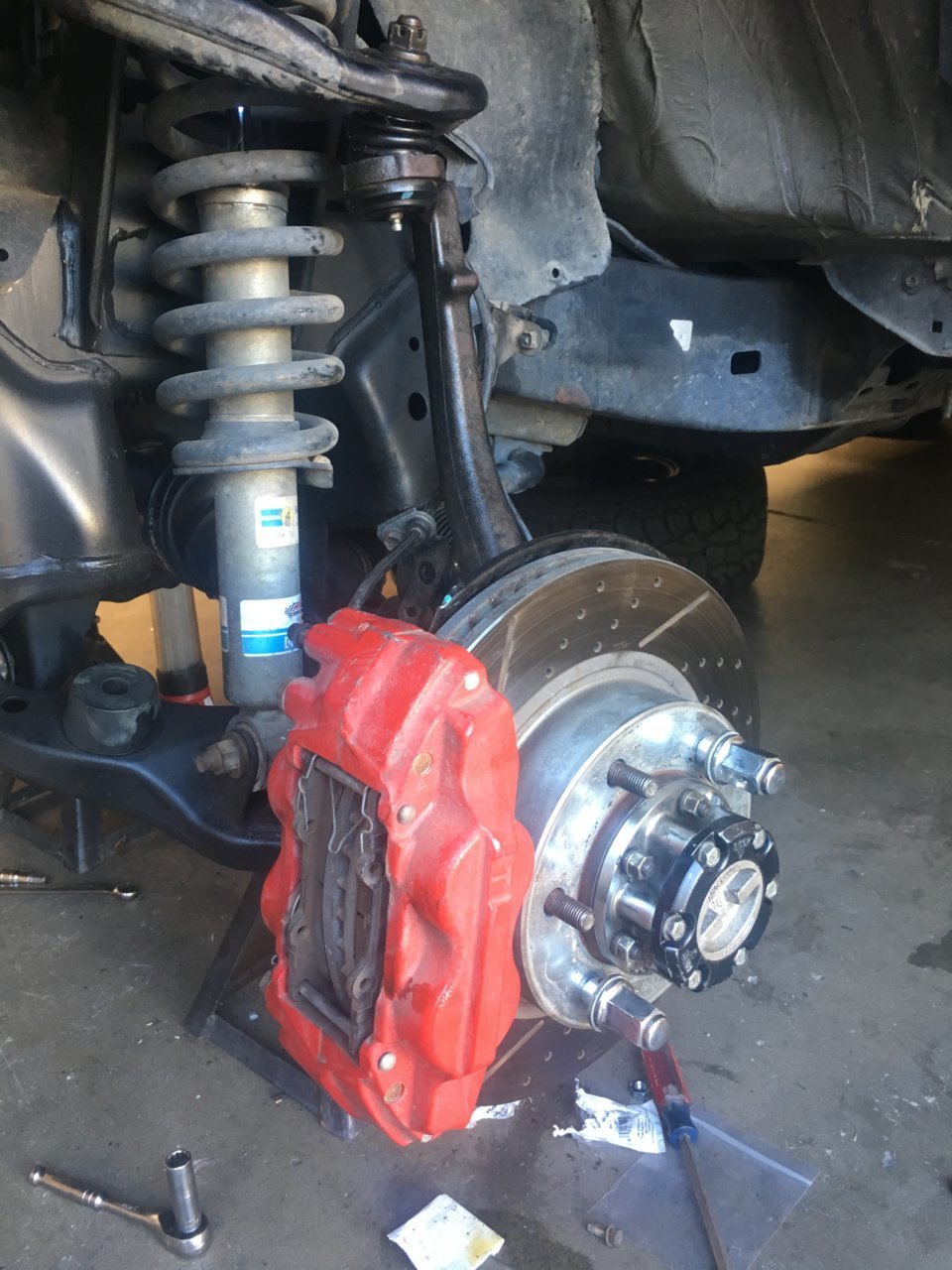

  20. Jan 2, 2019 at 10:13 AM
    #180
    Lfaub03
    Feb 15, 2015
    #148762
    1,138
    Logan
    Flagstaff, AZ
    2003 Prerunner TRD
    4wd conversion

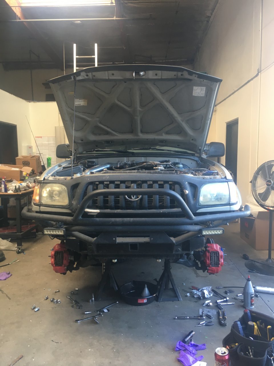

    Here’s some pics from the front end build
    40018288-D3E4-40DD-BE34-6FE01F2A02BD.jpg 9B3330C5-C40D-4692-82D5-1582D8CD69C6.jpg F2EB7351-0B4B-4559-B0C6-D499AC87CC7C.jpg C8B2A163-0E85-42CF-A535-231D20D24ECE.jpg DE52DA96-CB86-4ED6-AF15-9E95F729057F.jpg 1EBFC0AB-BB22-4678-AC58-B13BCE65F789.jpg
    With the exception of the gearing issue, im really happy with how it turned out! Hubs engage and disengage smoothly now that they’re greased up, nothing rubs or squeaks, and the truck floats over bumps smoother with the extra weight in the front
