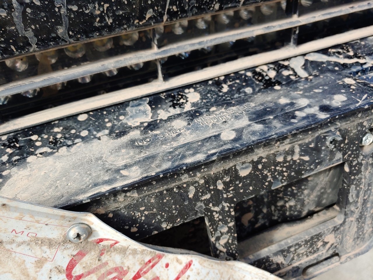

    Cheapest fix?

    Fatter screw
    Sosk, TimC, Big tall dave and 6 others like this.

    2013 4x4 TRD OFF ROAD
    Large but short screw 1 inch left of the bad one.

    1996 Tacoma - 2018 Tacoma
    Ream the existing hole large enough to insert one of these and new screw. It's work for me on several bumpers.

    2018
    New bumper. Just kidding but all you need is a wider screw. This happened to my friend that owns a 2nd gen taco. I told him to get a drill and make the hole round and smooth again and get a fatter screw.

    Mostly dust and dirt.
    I put my plates on today and the screws that came with the plate holder were too small. Had to use the screws the dealer used for the temporary plates.

    2019 Tacoma TRD pro
    Yup, team and larger self tapping

    South NJ
    2018 DCSB SR5
    Zip tie

    2012 TRD OR
    Dry wall anchors and screws

    19
    Personally I say use a 3 1/2” drywall screw. Report back with findings

    2020 DCLB SR5 4x4
    Just throw in a bolt from the backside and put a nut on the front? Maybe a washer or two?
