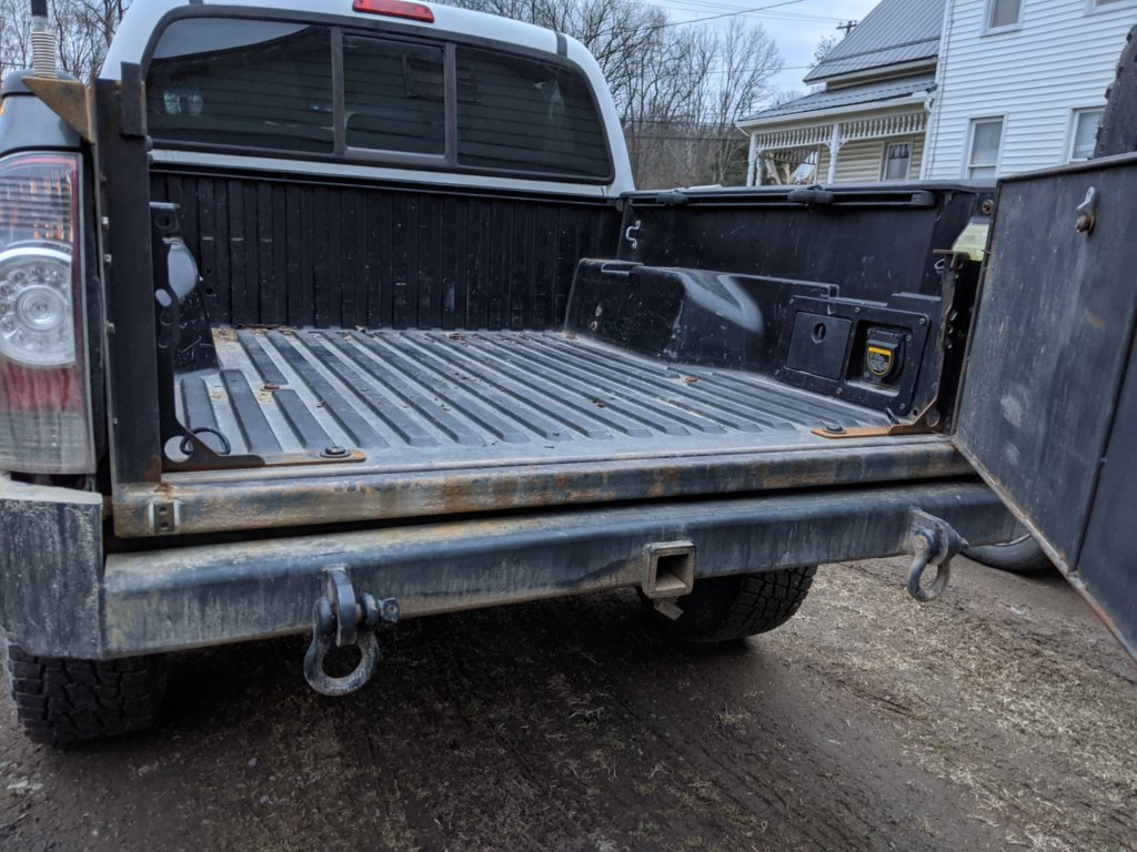

    I have a high clearance bumper, but not a plate bumper. I also have a swing-gate with tire carrier.
    I'm trying to get the truck more road worthy and need to figure out a solution to my license plate and lighting of it.
    I have extremely limited skills, so the easier the better.
    I have a better pic of the bumper and swing gate in my build thread. Thanks for any help/advice you can provide.

    It is currently self tapped into the swing gate, but no lighting so I don't drive at night.
    I am hesitant to mount the plate directly to the bumper as it will hang below. A member with a similar bumper confirms it will get mangled.
    I considering going with dealer magnetic mounts and wiring a bracket led light on the top part. I have about 1" from the bottom of the bed and the swing gate. That may allow me to run my wiring through the spare tire access hole. I've also wanted to add a third brake light to the top of my rack, so it may just be time to make it all happen.

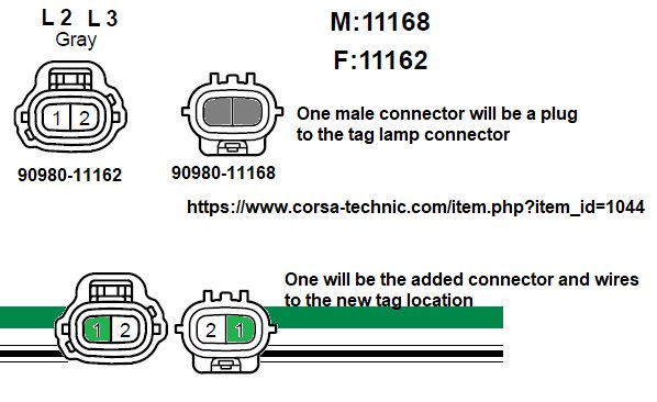

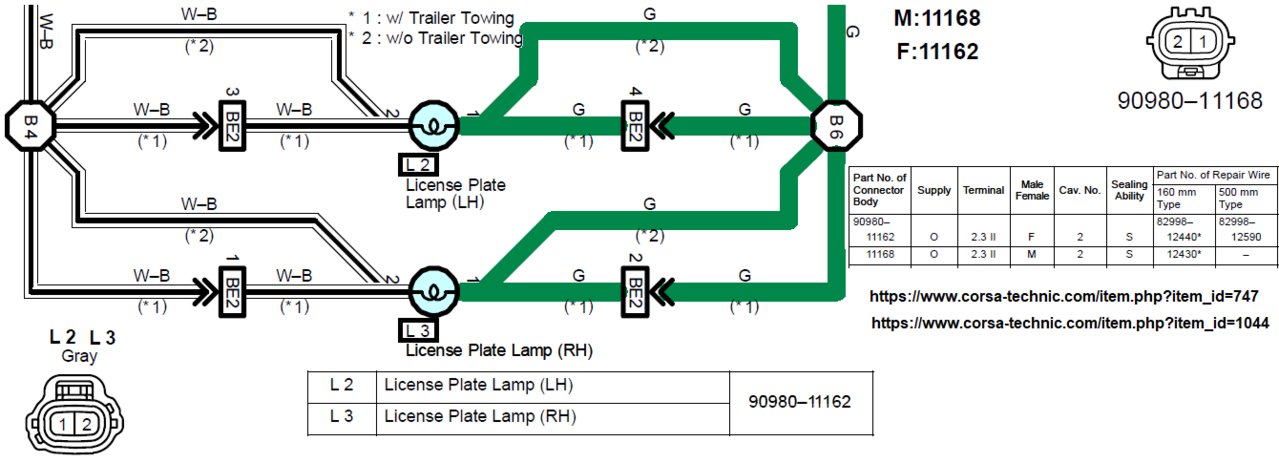

    For others who would tap the tag lamp properly.

    I don't understand schematics, so this means nothing to me. However, it seems like you have some ideas with the proper way to wire this up.
    Care to elaborate/educate a newbie?
    I'm not following how cutting the end off, and splicing into the existing wiring is going to change anything.

    When I did mine, the old connector was retained. The easiest way to keep it reversible was to simply wire tap and not cut anything.

    Just stop by autozone If you aren't worried about cutting. Get a pair of spade terminals or butt connectors. They are in stock and always on the shelf at a parts store
    I modified the old light socket to fit modified spade terminals. I didn't want to cut anything on my wiring harness.

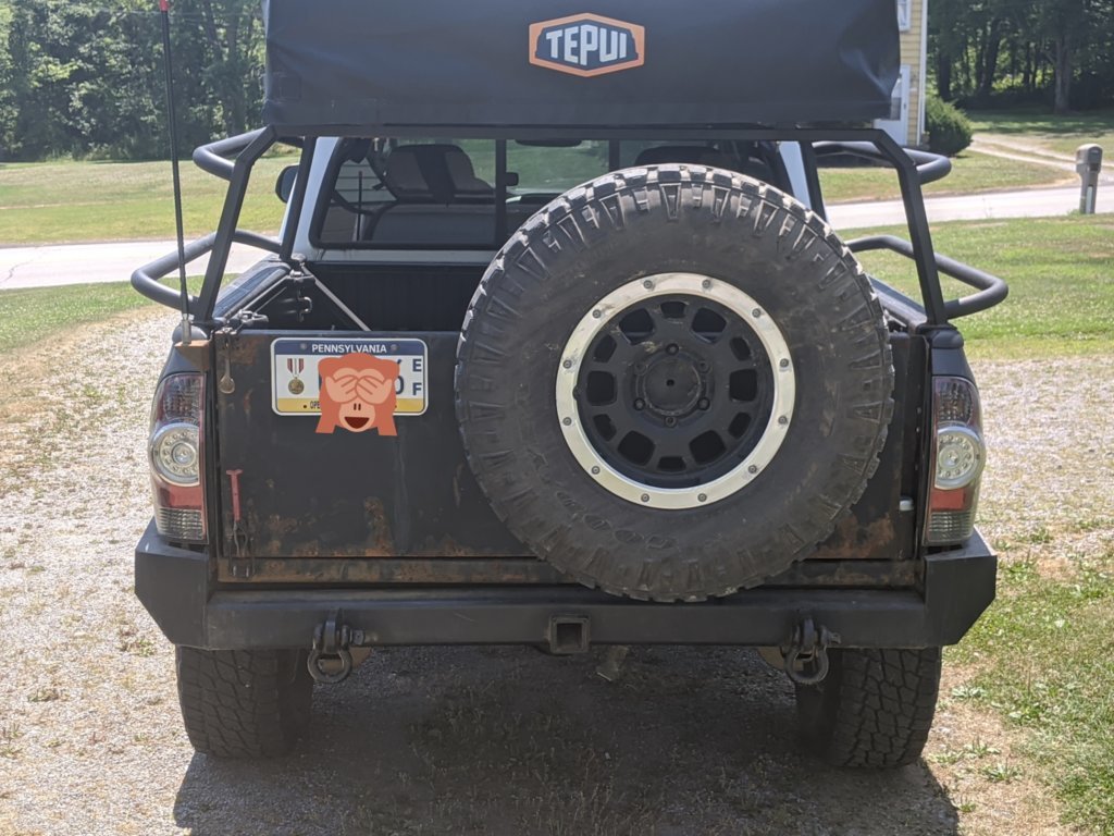

    This is my mounting set up. I don't think I'll rip it off wheeling, but it will sit above the swinggate line. There is potential for damage from stuff in the bed, or eventually just not paying attention.
    As previously stated, I can't read or make sense of a schematic. I know you're giving me the answer, but it's lost in translation.

    Just to finish the thread. The Corsa technic connector was a bust. I tried and failed, decided to just do it old school. Cut, splice, solder, done. The light I bought was a POS and came crooked, but it works.
    I also ended up running the wiring through the table on the swingout.
