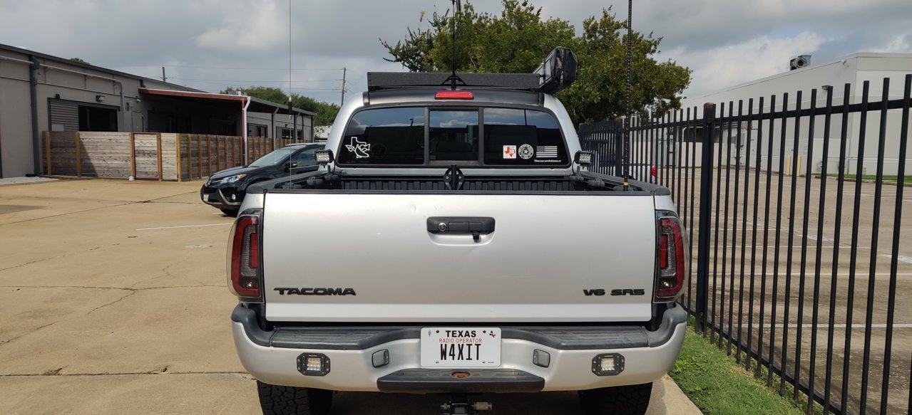

    OK. I'm attempting to hook up some Amazon special LED license plate lights built into the mounting screws.
    They have a red and a black wire. I tried hooking the red wire to the single wire that was attached to the old lights and then just grounding the black wires to the steel after market bumper. I got no light.
    The LEDs work fine if I have tap them on the battery.
    Do I need to run the black wire to a separate ground line that goes to the battery or should it work if I attach straight to the frame?

    I would ground it to chassis and not the steel bumper or sub components unless you grind down the mating surface. Electricity doesn't conduct very well through painted surfaces or parts that are fastened on.

    I will try it again then. I was using one of the other non light license plate mounting bolts for the connection.

    You could always run a ground wire to chassis, I had to extend some of my wiring for the lights to work properly.

    @bkrdave36 Why aren't you using the original white/black license plate light ground wire?

    I only have the single wire.

    Follow the wire upstream til you get to the 4 pin wire connector. The factory runs a positive and ground to each light, so you should have 4 wires.

    You're going to need both a hot and a ground to light them up. And LEDs are polarity sensitive if you use one of them.
