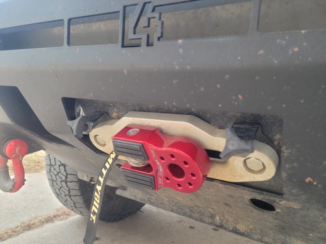

    I'm in a slight pickle here. After installing my new Flatlink, my front license plate no longer attaches to the very cool mount provided by @C4 Fabrication. It uses a pair of thumb screws to afix the plate to the tabs behind the fairlead, however I no longer have the necessary clearance due to the thickness of the new part. Does anyone have a clean fix or a creative idea for respecting my states requirement for running a front plate without tossing it on the dash?

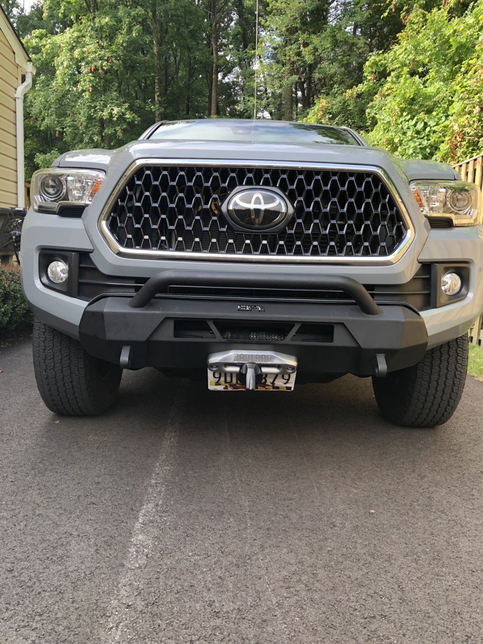

    Just wedge your plate under the bottom edge of the hawse before you tighten it down. Like this:
    It's a government issued control placard, not an Tacoma accessory you must keep pretty. One shouldn't care it it get bent, scratched, dirty or whatever.

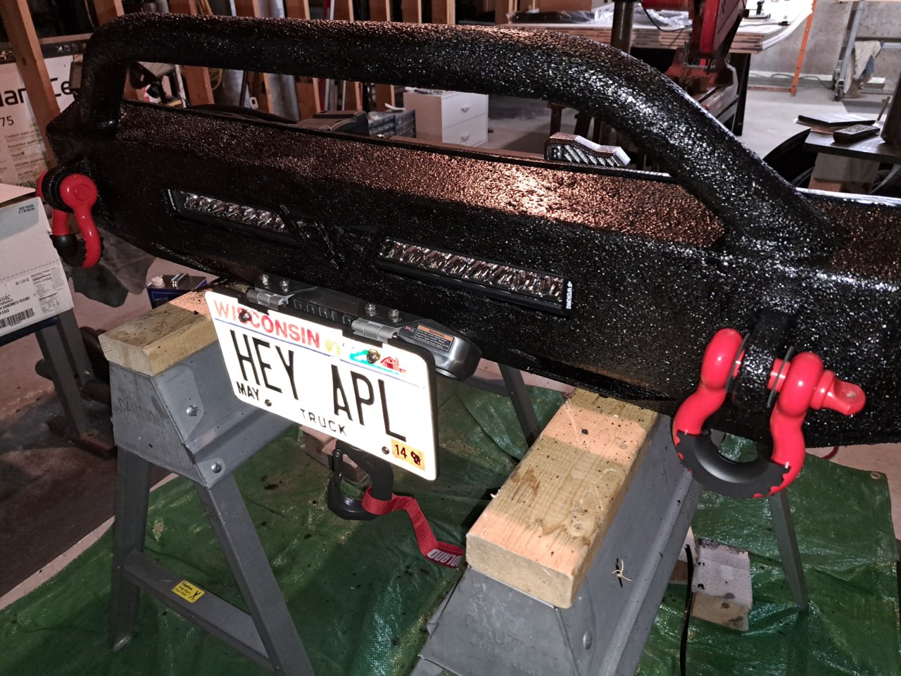

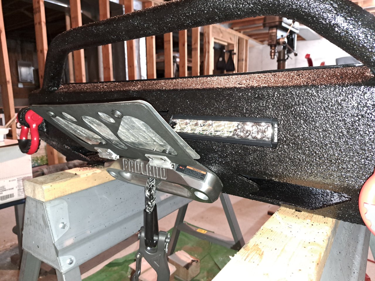

    Not finding anything in the marketplace, I made my own:
    I used .125" aluminum sheet with friction hinges. If I had to start over, I could go lighter with the aluminum.
