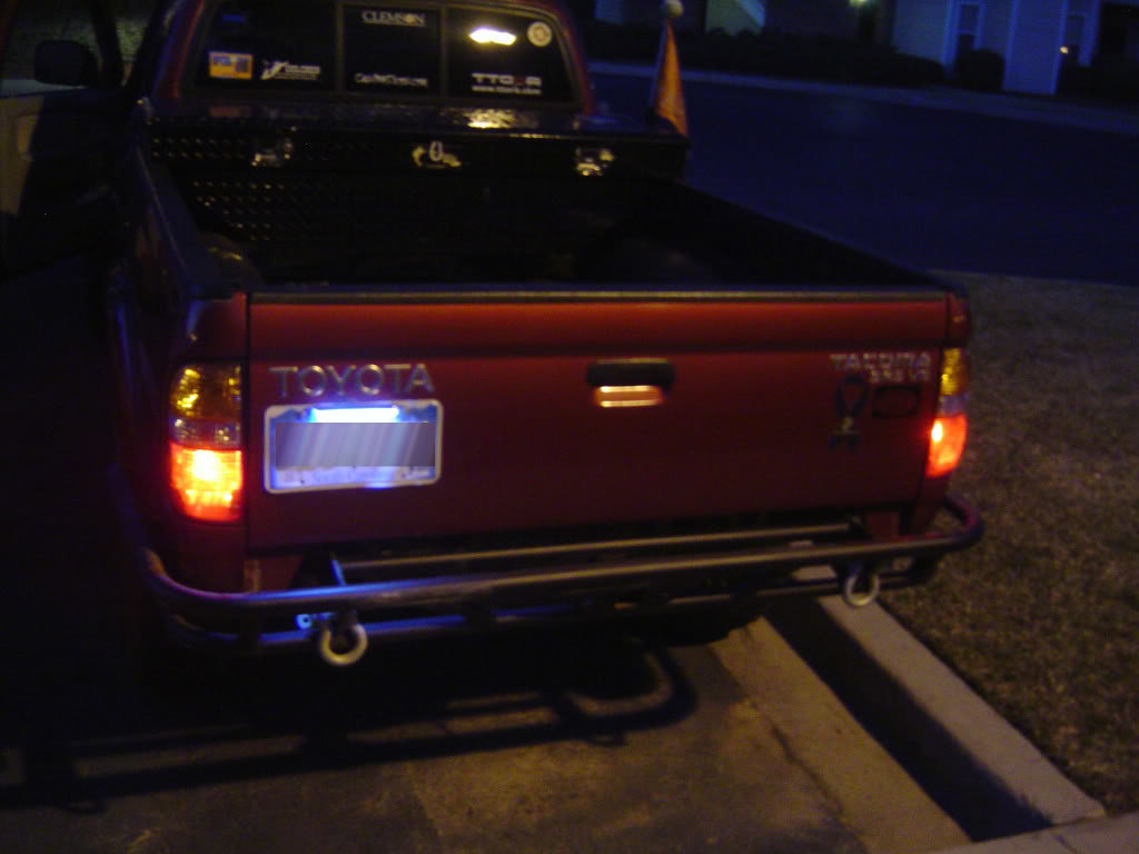

    This is how i did mine. It has a small black light above it.

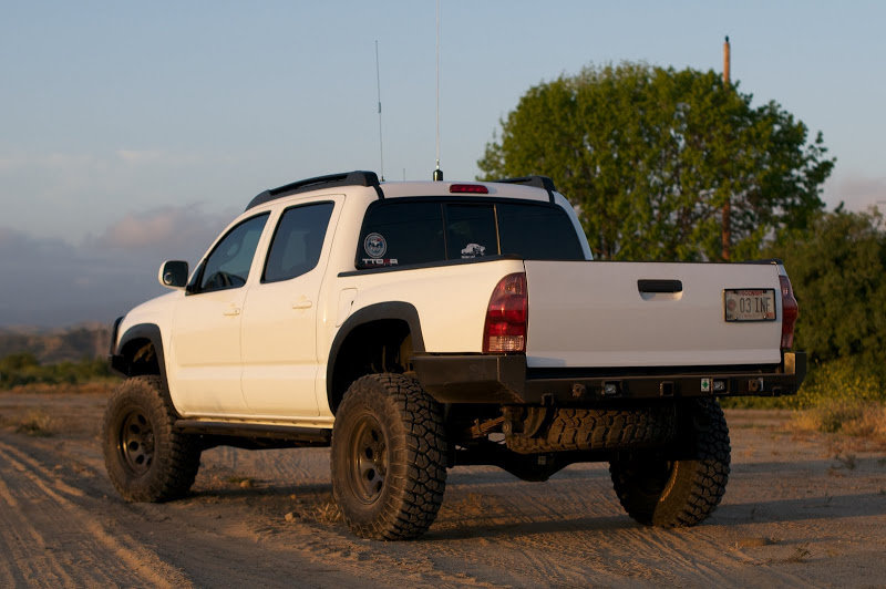

    I did the same
    drilled 3 holes in the tailgate
    1 for the wiring and 2 for the bolts
    ran the wires from one of the stock lights up thru the tailgate and bought one of them $15 LED strips designed for the license plate...took like 30 min MAX to do the whole thing

    sometimes thats not an option...as is the case with mine
    i initially tried it on the bumper...but when i was offroad...the plate would get bent or ripped off
    i moved to the tailgate and havent looked back

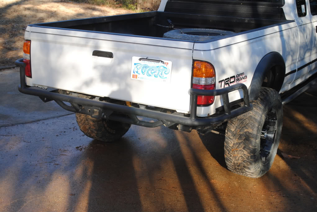

    Here's mine
    using these for lights

    It's super easy to do
    I just marked where I wanted the hole for the wire, drilled it out just big enough for fish the wires etc (theres holes in the bottom of the tailgate already that you can utilize)
    once the wire is fished thru and hooked up just use self tapping screws to mount the plate and light where you want it

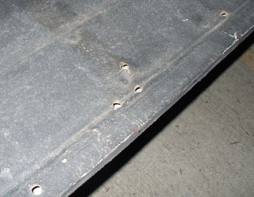

    The previous owner already screwed up the tailgate, so I don't feel bad about drilling a few more holes. He worked in construction and I'm assuming he used the tailgate as workbench because the holes are completely random.:rolleyes:
