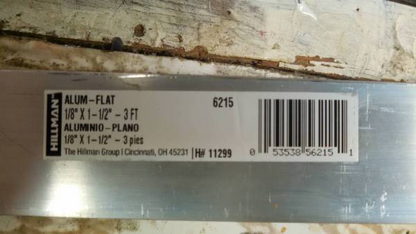

    Materials:
    Aluminum flat stock

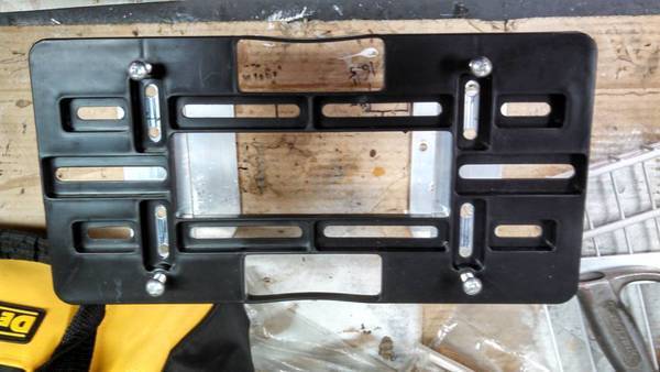

    Step 1)

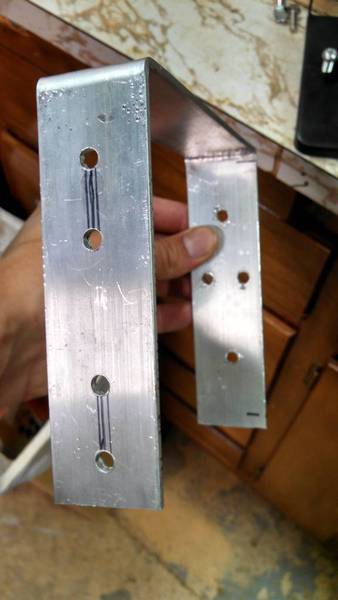

    I measured the distance from bottom of crashbar to about 1/4" above black plastic part. The out about 5.25"(so the back of bracket didn't hit lower bumper plastic). Then down the length I'd need to bolt through the universal license plate holder. I then put these onto the flat aluminum as best I could and bent it using a vice and heat from a torch.
    I then made sure the 2 bent parts were equal with a little more heat and hammering and lined up the universal bracket on the aluminum to make lines for holes to be drilled.

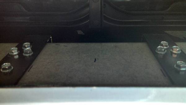

    You can see I drilled 4 holes in the back of each piece-the mouting holes that go into the crash bar. A bit overkill, but why not.

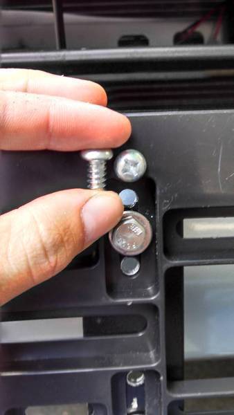

    The screws that come with the universal bracket(to mount license plate itself) were too long, so I trimmed them with my dremel(they were contacting the aluminum bracket behind the mount holes)
    I used whatever bolts/washers/nylock nuts/bolts(two washers on plastic side, one on aluminum side) I found that fit at the local hardware store to mount the bracket to the aluminum pieces.
    Then I painted the aluminum pieces black with some rustoleum after I roughed them up with a scotch pad.
    Mounting the whole thing:

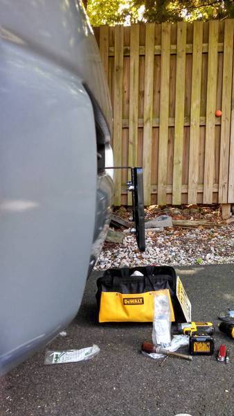

    I just slipped the back into the lower valence assembled and marked where I needed to drill pilot holes for the self-tapping screws(not necessary, but makes life easier). I aligned the bracket centered and off the black plastic a little so that it doesn't scratch it or trap dirt under it too much. BE CAREFUL!! Wear safety glasses-aluminum shaving go everyhwhere when drilling.
    Finished Product:
    Thanks guys! Open to comments. Did this to put a lightbar in the lower valence and I wasn't going to take my front plate off and put it on the dash or some junk.

    Please tell me it doesn't stick out that far from the bumper.....i mean have you shortened the aluminum flatstock to make the plate closer to the truck?

    ^ It would prob hit the bumper with wind coming in. Good job op.

    Yeah, its a bit long, but at highway speeds it definitely won't contact the bumper and it looks fine from the front. Could be shortened by like 1/2" to 1", but who knows if it'd make contact then. If I had a go pro, I could video how much flex it has..but I don't.
