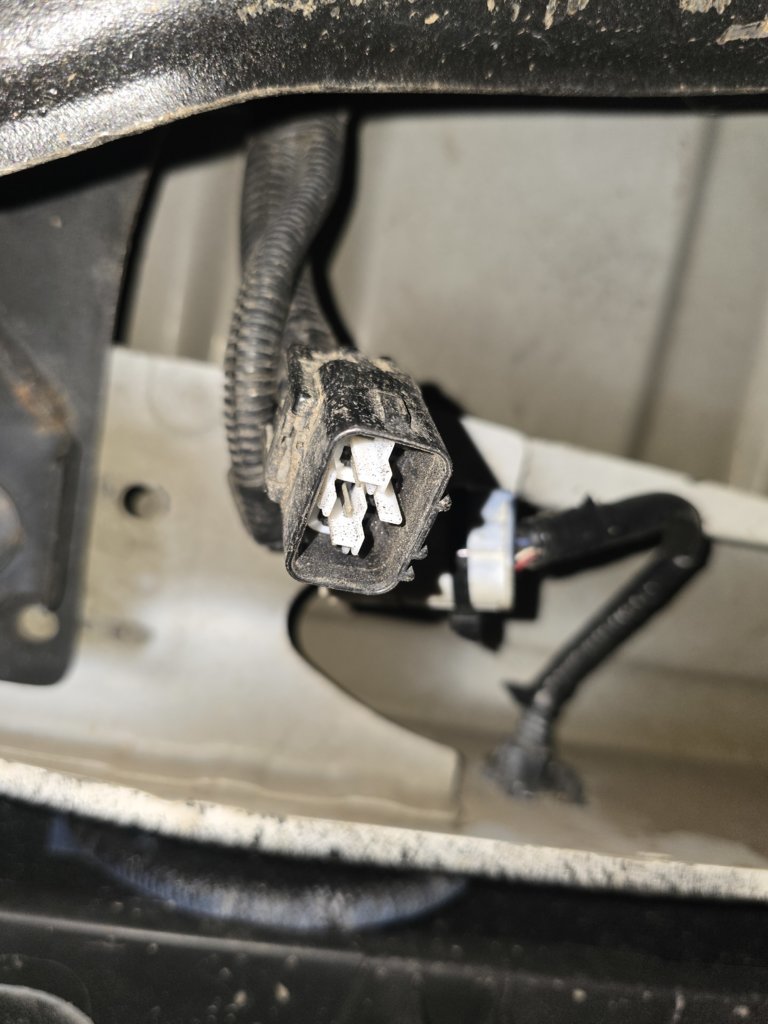

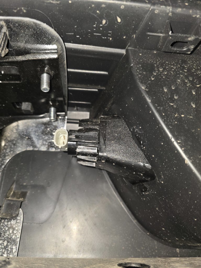

    Hello all, I have an interesting question about the license plate lamp wiring. Mine is missing, but I have a couple connectors and see where they should go. I have a couple pictures to show what I need to connect. I have found the 2 pin and pig tails that connect to the lamp, but I have yet to find the 4 pin connector/w pigtails to splice it all together. Also, my 4 pin connector is missing 1 pin, not sure if that's a problem. How would you proceed?
    Edit: the last picture is a zoomed in picture of the missing pin on the 4 pin connector. Also, its a 2014 SR5. Thx

    Something isn't right there, what color are the wires in that 8 pin connector?
    License plate light connector should be a 4 pin connector if you have the trailer tow package, without the tow package they are wired direct.

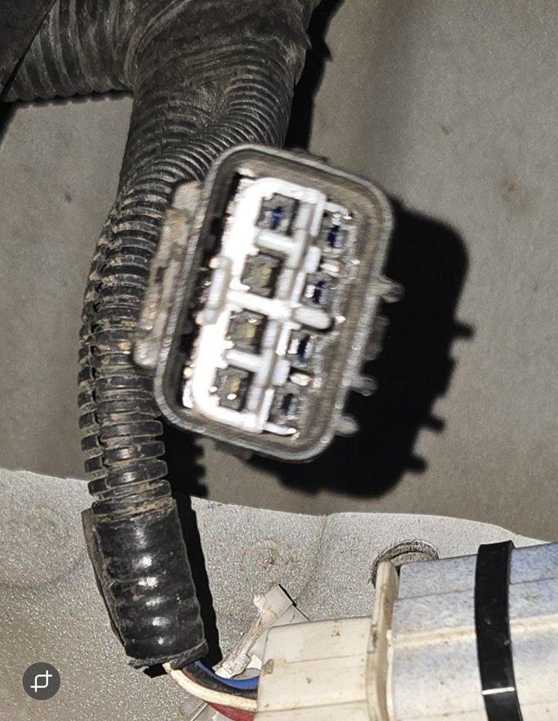

    That plug is 2 green and 1 white with a black stripe. I could be looking at the wrong connector to pig tail into. I haven't gotten the hitch installed yet. It was just rebuilt from salvage due to rear end damage

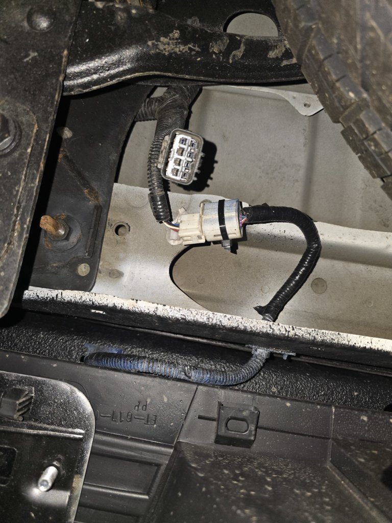

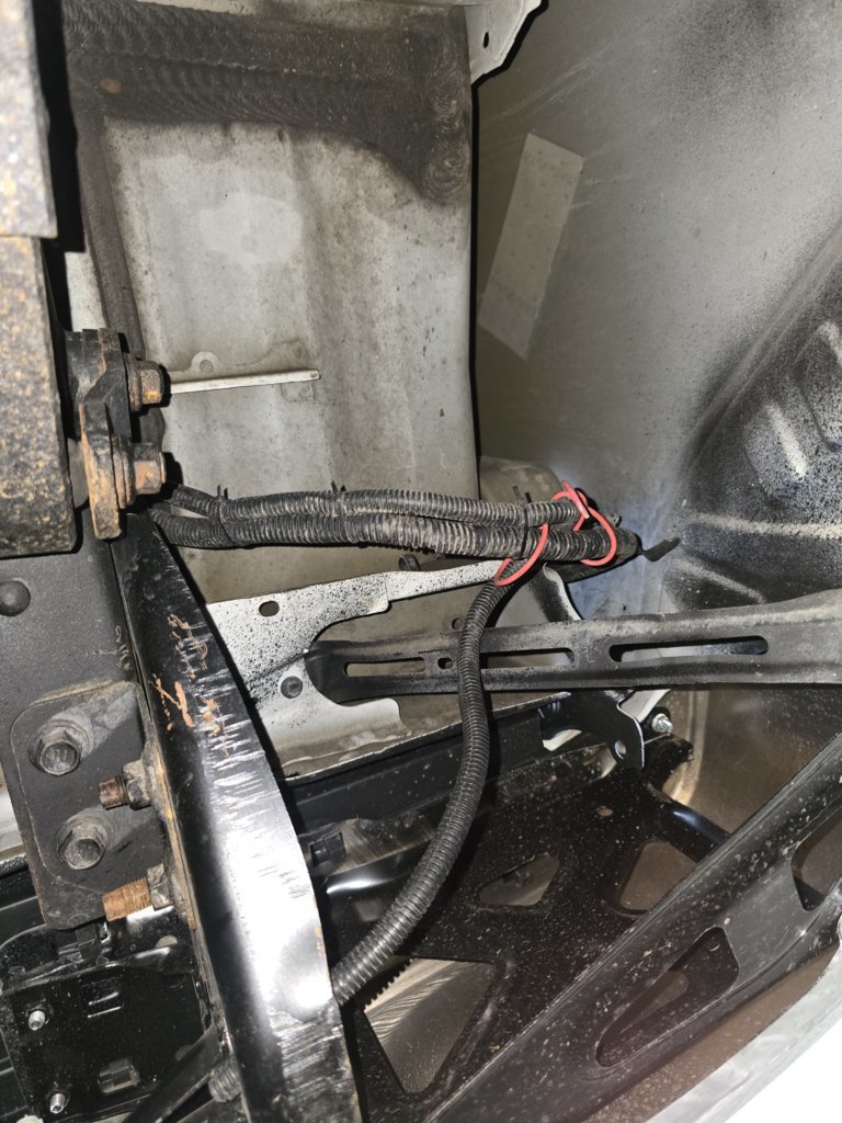

    This is a bundle near the left tail light. Maybe these wires are the ones I use for the license plate lamp?

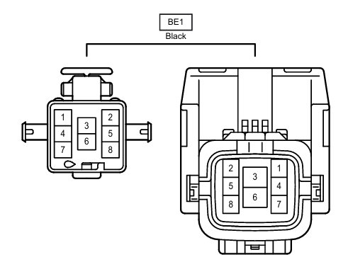

    I'm not sure what's going on there, I can't find that 8 pin connector.
    There doesn't even show to be any 8 pin connectors back there other than BE1 which is completely different.
    Is something there maybe from a different year model truck or aftermarket wiring?

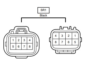

    Ok that's interesting, not sure how that works but ok...

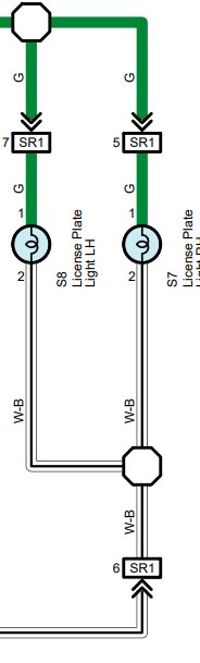

    So yea if I look up a 2017 Tundra that is Connector SR1, if it's hooked up right it looks like your gona have to cut that off and just wire your LP light pigtails to those wires. Green is Power and White/Black is Ground.
    See on a 2014 Tacoma the LP light connectors are part of the towing harness.

    You may get a test light and check those wires for power there first, being it's been frankensteined who knows how it's been wired up.
