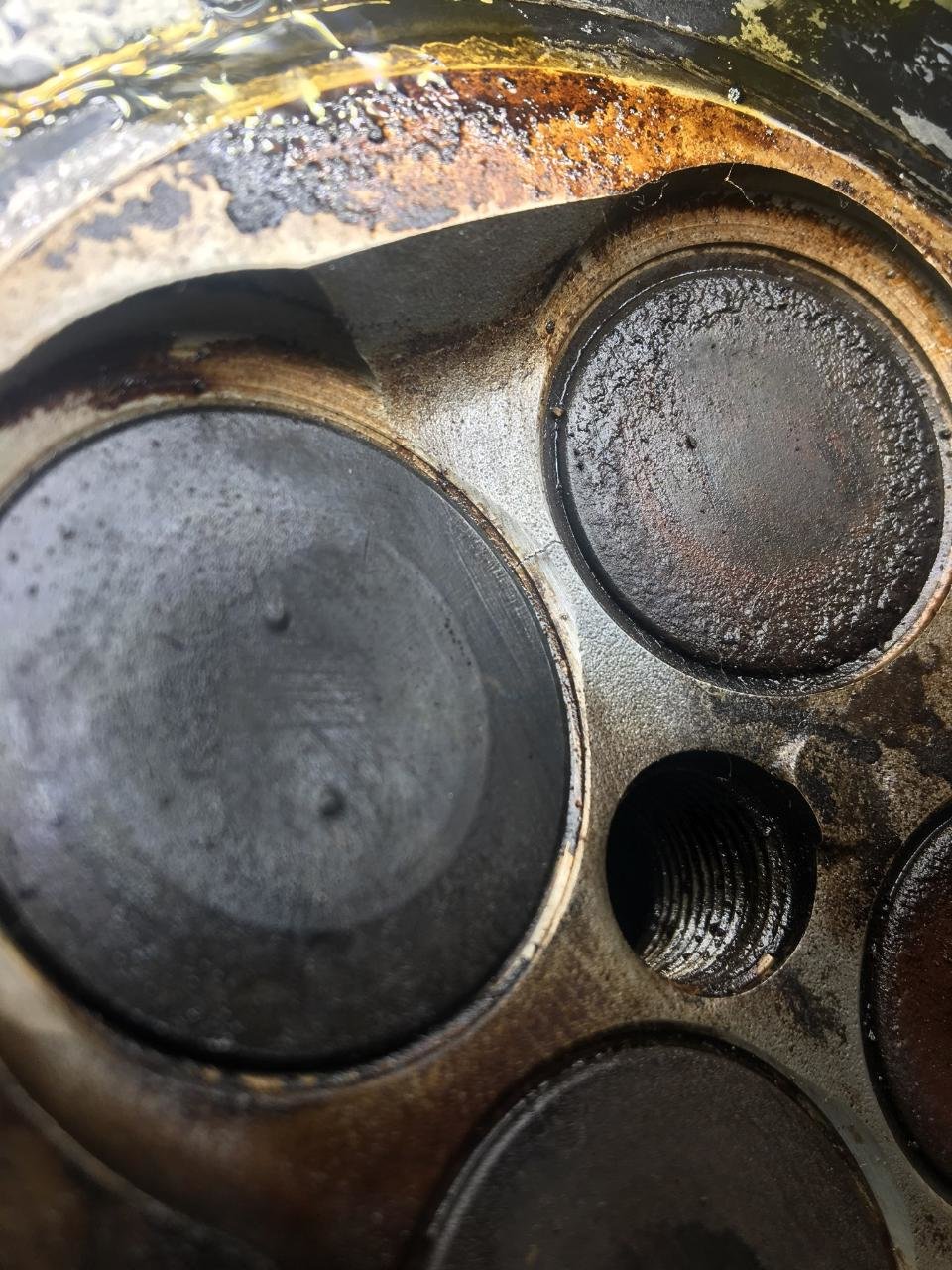

    21
    At 12,000 miles switched to synthetic fluids in everything. Every 5 years changed antifreeze belts hoses. Flushed trans every 40,000.All Toyota parts.Changed timing belt water pump, tensioner.Im not your average mech.I work on wide body jets for a living. Worked at dealership before that. Truck was never over heated.Changed thermostat at 5 year mark regardless of miles. First 44,000 was in 2013.After that 90 percent hwy miles.Cyl walls at 144000 still show no sign of wear.I would say its properly maintained.Crap happens.Not first 3.4 I seen with cracks between valve seats. They have a problem. It doesn't happen to all of them.They have sb for the headgasket problems.Cant say if heads crack because of blown gasket. I suppose pressure could build up trying to compress coolant who knows.Theres very little material between valve seats if you actually look at cyl head iff truck. Its just strange Im not the only one with cracked heads and then you see some go 300,000 without cracks or have cracked and its not apparent to owner.Mine could have cracked years ago and I just found out because heads had to come off.Ive owned Toyota trucks since 85 when bought my first. Never owned 3.0 because I knew it had issues. 22r.Bullit proof

    Machine shop said they have seen numerous. 565408079.jpg565408079.jpg565408079.jpg
  6. Dec 3, 2018 at 12:43 PM
    #246
    rugerm44
    rugerm44 Member
    Oct 9, 2008
    #9864
    21
    Cracked between valve seats. My luck.I figure new heads should run another 100,000 or so.No signs of wear on cyl walls at 144000

    21
    You did good.Mine just blew 2headgaskets and both heads have cracks between valve seats.144000.Bottom end looks great.Looks like only lasting choice is to get 2 brand new heads and use my cams.Cant seem to find any rep rebuilt ones.Probably going with a tundra in near future
