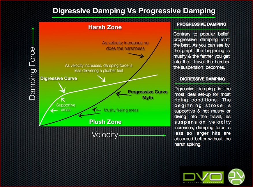

    TRD PRO Cement 2017 TRD CAI and AFE Magnum Flow Dry Air Filter Camburg KINETIK Series Billet UCA Icon LCA skid plates Icon Coilover extended travel shocks with 700# springs Icon 2" rear shocks Icon RXT leaf springs full pack (new rims and tires soon)
    http://www.hotrod.com/articles/shock-absorber-shock-dyno/
    View All 7 Photos
    When It Comes To Keeping All Four Tires Planted On The Ground, Don’t Just Depend On A Valving Number. Knowing How To Read A Shock Dyno Sheet Can Help You Fine-Tune Your Shock Selection
    At every level of racing shock tuning is becoming increasingly important. These days it’s the rare NASCAR Winston Cup team that doesn’t have a man devoted solely to shock absorbers. Rusty Wallace once called the job of the shock tuners a “black art.” Given the many variables available between the car, track and shocks themselves, that’s understandable, but it’s not necessary for a Saturday-night level racer. Understanding how to pull information from a shock dyno sheet and apply it to your car can send you a long way down the road to shock-tuning bliss.
    It’s An Energy Absorber
    First, a little background information so we’re all on the same page. A shock absorber’s job is to smooth out the reaction of the springs, that’s it. It does its job by transforming energy from the movement of the car’s suspension into heat, which is radiated from the shock body. The spring rates you choose control how far your car rolls when you turn, or dives when you brake. Shock valving controls how long it takes for the car to roll or dive forward. Rebound damping in your shock controls how long it takes the spring to return your car to ride height after the suspension is compressed. The larger the valving number, the more the shock resists the spring’s expansion. Conversely, compression damping controls the opposite movement by the same means.
    Shock Types
    There are three major categories of shock absorbers, which are based on the way they react to force. (Note: This is not a discussion of shock absorber design, meaning twin-tube versus mono-tube.) The first shock absorbers were progressive, meaning that as shaft speed increases so does the damping rate, or the energy required to move the shaft at that speed. A progressive shock is the simplest design, and also the least useful in practical terms. It’s simply a perforated disk moving through a resevoir of oil. At slow speeds the oil passes through the holes in the disk easily. At higher speeds more energy is required to move the oil through the holes in the perforated disk.
    Eventually this type of shock reaches hydraulic lock—no matter how much force is applied to the shaft of the shock, travel speed cannot be increased. A progressive shock is old technology, and it’s performance is unacceptable to the modern racer. Low, continuous forces like body roll through a turn are too poorly damped, and on the other end of the spectrum the shock is unable to absorb sharp, high energy forces: holes, ruts and otherwise rough tracks.
    Linear shocks were the next big advance in shock technology. As shaft velocity increases, damping forces increase at a linear rate. On a shock dyno graph (Diagram B) both compression and rebound damping appear as approximately straight lines diverging from each other as shaft velocity (or force exerted on the shock) increases. This style of shock has been a boon for racers because it allows increased control at lower shaft speeds, which is vital for controlling a race car through the corners.
    The third type of shock is a fairly recent development. Digressive shocks are essentially the oppostive of progressives. As shaft speed increases, damping forces increase at a decreasing rate. Diagram C is a shock dyno graph of a typical digressive shock dyno curve. Digressive shocks provide low-speed damping control without being unreasonably harsh on rough racetracks. Both modern linear and digressive shocks allow separate damping and rebound rates. So far manufacturers have not been able to combine, say, digressive rebound with linear compression in one shock yet.

    Aren't Kings progressive? Trophy trucks seem to like them.

    Yes, they are very much progressive.

    I just realized @Dacon was talking about NASCAR. Thought it was odd they would say a progressive shock was old tech and unacceptable for racing.

    Plus that article is old, it still refers to the "Winston" Cup. Technology has rapidly advanced since that article came out :stirthepot:
