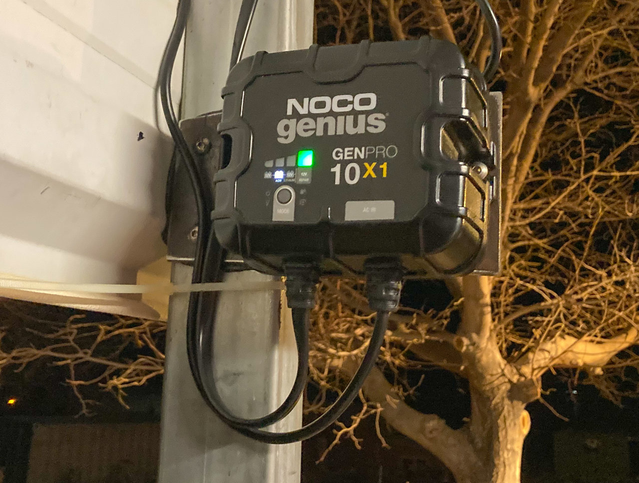

    Any recommendations for a trickle charger?
    I just tested mine out of curiosity, and it's sitting at 12.1 volts, so a little weak. It's been in there for almost a year, and my 4Runner sits a lot. I'm hoping that a charger of some sort will help maintain the battery better than I have been.

    I like the noco genius chargers they have a revive option too that can prolong older batteries.

    Anything from these guys is going to be a great charger. SOLAR Battery Maintainers Archives - Clore Automotive

    @tarbal255 If you ever plan on getting an agm battery, look for a trickle charger that can charge them as many dont have that setting. It will charge it, but not to proper capacity.

    I also like the NOCO, but the Ctek's are also good(maybe better?).

    Big B+B X2 Power fan, however, I do keep them on a Trickle charger. Noco for AGM, battery tender lithium for my motorcycle which has a Shorai battery. If I couldn’t run a tender I’d keep the lead acid in there. When it comes time my 3rd gen will have an X2. Just my 2 cents.
