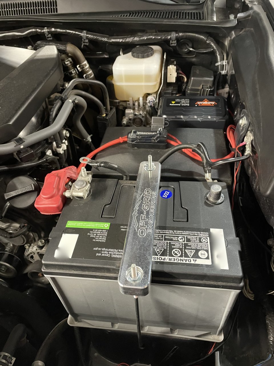

    Wally World Everstart 24F AGM and an off grid engineering battery strap. Noco Genius to keep it topped off. Plenty of juice for an aftermarket stereo system, lights and several other accessories. 710CCA, 4 year free replacement warranty and only about $170. You won't find another AGM at that price.
