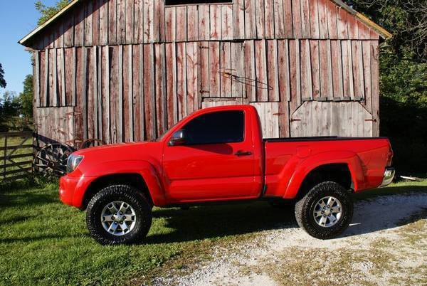

    I know you guys are looking for a 2.5 inch lift but here is mine with a 6 inch lift. Just tossing it out there. IMG_1061.jpg

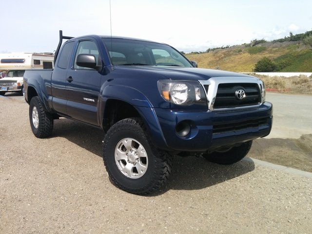

    3" front lift from 884 springs and Progressive AAL in the rear.
    Here's what she looked like with 2.5" in the front (before adding spacer to address the taco lean on drivers-side), and Stock Rear.
    If your only looking for 2.5 in the front, I would recommend going with 883 springs.
    Achieved 3" on passenger-side from 884 springs, so I had to add spacer to the driver-side (2.5" - taco lean) so both would match.

  11. May 13, 2015 at 3:59 AM
    #31
    Maineiack
    Maineiack Well-Known Member
    May 6, 2013
    #103640
    304
    Maine
    2013 stock reg cab 4x4
    Damnit! Now I gotta save even more money!!! HA HA, Are those 35's then?

    Yes they're 35's! I love the lift i'm actually taking the bed cap off today, it will look so much better without it!
