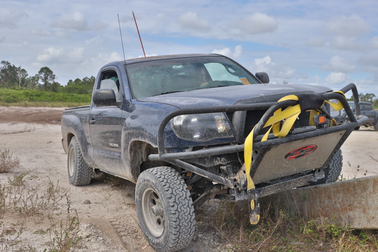

    That things sick! Yea I do a lot of camping and load the bed heavy but I also do lots of commuting. I don't want to do anything gnarly just add a tad of height! lol

    2010 Base 4x2, 2.7L, 5 speed manual 5-lug Slug
    Gone over the Top for a 5-lug..
    Mine is 99% commuting/highway - i've had the full works in terms of Readylift, Bilstein's, AAL, much larger tires.
    Yes - it's a bit harsher/rougher than OEM suspension. It also takes our frost heaves/potholes (I saw a VW trapped in one, on the way home from work.. coulda swore an F150 launched itself over it...) a lot better than the OEM suspension - our highways are a mess right now with the freeze/thaw cycles. It doesn't mush it's way going around a corner any longer.
    It's a truck to me.. not a Lexus. The suspension characteristics are ideal, for my use of the truck.
    Bilstein 4600's are OEM front shock length - no increase in height alone, swapping shocks. You can't go beyond the 2 3/4" front spacer lift, without swapping out to a mid travel front setup... if you can find one.
