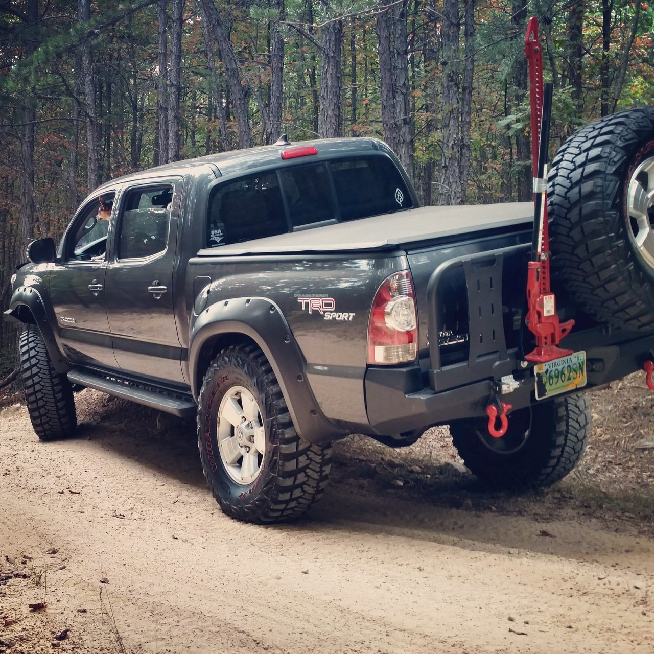

    The one-inch body lift is fine. Use either 4crawler or toytec. Add an add a leaf to the leaf pack. Swap in longer coils on the front.
    I have a 1 inch rear block and 1 inch body lift mixed in with an icon extended travel set up to stuff 35s. Is it perfect- no. But the ride and performance is good for me. IMG_20171006_150544_446.jpg

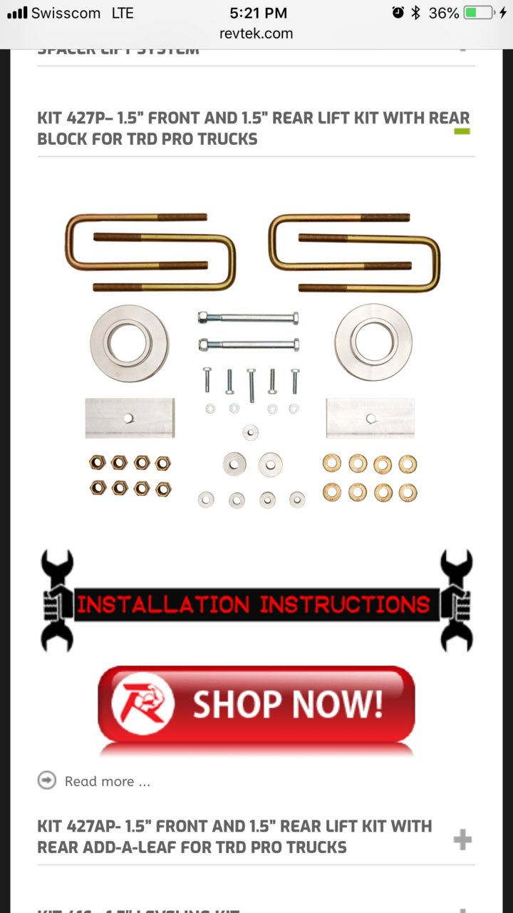

    I am waiting on my Pro to arrive. I also wanted to keep the Fox setup. So, I opted for the Revtek 427AP kit which is a 1.5" front spacer and a 1.25" AAL. It's made specifically for the Pro and not sure what makes it specific to the Pro, but I didn't care. I wanted to fit a 1-2" larger tire in there without any rubbing and to make it look a bit more aggressive, since Toyota messed up with the tire size on that one. We will probably get alot of shit about that spacer lift, but.........I DON'T GIVE 2 SHITS WHAT PEOPLE THINK.

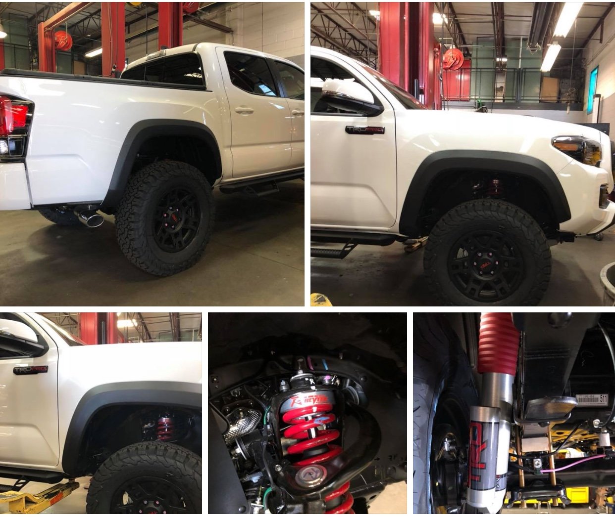

    I Recently purchased a 2019 Tacoma TRD pro, and the Revtek kit (427Ap) discussed in previous posts... Looking at the post install photos added by HJM2, this kit appears to add quite a bit in terms of much needed tire clearance.
    Has anyone else installed this kit? does anyone happen to have before and after measurements from the wheel hub center to the wheel arch?
    I have already fitted larger tires (285/75/16) in anticipation of a full suspension lift that I plan to install this coming spring. currently they only rub the mud-flap on occasion, and I hope the 1.5" Revtek kit will put an end to that... on road at least...
