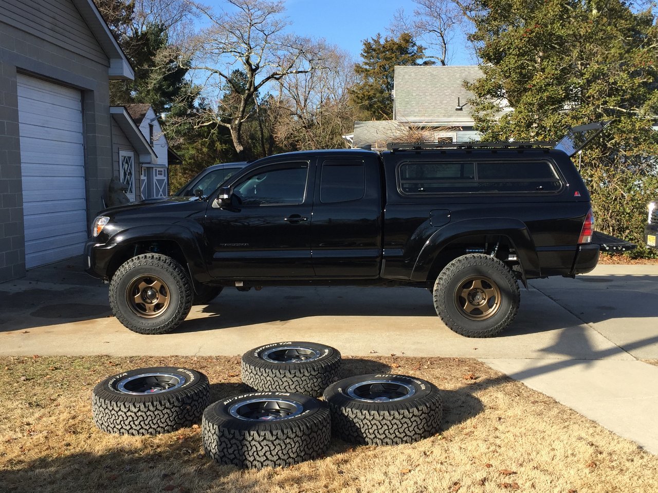

    2.5 Kings all around, HD Dakars -1 OL, Camburg Moog BJ UCA, Leer 100r topper, Prinsu rack
    I went IMG_5567.jpg with 255 ST Maxx if you don't want to trim, just remove the flaps. The maxx do not seem that narrow.
    ChadsPride and oscolivar1 like this.
