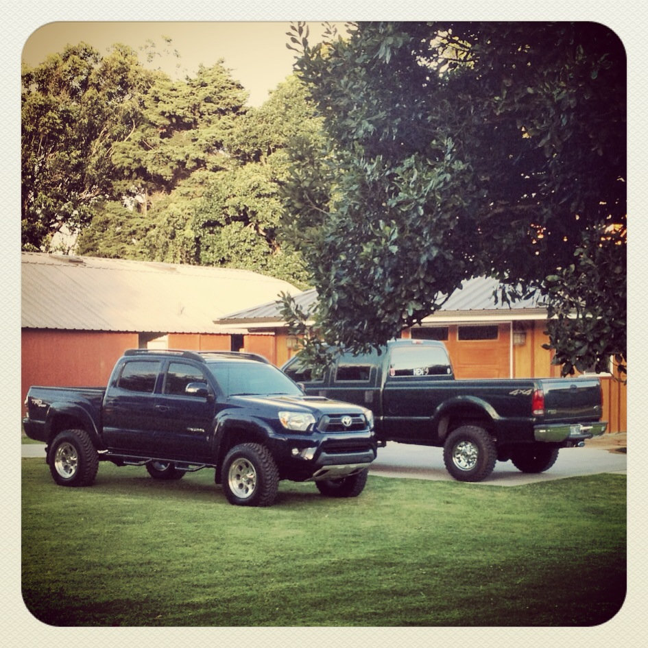

    AFE CAI TRD Exhaust TRD Supercharger 3" Cornfed Spacer 2" Toytec AAL
    It really depends on what you are going for...IMHO
    Mine is my Wife's DD & we aren't doing any crazy wheeling so I went with a 3" Cornfed spacer in the front and a Toytec 2"AAL in the rear(I had a 2" block for the rear but scored the AAL from a fellow TW member for a set of stockies)
