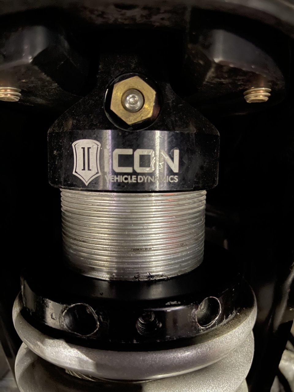

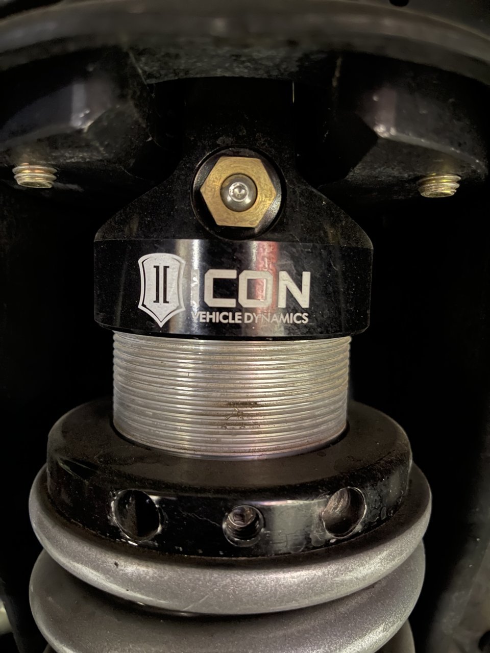

    First picture is driver side 1 3/8” threads showing bottom is passenger side 1” threads showing

    The only reason the driver side is a little higher is cause of the taco lean it’s caused by the gas tank and the driver seat being on the driver side and it actually makes the truck lean left

    Yes that is true lowering the shock collar farther would make angles a little more steep

    Does it look fine how it is right now? As far as the preload?

    Yes it does look fine
