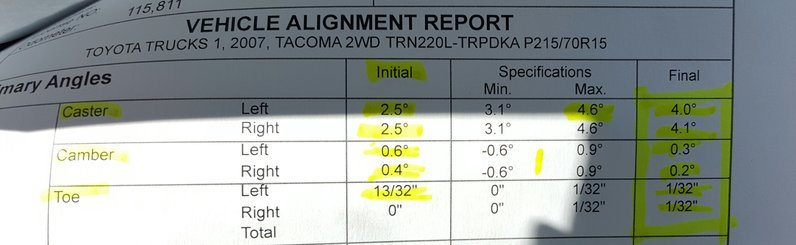

    20170401_220454.jpg Don't know if this will help you but, this was my allignment numbers after a 2" lift.
    Random: the tire size on the paper isn't correct. My truck has 30x9.5x15.
