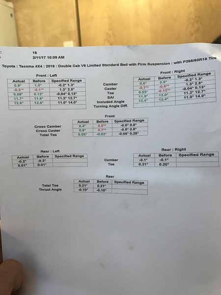

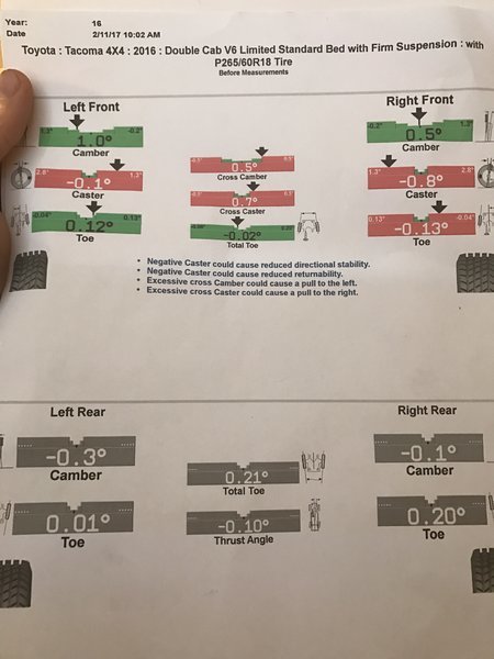

    After a lift I had an alignment shop try 3 times to get it right. How do these specs look?IMG_3046.jpg IMG_3047.jpg

    Caster 'looks' way off...
    With too little caster and higher speeds, it will feel like it's wandering and loose; having to make constant adjustments.
    Through a turn, the wheel doesn't want to return to center.
    Are you leveled?
    Did they use the Hunter Quick Check? That might affect what the machine is reading.
    ZachMX likes this.

    Way off all over the place. Go to a specialty shop that knows how to align lifted vehicles. Do not go to tires shops, dealerships, etc.
    I had mine (2" lift front, 4" lift rear, but rear doesn't really matter much) aligned by such a shop just a few days ago:
    Front:
    - Caster (L/R): 3.65, 3.89
    - Camber (L/R): 0.11, 0.12
    - Toe (L/R): 1/32", 1/32"
    Rear:
    - Camber (L/R): -0.4, -0.23
    - Toe (L/R): 1/8", 1/32"
    - Thrust angle: -0.10
    supralee, Pportera and su.b.rat like this.

    Upper control arms wont fix that, something is out to lunch, should have above 1.5 degrees of caster. Higher the better with trucks.
    The camber is high as well, this usually happens with leveling kits without upper arms. Closer to 0 is ideal.
    The caster is unacceptable and needs to be fixed. I'd suggest a Toyota shop or dealership that understands the trucks. I wish I could do it for you.
