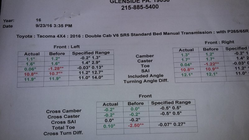

    Do you have a pic of your printout from the dealer? I'm convinced mine is fucked up.

    Here is a picture of mine. Bilsteins all around highest notch in front. Not sure what the red means for right front caster, maybe that they're idiots?

    You say you don't "need" uca for this lift.....yet the alignment sheet says otherwise....horrible alignment. Even the toe is half assed

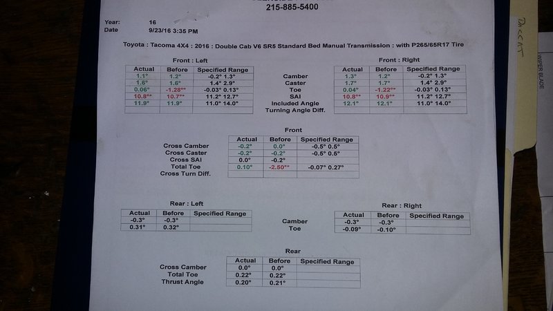

    20170411_181704.jpg 20170411_181648.jpg I do... here ya go.... lemme know if you can read it. I had my lift installed then drove it to my dealer the next day.....
    Krazy4Tacos likes this.

    I'm going to print yours off and take it. Mine was only a 2inch lift by bilsteins in the front so I absolutely don't need new UCAS. But I know the dealership here sucks ass.

    That's horrible. They didn't even adjust the caster/camber(which is absolute shit). I'd take it back and request more than the last tech "toe&go" alignment.
    Your alignment is FAR from perfect. Your tires will definitely wear faster on the outside. Your low caster causes steering wander(twitchy/sensitive steering).

    I agree...that's a terrible alignment...tires must look silly

    How's mine look haha

    I can't decide which one is worse :notsure:
    One of the things I love about the SPC arms is the amount of available adjustment. I've got mine set for maximum tire clearance with 0 camber and ~3° caster.

    So considering I got mine done at the dealership last week..I plan on taking it back to have it redone this week. What numbers should I ask for?

    You can ask for a gold plated unicorn, but you'll likely get a shit covered apple.
    Your upper control arms are limiting what numbers they can actually get for you.
    I'd ask for maximum caster with camber being not over ~.4°. It's not going to be perfect, but it will be reasonable.
