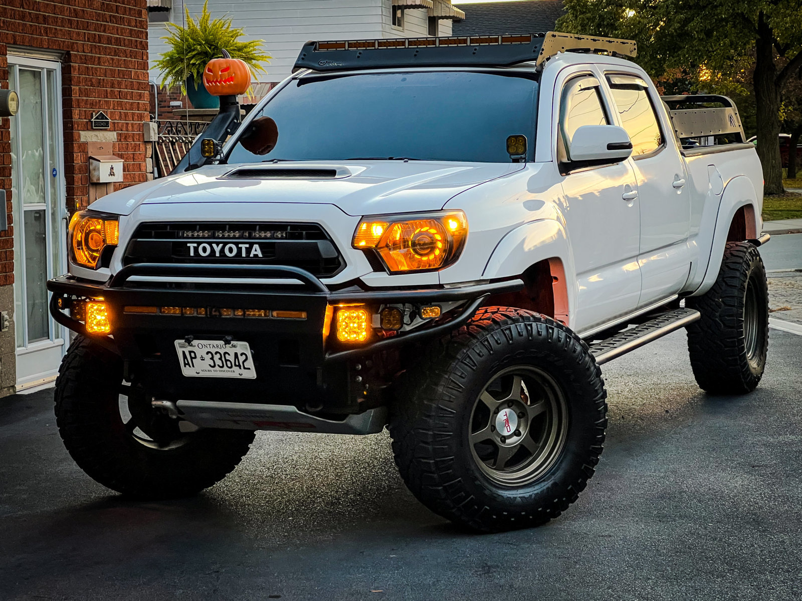

  8. Oct 26, 2023 at 2:52 PM
    TegoTaco
    TegoTaco Well-Known Member
    Sep 29, 2016
    #198555
    7,292
    Ontario, Canada
    ‘13 SUPERCHARGED DCLB TRD SPORT
    For my truck.
    - 3.5” front and about 4” in the rear
    - 1” body lift
    - SPC UCA
    - Flattened pinchweld
    - relocated cab mount
    So worth it!!!
    GHammer, Funrunner and Desert Drifter like this.
