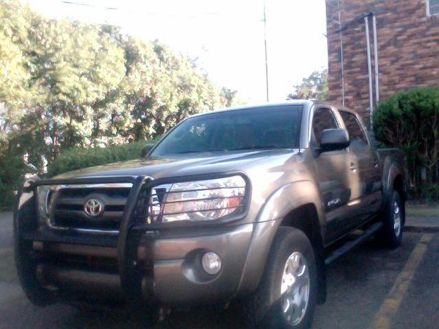

    I apologize for my ignorance, but what are 1.25'' spacers? Also, The OME coils seem feasible for me, but what are the add a leafs, and the benefits? You guys both have good looking trucks too. I included a pic of my truck so maybe that will help.

    The 1.25" spacers that he mentioned are wheel spacers that push your tires further out from the center of the vehicle. Add-a-leafs are one way to raise the rear of a vehicle that has leaf springs suspension. They lower the rear axle by making the leaf pack thicker. Check out ToytecLifts.com if you need to see pictures of the parts themselves.
