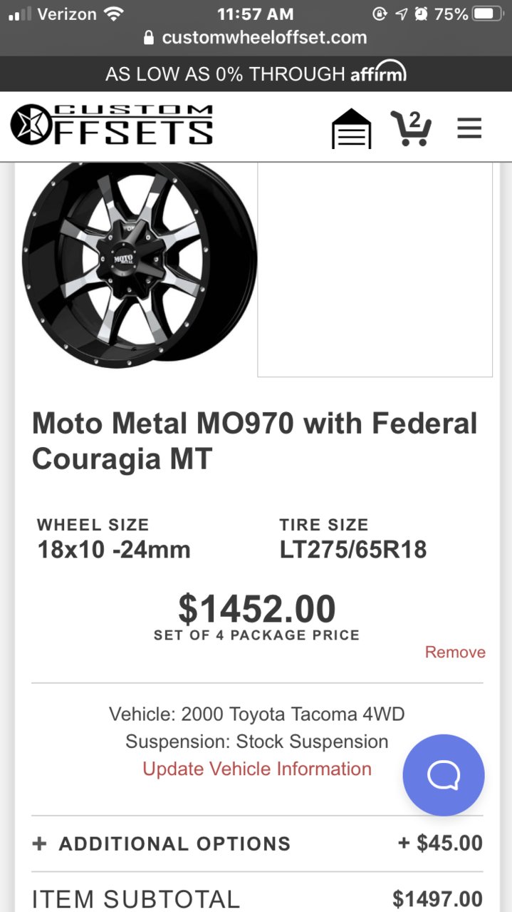

    851DC84E-CC4B-4810-A87B-FD9FE326C0B1.jpg 2AB77348-3BAA-4900-BC84-24D875864C96.jpg I’m trying to figure out what to do about my wheels and tires. The truck has no lift. Just wondering if I can fit a 275/65/18 with no lift. It’s basically a 32.4x10.8. Trying to do it without a lift but if I am gonna have to get a lift then I’m gonna do a 285. If it would rub just a little at full turn then I’m not gonna complain. Just as long as it’s not gonna rip my fender off. Thank you

    So, the answer to this question is sort-of always the same, but of course varies a bit for everyone because of wheel choice, actual ride height, etc.
    You'd be good to go read this post, which explains everything you need to take into account when you're looking at different tire sizes for a 1st gen Tacoma (or any other vehicle). What size tires fit my lifted Tacoma? Oh, and it doesn't matter if you have lift - as you'll see at the beginning of the article. So if you're trying to decide between 275 and 285 based on whether you have lift, it's irrelevant, since the travel of the suspension is the same, regardless.
    Things to keep in mind are going to be outer diameter (of course), but also backspacing. At 18x10 with -24mm offset, you're looking at just about stock backspacing (assuming you don't have any wheel spacers), which is 4.5" so that will help to reduce rubbing. At 32.4" (275 size tire), you're right at the edge of what can fit in the front wheel wells with minimal rubbing. So, you're 50-50 on having to do something like the Pinch Weld Mod. To put it in perspective, with a 32" tire, you're 90% likely to fit without any mods. With a 33" equivalent tire, you're 90% likely to have to do the pinch weld mod.
    Again, it's going to depend on your specific situation. Since it seems like you're planning to purchase new wheels and tires, my recommendation would be to keep your old set around for a while. If you find the rubbing is too bad for even daily driving, reinstall the old set until you have time to hammer the pinch weld a bit.
