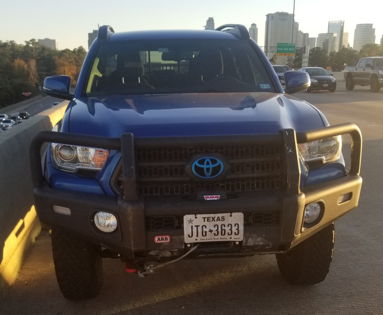

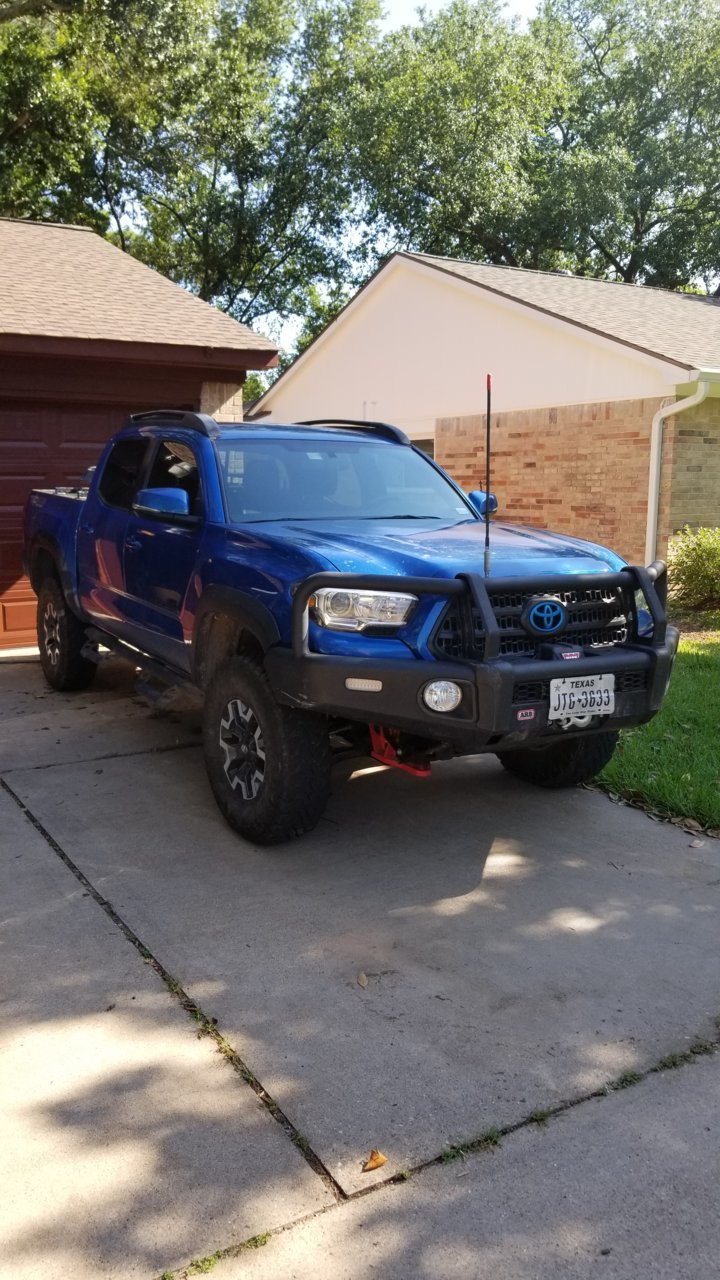

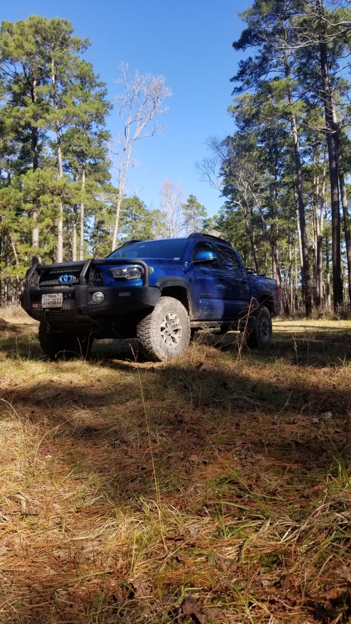

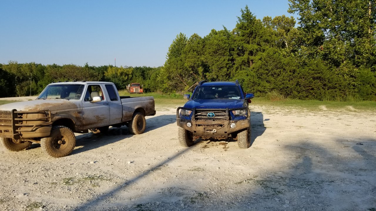

    Unlike other trucks I have had, lifting does not substantially improve the Tacoma's ability to clear wider tires. This is due to its design. That said, I am partial to the 255/85R16 (255/80R17) tires on stock wheels. They fit with no rubbing when I had no lift, and continue to do so after a 2" lift. Given that you are considering the 33x12.5 you would likely find the 255/85 (33x10) a bit narrow. The Toyo MTs 255/85R16 measure 33.5x10.25 so only marginally narrower than stock (0.25") and definitely taller. But, they are an option that are easy plug and play on stock wheels if you want a larger tire and buy yourself time to accumulate the necessary parts/upgrades/skill set to fit a wider tire.

    Could we get a front end image of your truck with the 255 tires?

    Wesintex
    Wesintex Well-Known Member
    Feb 1, 2018
    #243158
    183
    2017 Blazing Blue Tacoma TRD OR
    255/85R16 Toyo Open Country MT, Customish bed rack, CB radio
