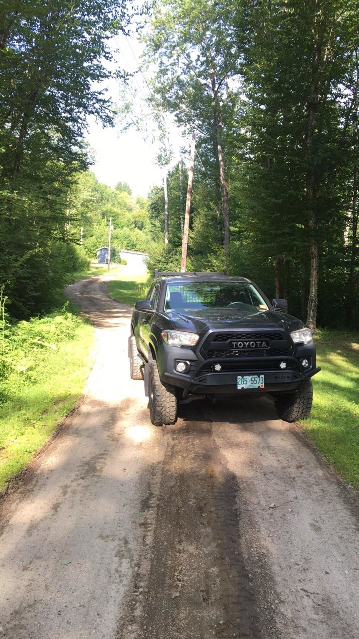

    Im on stock gears still..and lifted. Also have bumpers, sliders, skidplates for added weight.
    yes it will hurt the power and performance. You need to be prepared for that.
    K&N cold air intake, magnaflow catback exhaust, and a cheap throttle controller helped to regain some of the pep i had lost.
    my truck is not a daily driver anymore either, more of a toy now. I have a car for the daily drive.
