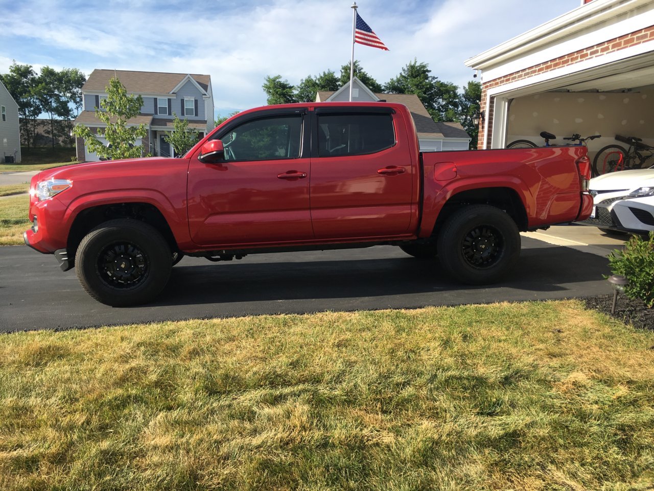

    2018 Tacoma SR
    So I’m wanting to get some bigger all terrains but I’m not sure what to go with. I have 2 thoughts: 1. A 2” spacer lift in front 1” block in back with 265/75-16’s or 2. Adjustable Bilstein 5100’s on the front, leave the rear stock with the 265/75-16’s. But I already have the pro comp series 01 wheels installed which have an offset of 0 and a backspacing of 4.5. Will either of these options work with these wheels?

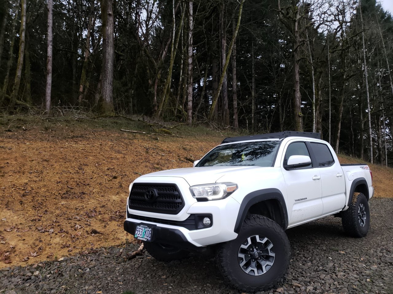

    Darian
    17' Taco. TRD OR
    3" Eibach lift, JBA high caster upper control arms, 2" ToyTec add-a-leaf
    I am running a 3" front, 2" rear spacer lift. I see both sides. Yes, 40K truck. A spacer lift would be the cheap route. I want to get a "real lift", however, I cant justify spending $3K+ on one when I dont plan on bouncing my $40K truck off of stuff big enough to need a "real lift". Down the road, maybe in a year or two I'll upgrade but thos is fine for now.
    I run 285/75/16's with a 1½" wheel spacer. No rubbing either.
