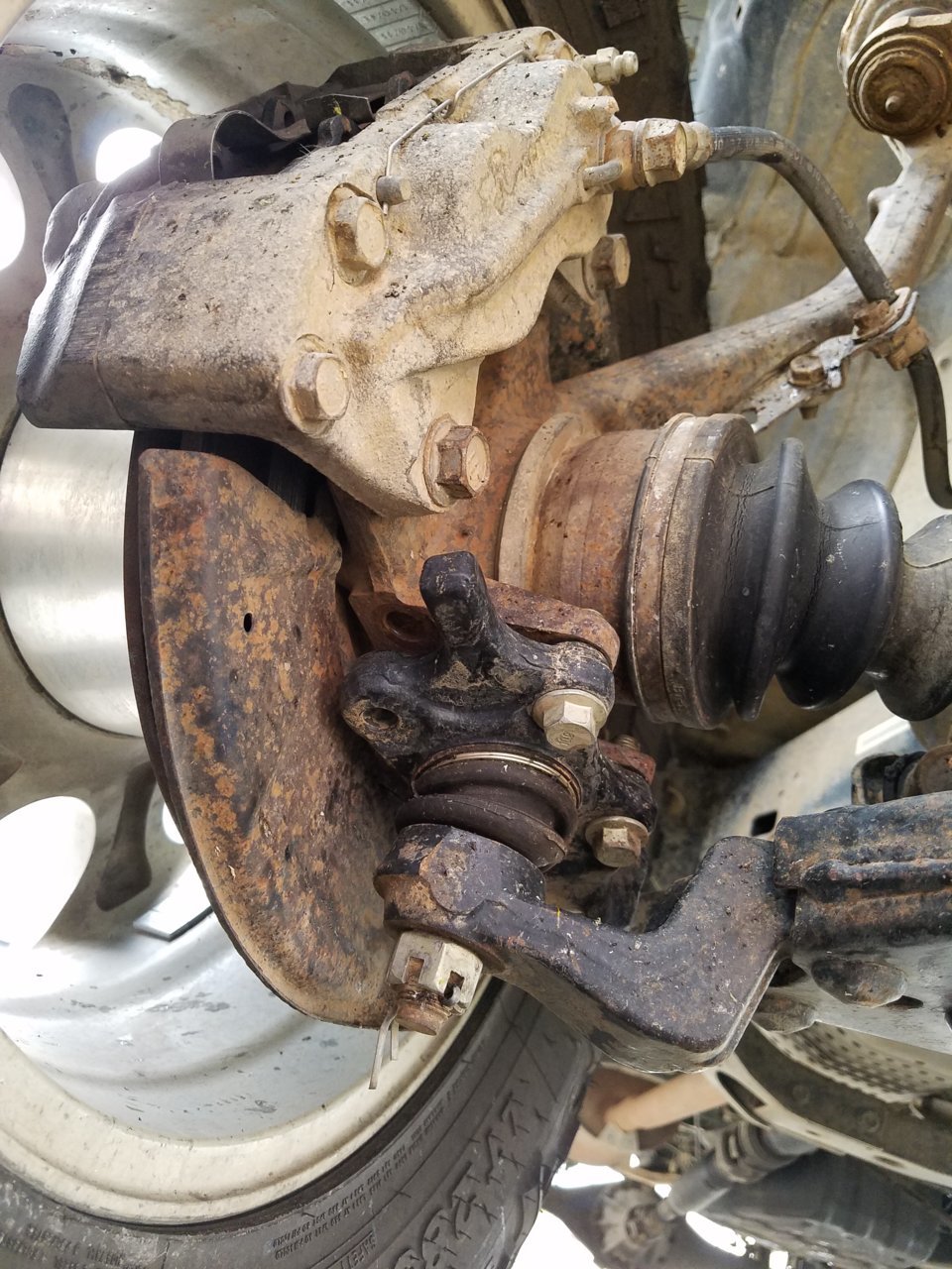

    Okay so there is a few things I need to get done on the Badger and need some guidance. First a lift because in currently running 285/70/17 and it has a level on it but my tires still rub body at full turn (the outside of the tire rubs the body about where your feet are inside). Side note it has stock FJ Cruiser PN#4261135410 and 3" bolt on spacers (not ideal I know but well its a budget type build).
    Ideas so far are
    1. Long arm it and uniball the UCM with and AAL in the rear.
    2. 3-4" lift kit
    I do know i need rims with a different offset to help with my problem and probably have to hack at the body to help articulation. I am obviously new to all of this been following some build here for a while and a bit overwhelmed.
    (way off track but have to ask, anyone know how to get sheared bolts out of a steering knuckle where LBJ connects to Steering knuckle20180813_150806.jpgAll it has is the block right now 20171005_144444.jpg These are the spacers as well. (ignore the fact that discount tire broke off to lugs on my spacer as well)
    Again I am a mess and so in my truck but that is what we sign up for with making rigs from start to finish so all help is welcome and if you have a better idea please shoot. Thank you!

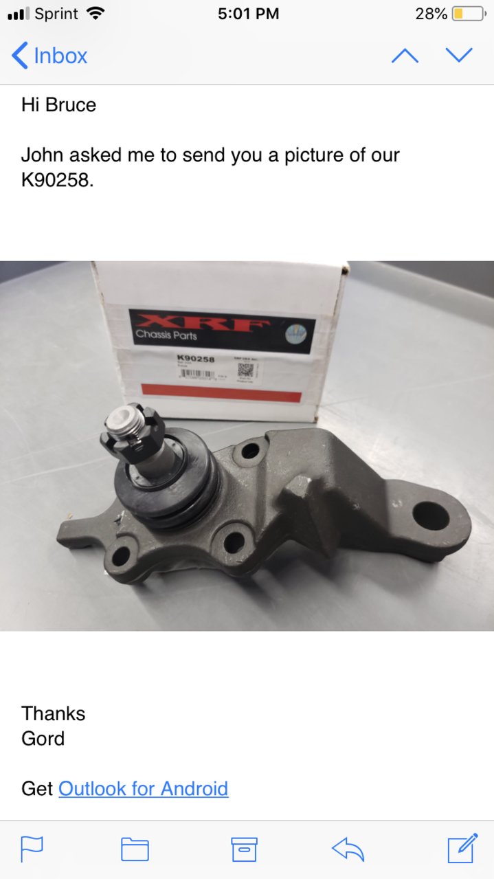

    What the hell happened lmao. If I was in that position I would heat those bolts up with a torch and put a jack under it and slowly try to level it out back in place and let them bolts cool down then remove them. Hopefully they won't break so I would be very careful. And what part number are you referring to about that mentions a FJ Cruiser. The wheels??
    I would definitely look into some aftermarket UCA's though because once you go over 3" of lift in the front you won't ever be able to get the tires aligned right and is gonna put extra stress on them poor lower ball joints. I know from previous experience in a 4Runner (same design).
    Check out these lower ball joints I ordered from XRF chassis yesterday they were only 60$ or so a piece and come with a lifetime warranty. Seem to be high quality and definitely beats 150$ OEM ones with no warranty. That part number (k90258) is for my 99 Tacoma. Also picked up their inner and outer tie rods for only 40$ a piece, also lifetime warranty.

    You definitely need a new lbj, possibility spindle depending if any damage was done.

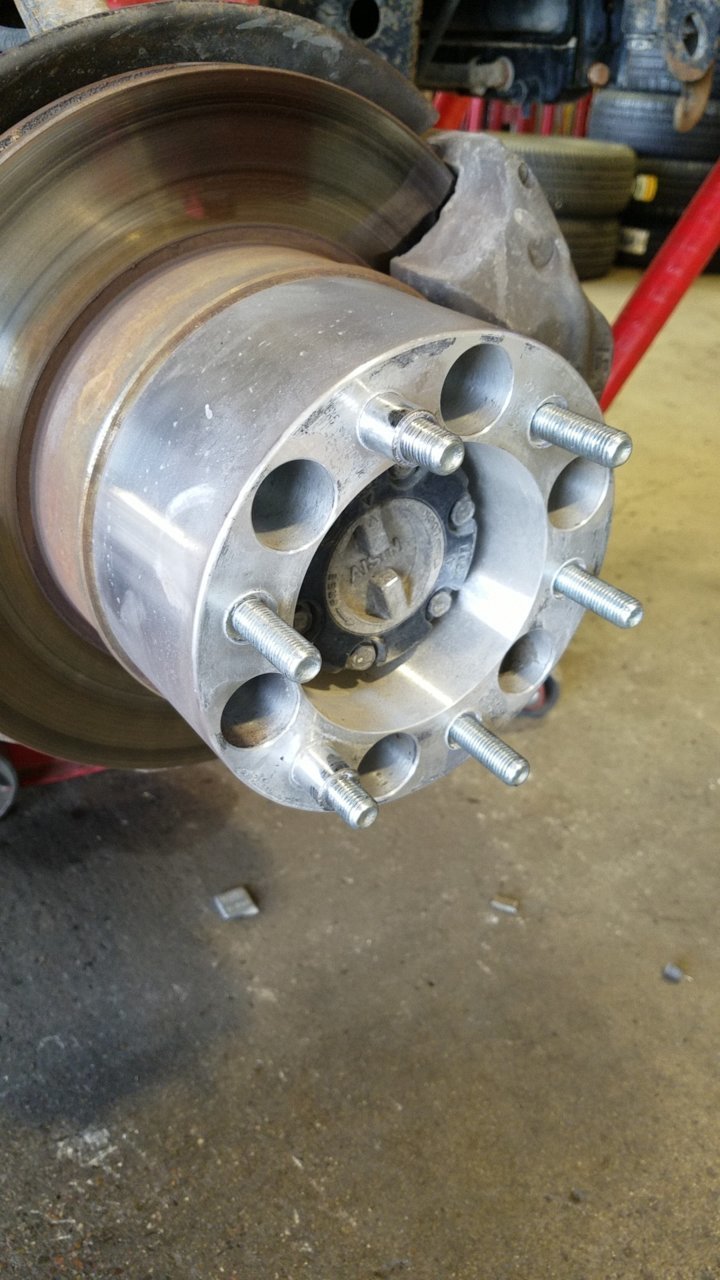

    As for rubbing those giant spacers might be causing issues. I dont see why you need 3” to fix stock fj rims. Maybe 1” at most.

    And the spacers were needed because the rims had a positive offset and I had rubbing on the UCA without them. And Ill have to take pictures for you on where/how it rubs to give you a better idea.

    So story of how it happened I was in the middle of driving from NM to ND for changing my duty station and somewhere in SD there are extreme pot holes and I guess when I hit one it broke. I didnt notice and kept driving on it and noticed a funny noise when turning and couldnt figure out why, but I had no service nor could I figure out the problem I was having. None the less I kept pushing and drive all the way to ND and around Minot I finally realized what broke and was very lucky that those last 2 bolts did not give way because if they did...I can only imagine what would have happened. Then after attempting to fix it I got on bolt out and the other bent bolt is stuck in the LBJ. So in total 1 bolt is broken off in the steering knuckle 1 in stuck in the LBJ one is lost somewhere in SD and I got all the was out no problem.

    And yea, you need to fix that ball join issue ASAP. You should do both sides at the same time.

    you might have to cut the head off the bolt, pull the LBJ off and then drill or clamp on some channel locks to back out the bent bolt.

    I'd ditch the spacer lift and the wheel spacers (are those 2" spacers?! yikes). With a 3" lift, you should be able to run those 285s, but you'll still need to do some hammering and trimming of the fender well (look up the "pinch weld mod"). If you went with a 255/85r16, the so called pizza cutter, those are better for most off road situations anyway, and because they are narrower, you don't get the rubbing issues that the fatties give you.
