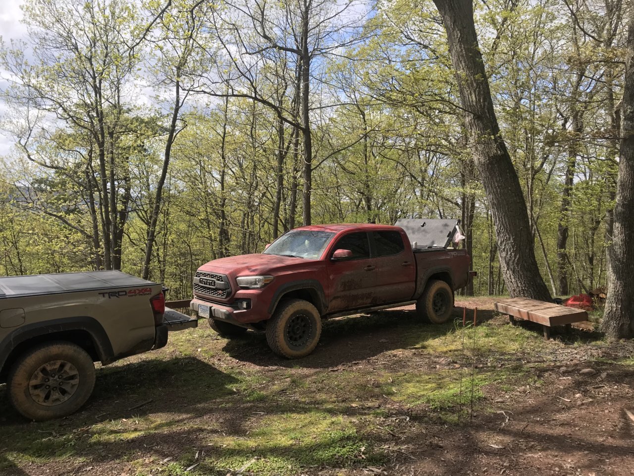

  9. Jul 27, 2020 at 7:24 AM
    RedDeadTaco
    RedDeadTaco The Hipster Woodsman
    Nov 24, 2016
    #203211
    1,326
    Andrew
    Aiken, SC
    '16 Barcelona Red OR
    Mobtown Sliders, Aluminum Skids Bilstein 6112/Extended 5100’s Iron Man constant load leafs JBA High Caster UCA’s Diamond Back Tonneau 285/75/r16 Cooper STT Pros Method 702’s Uptop Overland Alpha Roof Rack
    I’m biased since I’m running 6112/5160’s but they ride great and perform well offroad. Your not going to get a 3 inch lift which I think is why some people are not about them. Best bang for your buck in my opinion
