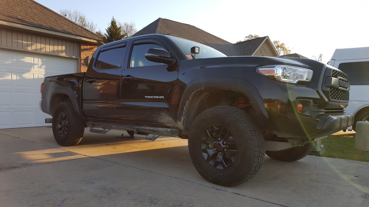

    These 2015 TRD kits were cleared out at 600 there is like a 100 page thread on them people putring them on 3ed gens I was one of the few that snagged one before time was up. It yielded about 2 inch up front some that wanted more used a 1/4 To 1/2 spacer on top to get 2.5 to 3 inch. So 900 is not unreasonable for someone that ended up going a diffeent rout and want to flip them for profit
