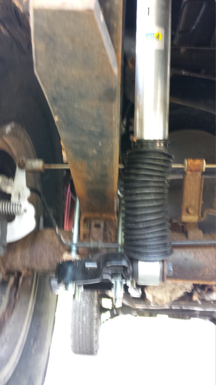

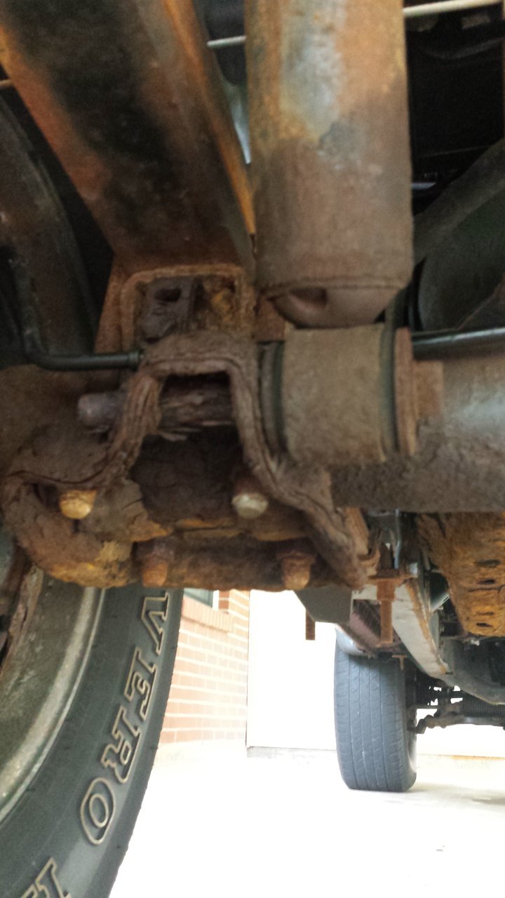

    Hello everyone! I am new to TW but I used a lot of information I have found on here to complete my lift of my 2002 Tacoma. My truck came from New England, so aside from the replaced frame, just about everything underneath was rusted beyond all reason. I wanted to post some pictures here in case anyone else runs into the same problem I did. The rear shocks connect from the frame to the Spring Assembly Seat (Toyota Part Number 48046-35210). I attached a parts diagram that someone from Toyota sent to me. The parts diagram lists multiple part numbers for this item, but they have since moved to one universal seat using the previously mentioned part number. I hope this is helpful and I really appreciate all of the help this community has given me with this project.
